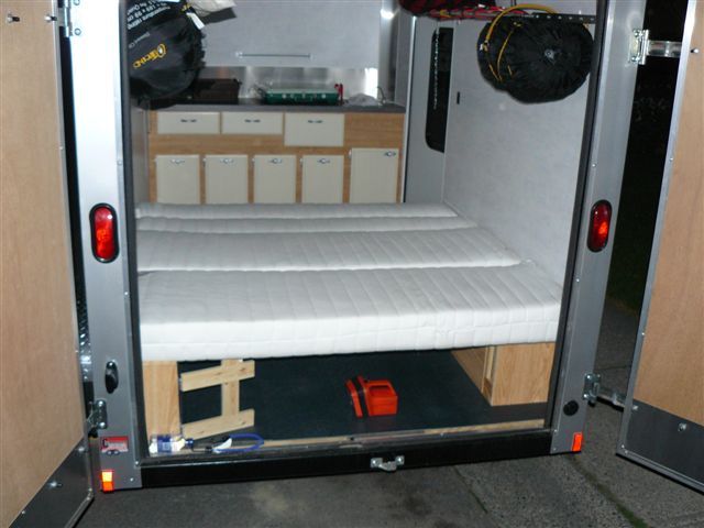

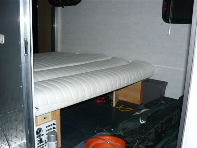

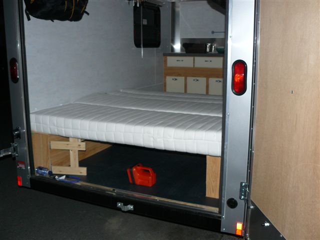

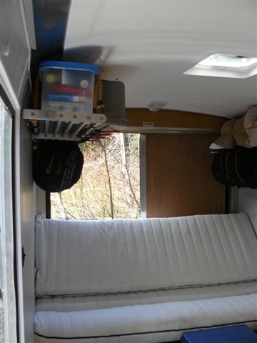

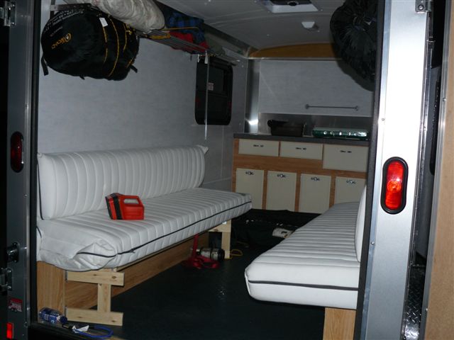

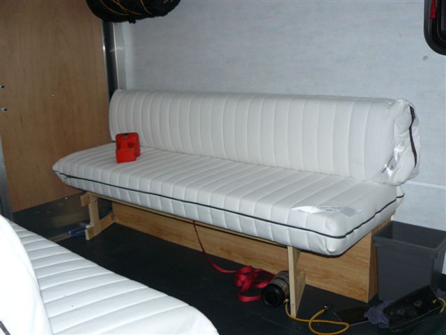

I did rethink the mattress inside I will take pics and post, I used two IKEA mattress’s 4" thick cut them into two pieces one a seat base the other a back rest. I made them so that the there length was the same as the trailer is wide so that they fit across the trailer resting from base to base. This allowed me to put them all across and make the bed from the back door to the side door. Lucky I’m short as the bed is only 70" long as I didn’t want the bed to go past the side door opening. I missed one thing I backed the mattress with 3/4 " plywood to give it its strength.
This setup allows me to make the bed or make two opposing long bench's or as a couch across the back. the 4" foam was the max I could use as I want to fold these cushions up on the sides and allow my ATV to still fit inside. now that I have explained it ,I think, a pic is worth a thousand words will post pics tomorrow.

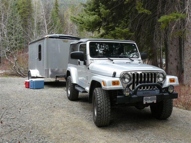

The jeep has the 4L 6 in it but anywhere from here in Vancouver BC is uphill into the Rockies. and the trailer is about 1800lbs with everything in it Not that it could not pull it but the turbo diesels were crawlin up my butt climbing the single lane hills. I have 32" tires on it now but I think I will go to 31" soon, hopefilly this will make a little differance to my pulling power.
