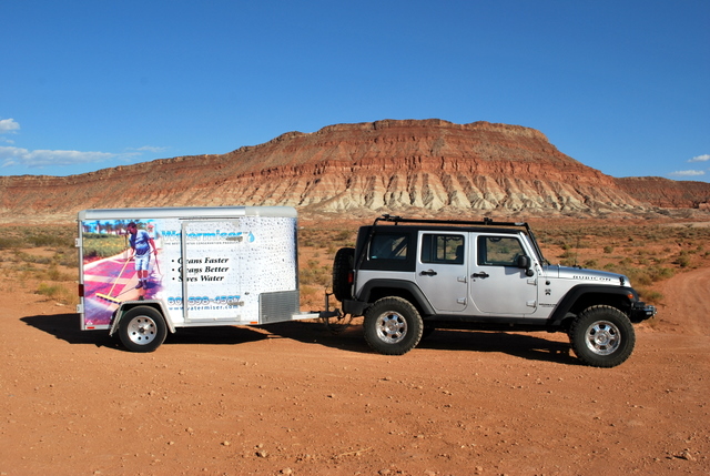

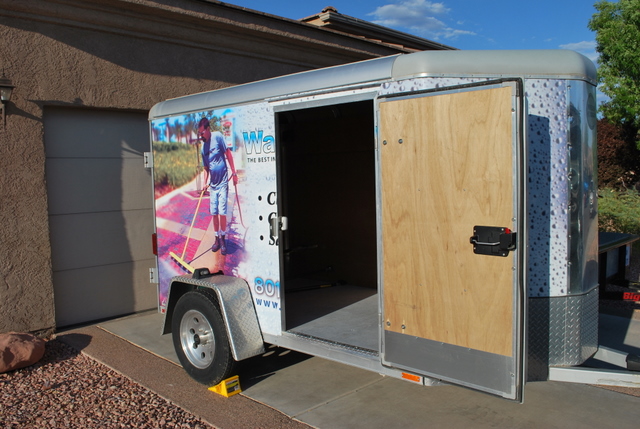

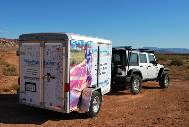

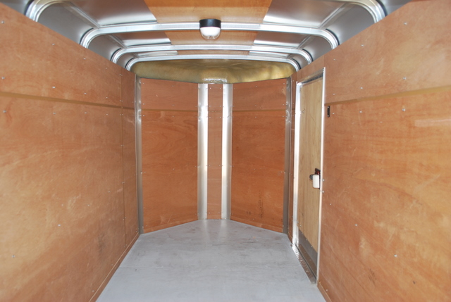

Here are some pics (thanks for the album hint):
Curbside, with the Jeep tow vehicle... gotta lift that trailer soon!
Driver side
Rear oblique with Jeep
Side door is an RV style with an inside latch
Interior is pristine... needs a bed, windows, desk, storage, vent... :thinking:

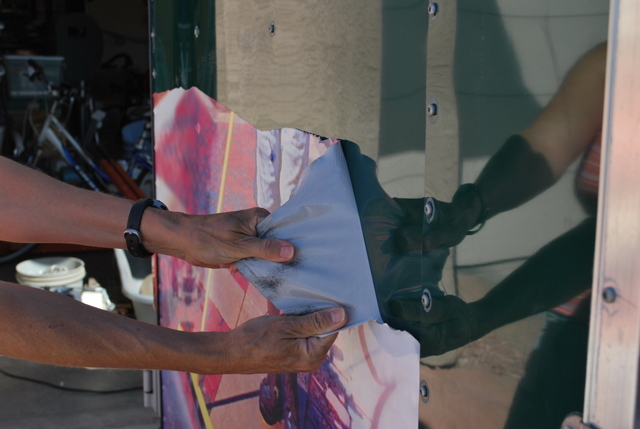

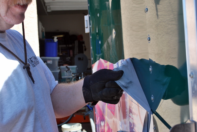

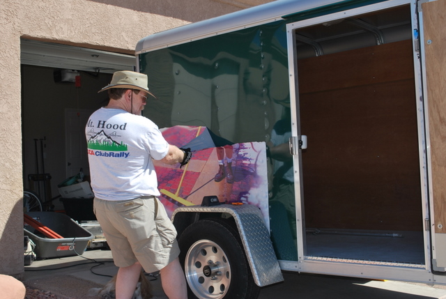

Today was the day to start the build. Step one is the removal of the vinyl wrap. As lovely as the advertisement for Water Miser is, I just don't want to be a rolling billboard. I prefer the stealthy nature of a cargo trailer conversion.
I was anxious to see how well the vinyl peels off. My cousin (Bret) who is in the vinyl supplies and equipement business told me it could be anywhere from fairly easy to incredibly difficult, depending on several factors. So, I started out this morning peeling away the vinyl.
After a few minutes of grunting and groaning, my wife and I found it was not too bad pulling off the vinyl if you do it in about 5 inch strips. After pulling the vinyl away from an edge a few inches, I would make a small scissor cut in the edge of the vinyl
Then, you pull the vinyl at a 45 degree angle downward, tearing the vinyl as you pull across the trailer. Here is my wife (Willa) working on a strip
Sometimes when the adhesive was really strong I would have to put all my body into pulling the vinyl.
I found it is important to pull smooth and steady to avoid overstretching the vinyl and also to allow the vinyl to lift as much of the adhesive from the trailer's paint.

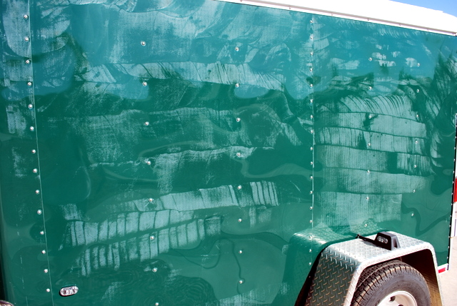

When we finished peeling all the vinyl off, there was quite a bit of vinyl adhesive remaining on the driver side
Fortunately, my cousin Bret sent me a quart of adhesive remover used by vinyl sign shops.
I found that the adhesive remover works better than all the other solvents I have tried over the years (WD40, Denatured Alcohol, Turpentine, Laquer Thinner, Goo-B-Gone, Mineral Oil) It is also water soluble, making it not bad to work with. Following the instructions on the label seemed to be the best results with the least work.
So now we are ready to start building the bed. Stay tuned! :thumbsup:

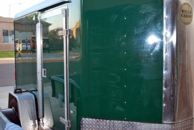

Postby devigata » Tue Sep 22, 2009 4:32 am
Sweet!!! Did you know it was green before stripping off the wrap?
