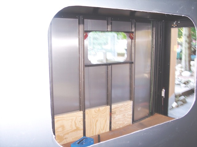

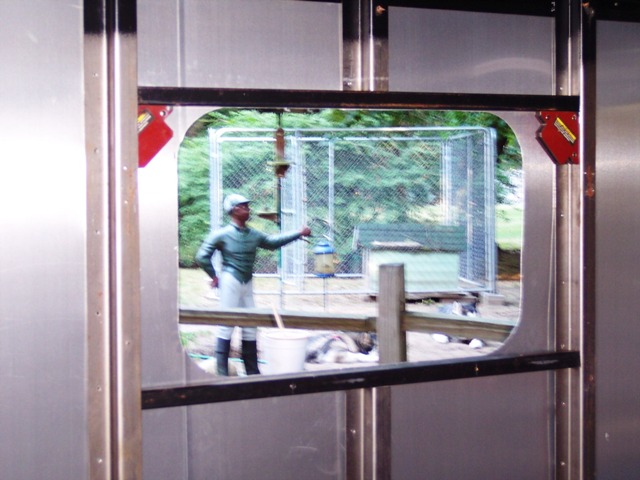

I used an air powered cut off wheel to cut the aluminum siding when I put my windows in and it worked great. I also used a 4 1/2 inch angle grinder with a cut off wheel to cut the support stud with no movement of the wall support. To cut the interior luan I reinstalled the interior paneling and traced the outline of the window from the outside to the backside of luan then removed it to make my cuts.
My dad and I also built up between the walls on both ends of the windows for support.

meach4x4 wrote:I am going to change my approach to match what you did. I notice you used steel frame above and below the window cutout. Did you weld it in? Or, use screws?
I have the Z studs in my walls and the 1x1" O.D steel tubing fit just right. I did weld it in but brackets could be made to do the same thing. I removed the outer screws and shimmed the siding before I welded.
