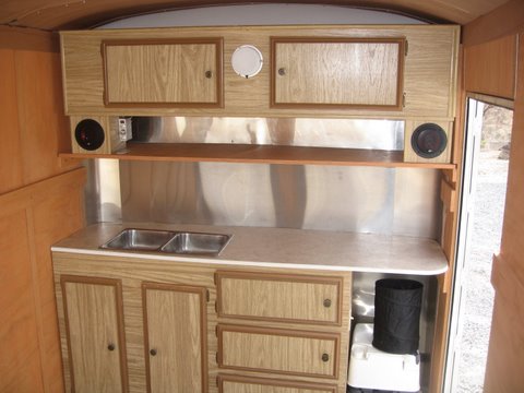

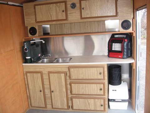

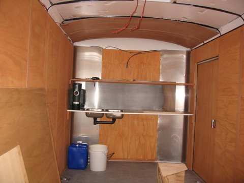

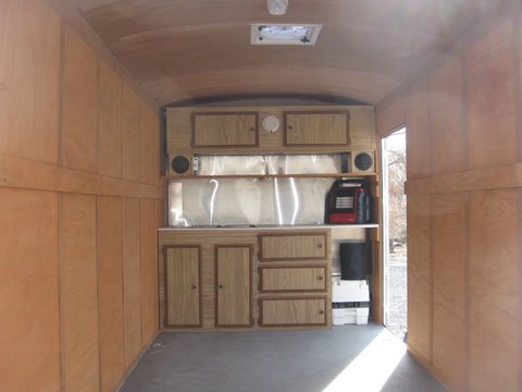

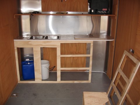

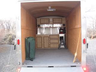

Counter in place with sink; testing the Colman Hot Water and starting Cabinet design.
Cab frame work under construction.
Cabs 90% This pic show the big Buddy Heater and both plumbing units.

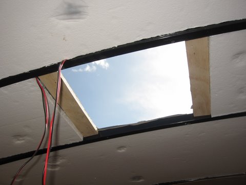

Preparing for AC unit.

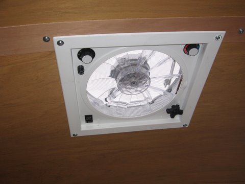

AC....errr fantastic fan I mean

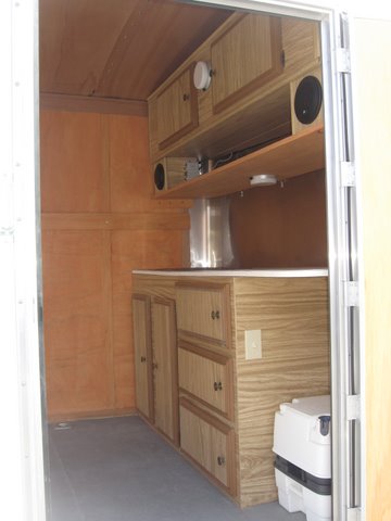

Cabs Luan ceiling Stereo and Electric complete
Counter Top is lino remnant I got for $30; If we cut it there is plenty left to make another.
Elec. Master Switch in reach of door (can leave light(s) switched and turn on with master).

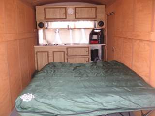

Air Bed Frame in case
Air Bed Frame set up with Queen Air-bed inside. Can set lengthwise (as shown) or across....will have to see which way we want it. It only takes a couple mins to set up with the self-inflating air-bed.
That's all for now folks! Still a lot left to do......

It only uses the heater/gas if you use hot water and even then the only time you can smell it a very little is on ignition. We do crack one window and the top vent for it as well as when we use the big buddy heater...the on-demand uses very little gas as only runs when you are using hot water. We just replaced the first propane bottle on it and the wife uses a LOT of hot water(lasted for 3-1 week camping trips). We have used the shower attachment a lot for rinsing dishes but only a few times for showers. Do not expect a lot of pressure for showers but it puts out nice hot water and stays hot as long as you want to shower. Being portable we just take it outside for showers...we usually have no neighbors but if we do we throw up a privacy tarp btw the Cargo and the Landcruiser.
The beauty of the setup is NO PLUMBING to winterize or maintain!! We have 2-7 gallon walmart blue containers under the sink that we exchange when one is empty and a gray water container under the Cargo that we run a hose to thru a hole in the floor.
The potty is a port-a-potty which lasts a week when using for #2 only.
