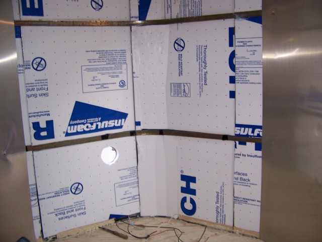

I insulated the front V nose area,
I will finish the rest later I just had to get the front done so i could start my cabinet.

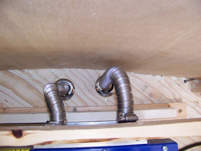

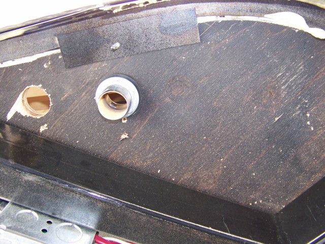

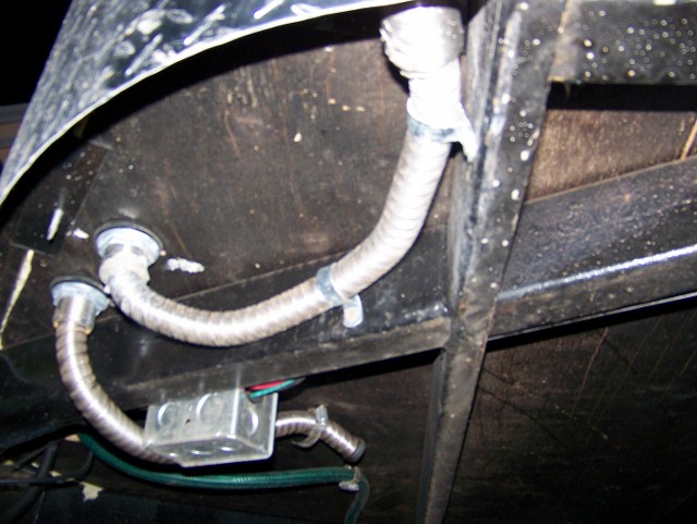

Installed the Propex heater,
This is on the drivers side front top down.
This is bottom side

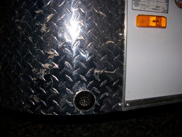

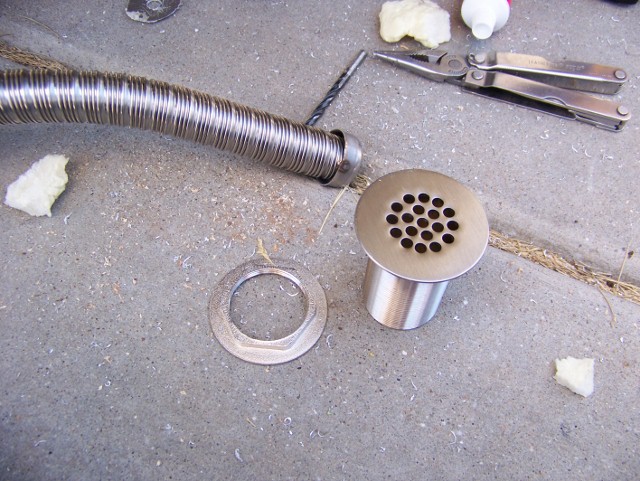

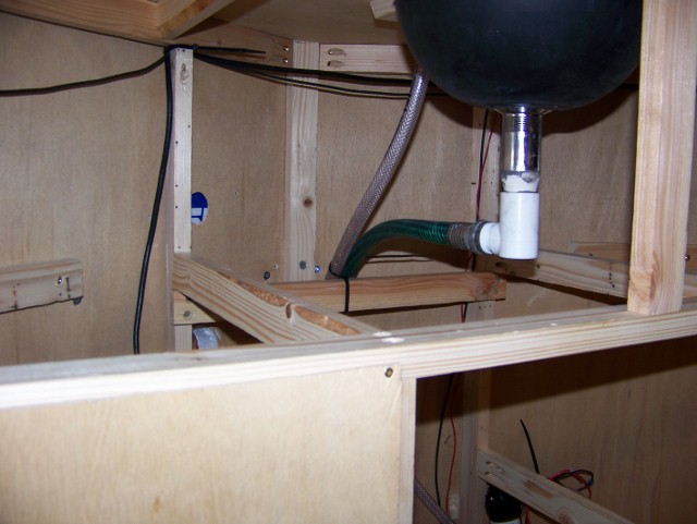

I used cheap Sink drains to go through the floor with the intake and exhaust.
I used this Stainless steal sink drain to run the exhaust through the wall below the floor. It was going to cost me over $120 to get a "Through haul adapter" from a marine place that sells the Propex stuff and this cost me $12.
