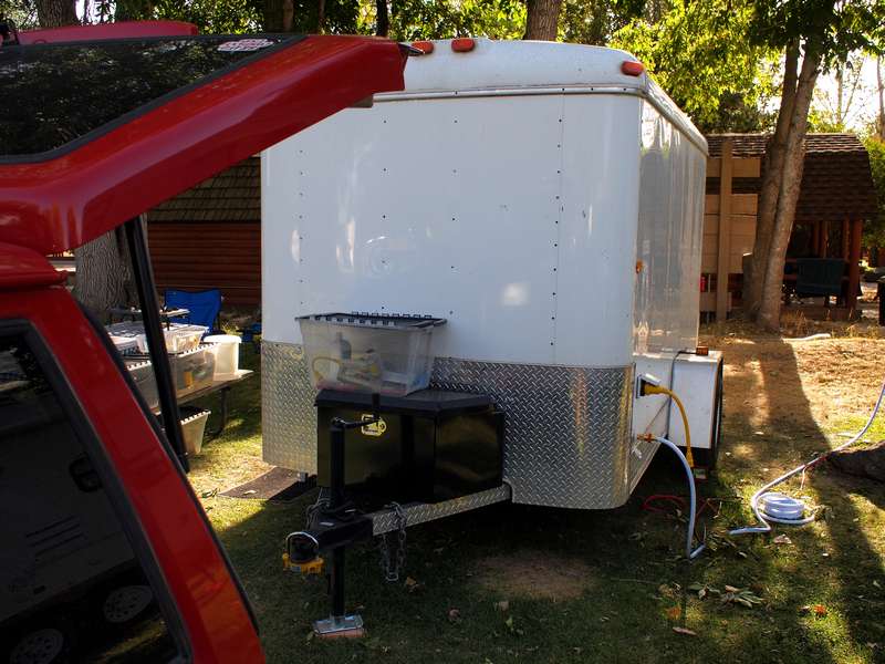

Here is a picture of my electrical hatch with the cord sticking through. The one on the right is my water hook up. Ignore the dirty trailer we just got back sunday from a trip. It was also taken at sunrise so everything is orange..
