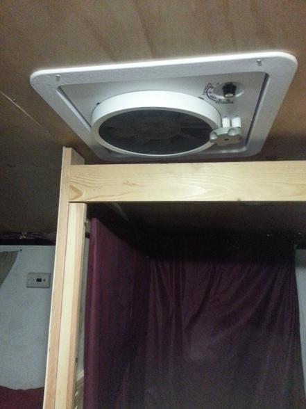

One of the updates I wanted to mention was my new fan. I had been using a computer fan, and it was great. It was very quiet and had low power usage. I was going to buy another one when I saw the Vortex II fan by Heng. It was reasonably priced, has 3 forward speeds, and 2 reverse. High is 188 CFM and uses 1.18 amps. I am not sure what low uses. Low is quiet, but not as quiet as my computer fan was. It does move a lot more air so I don't have it on for very long. I have had the fan now for almost a year, and I am really pleased with it.
As the picture shows it is mounted so that it is partially in the bathroom area.

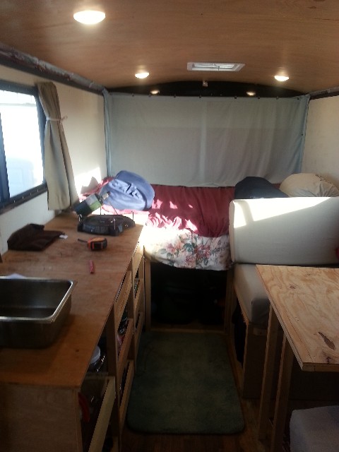

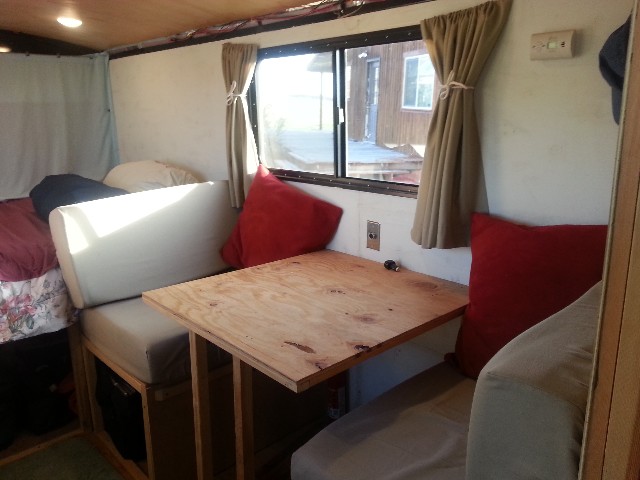

Here is a picture of the seating area. Image
The table legs fold and it comes down to make a spare bed. The covers on the cushions I made to fit like a fitted sheet. It was a fast method to get some covers on there before I went camping for the summer. I have decided that I really like them as they are so easy to remove and clean. I may eventually put more tailored ones on or I may not until they wear out. The curtains are simply strung up for now. I haven't got the rods for them yet as I am debating about making them into insulated Roman shades. The table top is not on, the doors on the seats and under the bed need to be done. The top angle to cover the wires, all the molding, and final paint over all the hole fills in the walls haven't been done yet either along with a dozen other things.

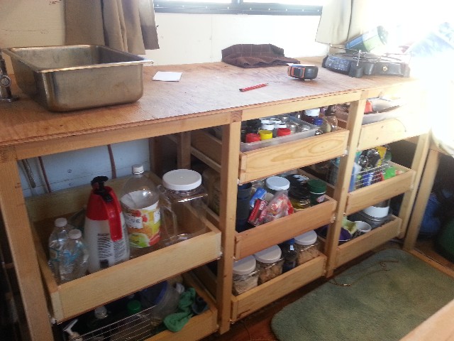

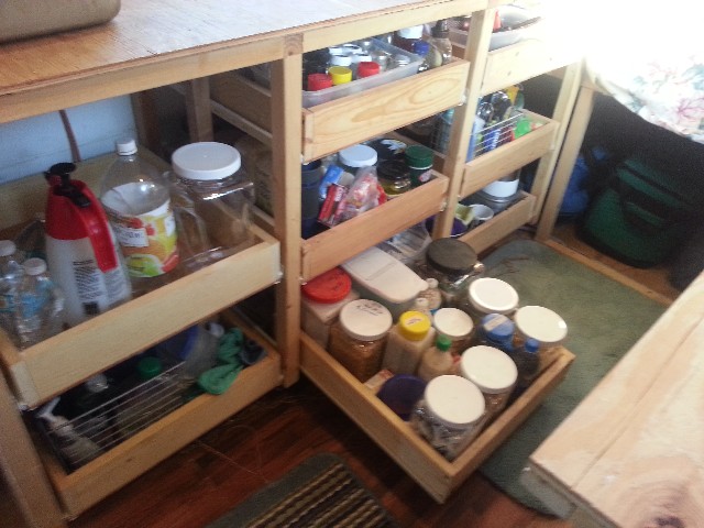

Opposite from the seating is a 6 foot long kitchen counter with drawers.
Obviously the counter top and the doors over the cabinet fronts are on the work list too. I love the drawers, but for now I have to bungee them in for traveling.

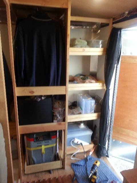

In front of the door are two floor to ceiling cabinets that house my closet, the freezer, the electrical and batteries, as well as lots of junk! They need doors and trim yet.

For anyone who is interested, I put an amp meter in line on my Heng Vortex II fan.. It uses 1.18 amps on high, .75 amps on medium, and .48 amps on low.
It isn't in the same class as a Max air or Fantastic Fan, but I don't need 900 cfm. I usually only run this on low as it is. It also doesn't have the same power consumption.
I would have stayed with using a computer fan, but mine died. This one is louder, but I am happy with it. It does the job. :)

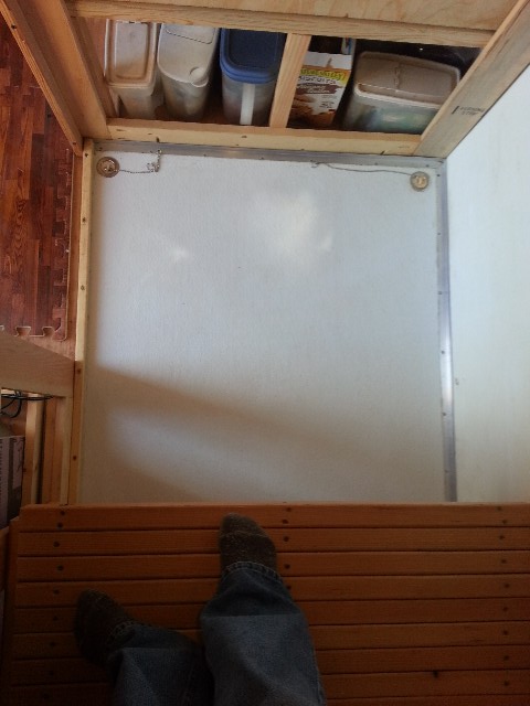

I went out and took some pictures of my shower area now. The aluminum angle along the two side is where FRP with go up those walls. When it is done the FRP will come down over the metal angle.
The whole shower/bathroom/closet access area is 36 inches wide by about 52 to 54 inches long (the front curves out). I put 3 drains in the floor to account for a sometimes unavoidable leveling problem. I usually have the CT a little off level intentionally for the shower and the head of the bed. That also makes it easy to predict to what corner my shower water will go. I use a bucket under the appropriate drain to catch the water. I shower everyday, but since I boondock exclusively, I only use a half gallon or so of water.

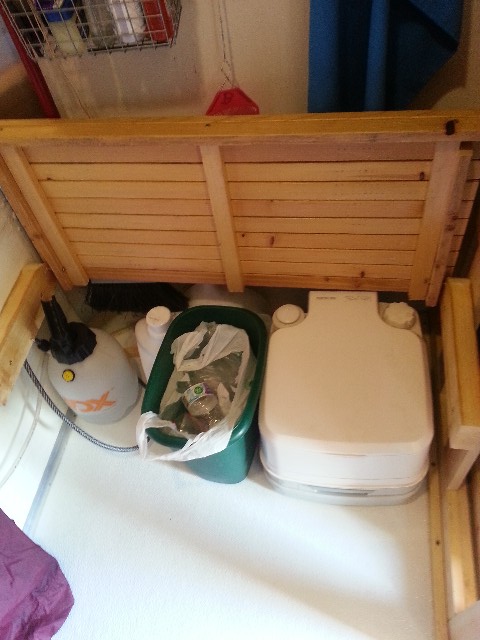

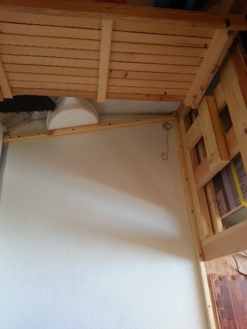

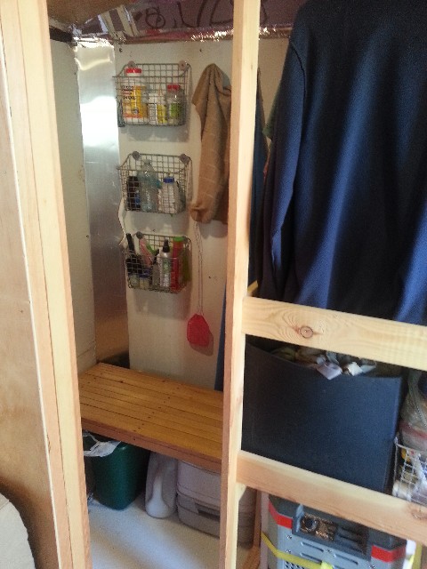

Here is a picture of the two drains towards the back. The unfinished or open wall shows my under the seat storage. For now it is behind a curtain. Soon it will be behind a wall.
This is the front shower drain. Complete with my broom and dust pan. :D The bench is usually down over a portapotty, trash, and sprayer.
I run the curtain across in front of the bench. With the bench down the shower area is about 36 X 40. And looks something like this:
The FRP holds up very well. We used the shower area daily for 4 months straight last year. It doesn't show any wear, even from our muddy boots. We like it, and it works well for us. We hopefully will be finishing it this spring. We have FRP walls, new curtain, closet doors, cabinets on the front end at the top, and a mirror/medicine cabinet in the plans.
