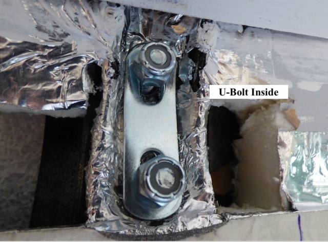

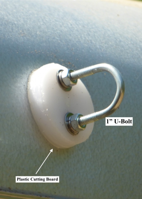

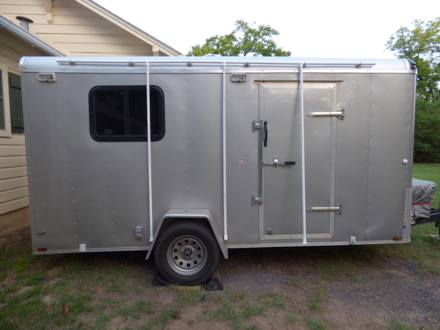

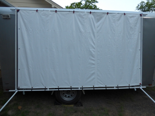

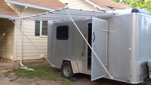

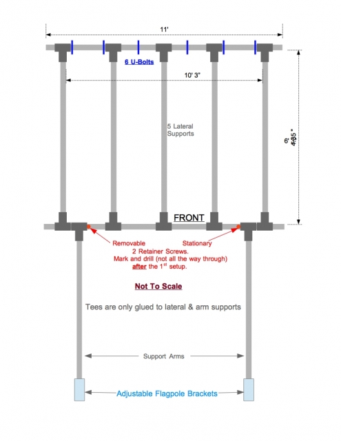

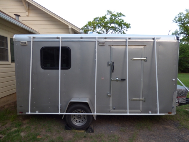

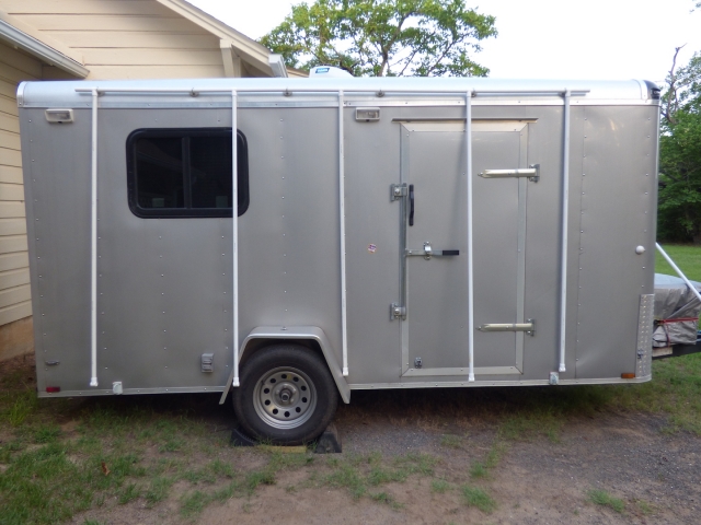

To build an awning with readily available components that can be found at any hardware store.
3/4” PVC pipe.
1/2” EMT conduit.
Plastic cutting board.
1” U-bolts, + 2 extra washer for each 1.
Duct-tape.
1” Adjustable Flagpole Bracket. https://www.homedepot.com/p/Evergreen-E ... /100650584
10’ x 12’ White Tarp (cut to 12’ x 6’). https://www.homedepot.com/p/Sigman-10-f ... /203217300
6” Tarp Ball Bungees.
Brass Grommet Fastening Kit. https://www.homedepot.com/p/General-Too ... WD14718361
3/4” PVC Slip Sling Tee. https://www.homedepot.com/p/Formufit-3- ... WD17983408
3/4” PVC Internal Dome Cap. https://www.homedepot.com/p/Formufit-3- ... WD17983408

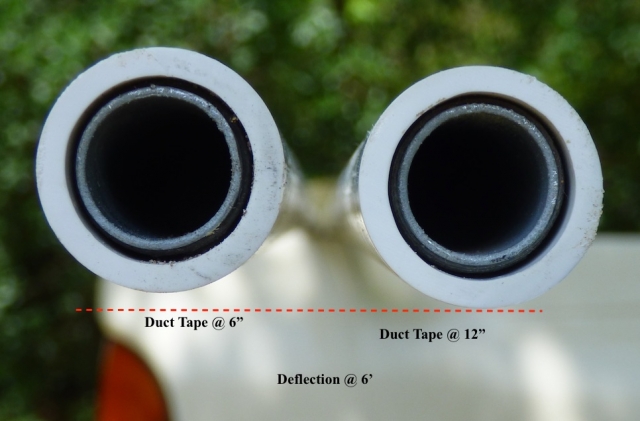

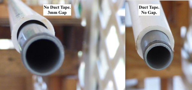

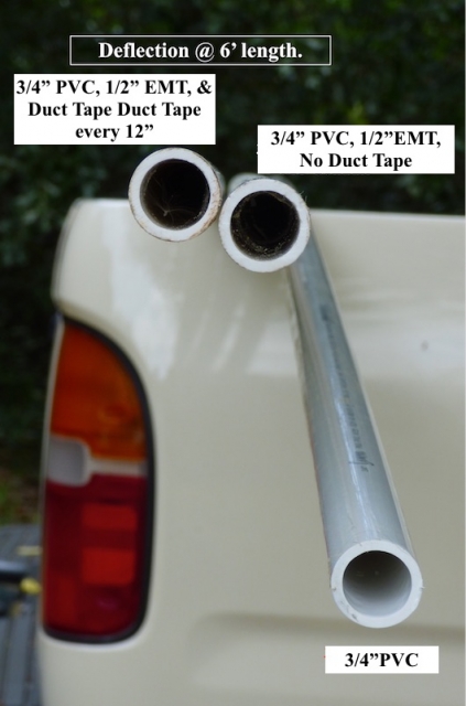

3/4" PVC alone would not have the required strength needed to build an awning.
To beef-up the PVC pipe we looped 4 layers of duct-tape at 1’ intervals over a 1/2” emt conduit, then inserted inside the 3/4” PVC pipe.

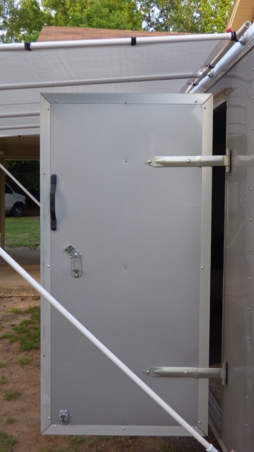

Although we have a middle leg for supporting the front, we decided that it wasn’t needed.
We tested the awning here at home during a rain storm without the middle support.
No problem with 25 MPH wind.
Drilling for the U-bolts from the inside (roof ribs), was difficult in maintaining the same angle (I should’ve made a jig). The result! The U-bolts were uneven on the outside.
