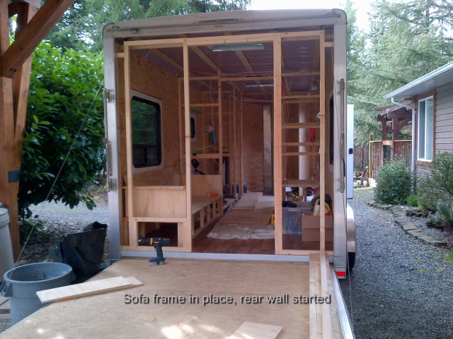

Ribs are 1" square tubing. I added 5/8 ply strips to each rib (to make thermal break), so 1" + 1/2" rigid insulation, then foil tape over all seams.

If you check my build (link below).....I ripped 1" x 5/8" ply strips and attached one to each ceiling rib. I then installed 1.5" rigid insulation between each rib. Then I strapped 3" x 5/8 ply strips down the length of the trailer - along each side, down the middle, and roughly where my interior walls were going to meet the ceiling. I used the 5/8" gap as a "chase" for my 12V electrical wiring and LED puck lights.
The finished ceiling is 1/4" plywood from Home Depot, screw holes filled with gyproc mud, and painted white. I used 1.5" wide strips of the 1/4" ply to cover any seams (mainly the one down the middle of the trailer).
BTW, the main reason for the 5/8" ply on each rib (walls and ceiling) was to create a thermal break. All the interior plywood walls and ceiling are screwed to the plywood, not the ribs. In 2+ years of use, I've never had a problem with screw heads getting wet because of cold temperatures outside/warm temperature inside.

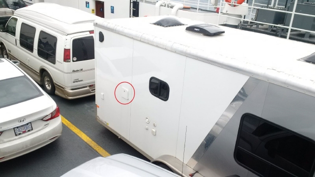

Long story short, we were in Quebec last summer, in the heat of summer. Couldn't take it any longer so I went to the local WMart and picked up a portable unit (single 5" hose). It stores in our front closet when we travel and vents out the side. I just pull it out and face it towards the rear. Cools the CT nicely even in 101F temps in Bethesda, MD later in the summer.
And yes, I knew we would eventually get a portable unit, so I put in a vent (a small opening door) in the trailer wall before we left. I've recently changed the "door" vent to a louvered vent so I don't have to remember to open the door when I want to plug in the A/C.
