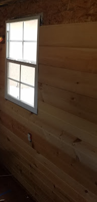

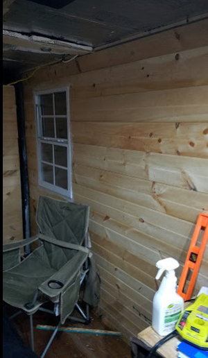

Second window in place and us putting the pine boards up.
Boards done and the second window view (at night)

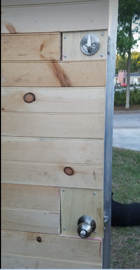

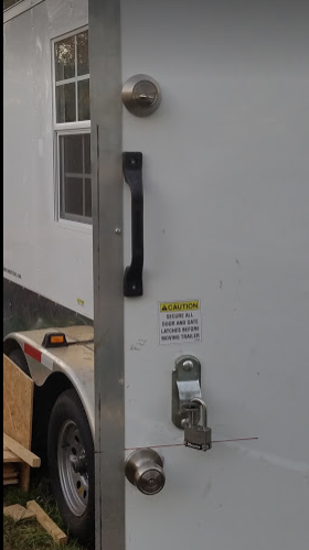

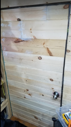

Door and first attempt at regular door knob:
Deadbolt and doorknob in place
Inside view of final deadbolt and doorknob placement

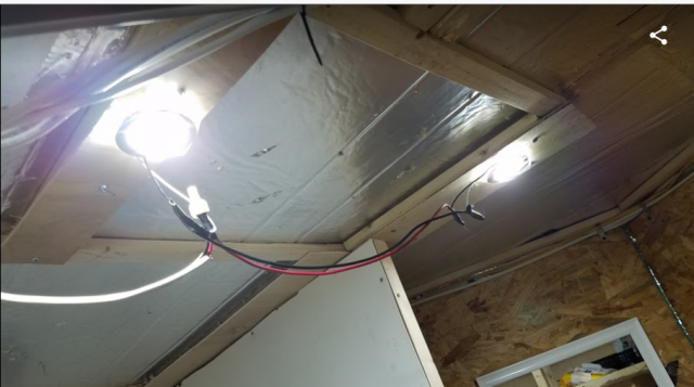

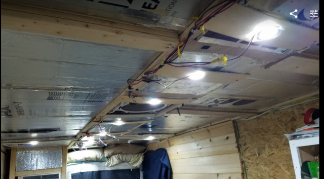

View of the recessed lights in place
So I'm leaning towards using aluminum roofing as my ceiling. I plan on putting bead board paneling behind the kitchen counter. Then the last thing to figure out is how I want to finish the bathroom.

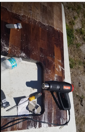

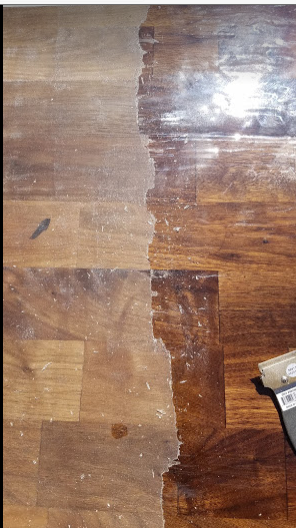

So back to my epoxy story. I bought Marine epoxy in order to use plywood in my bathroom. Once I realized this was more work that it was worth, I decided to use the epoxy for my butcher-block counter. YouTube made it look so easy, but it was not. My table wasn't level and the epoxy came out super uneven. Today I dedicated 8 hours of my life to getting that epoxy off the butcher-block and getting it ready for some Minwax polycyclic stuff that I bought.
Some razor blades and a heat gun is what I used to get the epoxy off
Here is a close-up of what I was dealing with (The epoxy did make the wood pretty, but the unevenness killed it):
Butcher-block back to normal
This week i'll put the new finish on and install it back in the trailer.

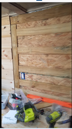

So I've been working on sealing stuff up. I got the left side of the trailer panels in place and did something 'creative' with the kitchen area. I also put the metal roofing on the ceiling.
Some pics:

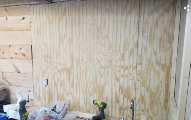

I had to create a little 'wall' for the kitchen paneling.
Back panel in place. I like it more when I saw it in the box store. I figure once I paint it I will like it more.

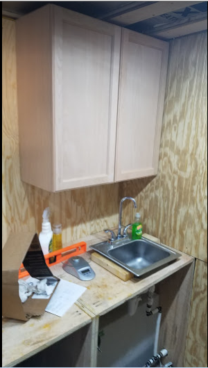

Side Kitchen Wall in place.
I splurged and bought an HD cabinet for 80 bucks. The back is made of particle board and I wonder how it will hold up. We shall see.

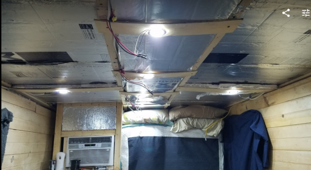

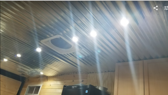

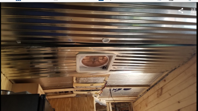

Pics of the metal ceiling.
For the rest of this weekend, I hope to finish the counter, build the cabinet doors for the base of the kitchen counter, and add trim to the ceiling. After this I'll put my focus back on the bathroom in order to wrap things up.
I do like the way the ceiling turned out. Working with the metal isn't too fun because it cuts easily, but it's worth it. I also just discovered I have a short, so you have to be really careful with the metal and your wires.

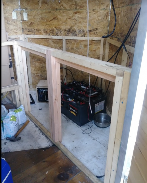

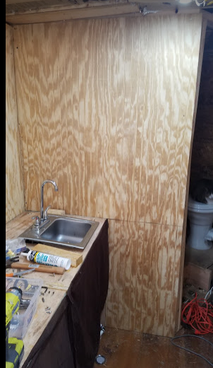

So I didn't get as much done as I wanted to this weekend, but here are a few pics. The challenge for me is that I'm on a farm in Florida and actually living in the trailer while renovating. Tricky for sure.

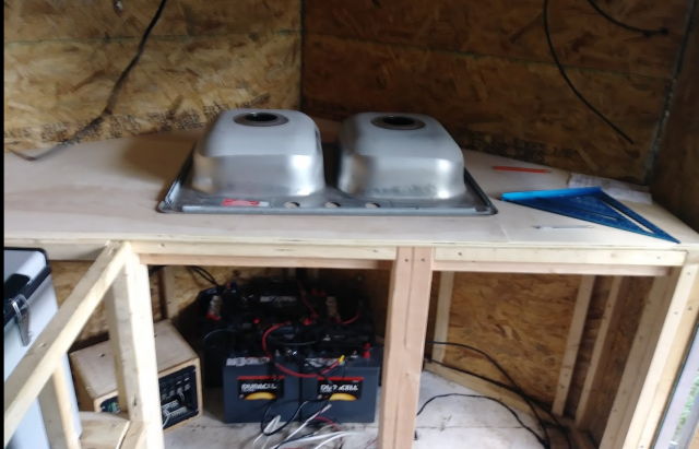

Here is my new framing for the nose. Keeping my battery bank in the front. I'll be using the PD4045 for just charging the batteries when connected to shore power.

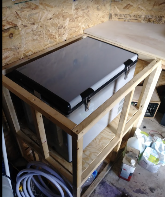

My new Whytner 12V fridge in place. I still haven't fired her up, but I hope she will perform well.
That little single sink was killing me, I'm now going with a double sink.

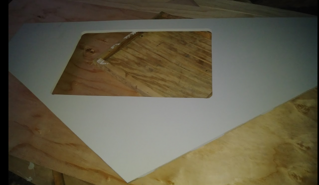

Sink cutout and first coat of paint down. Plan to do one more coat of paint and two coats of polycrylic.
I hope to have my sink back installed and running by Wednesday. Life is hard without no running water and a sink.

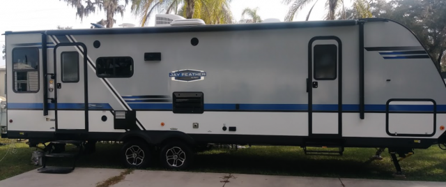

My new Trailer:

We all need to find our own path to wander. So, good lookin' RV, that a Jayco? they put out a
fairly good quality product. Did you move your 6v batteries from the CT over to the RV? Great
for when you boondock and if the power goes out at the connection you'll even be able to run
the heater till it comes back on. ;)

I'm on the fence about this. My 6 batteries would add about 390 pounds. I have to really watch my weight and my payload since I just have a half ton truck (Although with the new tires, airbags, new shocks, and new brake controller, my new trailer tows way better than my cargo trailer did). I think I might sell my batteries and buy one bigger gel battery. The weight on the one I am looking at is about 121 pounds for 200 AH (Renogy batter I believe). I also may only keep two panels and sell the other two. Now my fridge can run off propane when not connected to shore power, so don't think I need that much power.
Yup, it's a 2019 Jayco JayFeather 27RL. I love it so far. So far I have about a month in her, so we'll see how she holds up long term. Everything works so far and I have a 5 year warranty, so well see.
