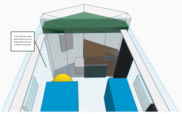

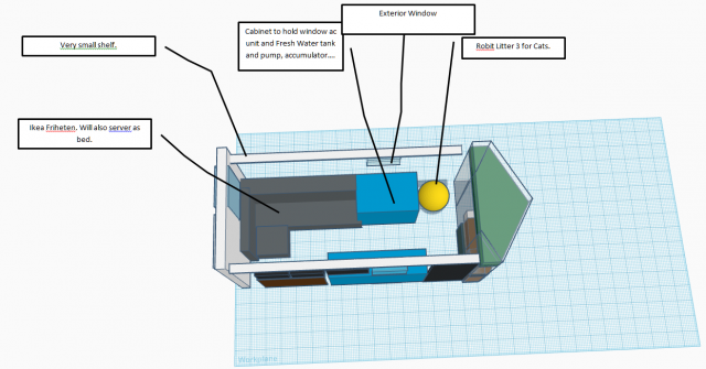

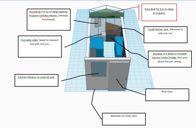

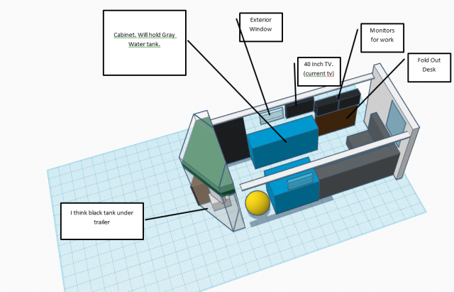

Below first rough designs are below. Any feedback or anything that looks off please let me know! I didn't really consider weight distribution too much. But I put the water tanks on both axles and tried to spread stuff out.

Postby Padilen » Mon May 22, 2017 6:36 pm
You shouldn't need a pump for gray water. Install the waste/drain lines with a little "pitch" in them to tank. The tank has to be lower than your waste/drain lines.

Padilen wrote:You shouldn't need a pump for gray water. Install the waste/drain lines with a little "pitch" in them to tank. The tank has to be lower than your waste/drain lines.
Padilen,
I figured the tank would have to be lower. I was planning on putting it on the opposite side of the fresh water tank over the axle(Inside the trailer), but just don't see how that would be lower than the pipes coming from the shower/kitchen sink. I think i'll have to put the tank under the trailer which really seems hard to do, but I think it just may be the best bet.
Any pics of someone who shows how they do the gray water 'pitch'? I've searched but haven't seen too many pictures on here of it.
Thanks for the info.

Postby Padilen » Mon May 22, 2017 9:32 pm
It's only about 1/4 inch per 10 foot run for sewage. That's so the liquid doesn't "run" away from the solids. Not so much an issue with just gray. If you are having walls or cabinets run your plumbing in those and it's hidden. Many different ways to do it. Here is what I use. But I do not have a gray tank. My sink and shower drain onto ground or if not allowed into a portable RV waste tank.
https://www.etrailer.com/RV-Plumbing/Ca ... AjDs8P8HAQ

Postby jr9744 » Mon May 22, 2017 9:48 pm
Padilen wrote:It's only about 1/4 inch per 10 foot run for sewage. That's so the liquid doesn't "run" away from the solids. Not so much an issue with just gray. If you are having walls or cabinets run your plumbing in those and it's hidden. Many different ways to do it. Here is what I use. But I do not have a gray tank. My sink and shower drain onto ground or if not allowed into a portable RV waste tank.
That's not bad for the sewage. I'm less concerned about the sewage since I plan to mount that underneath directly under or near the toilet. I'm more worried about the shower. Mainly the shower because it'll drain down and have to go back up to the gray water tank on the other side. The more I think about this, I think underneath may be the best bet for the gray tank. I also like the idea of no gray water tank because that sounds really simple. I have the item above on my list. I'll keep thinking about the placement for the gray tank.
