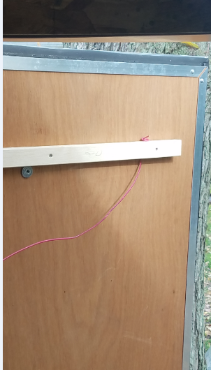

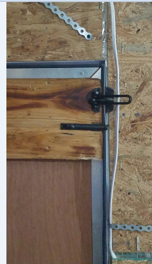

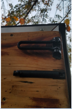

jr9744, Howdy;
You can always use a sliding bolt like one of these;
https://www.homedepot.com/b/Hardware-Do ... 5yc1vZc6mm
Don't forget to find a way to secure the swinging handle that is already there so you don't end up getting locked inside.

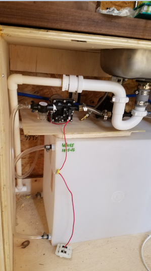

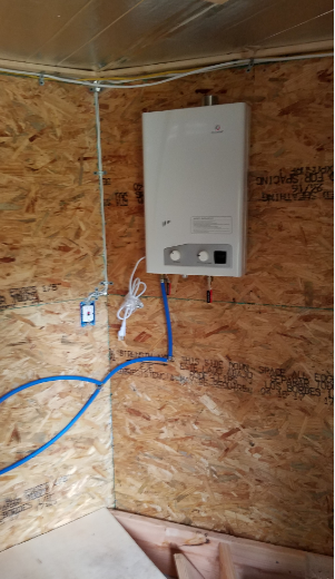

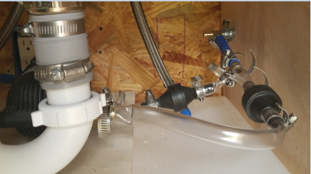

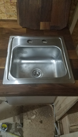

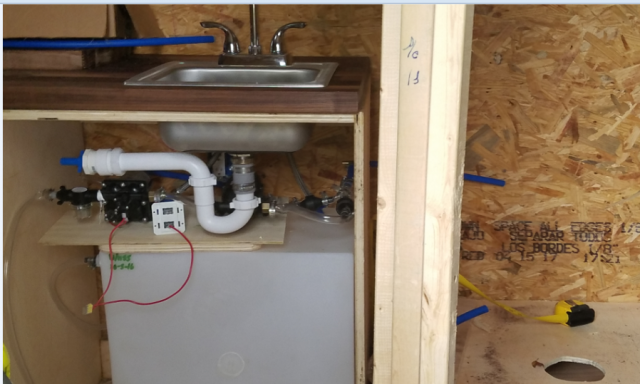

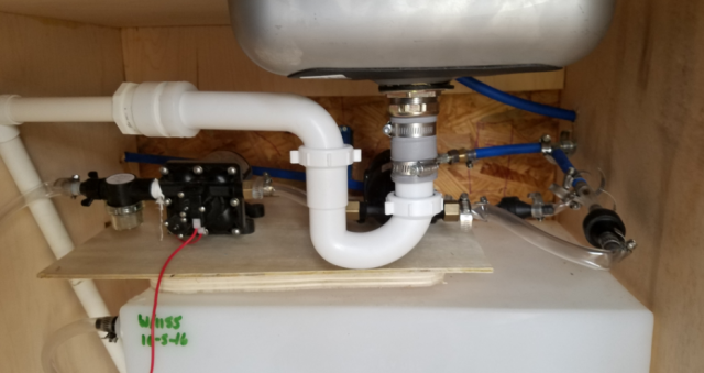

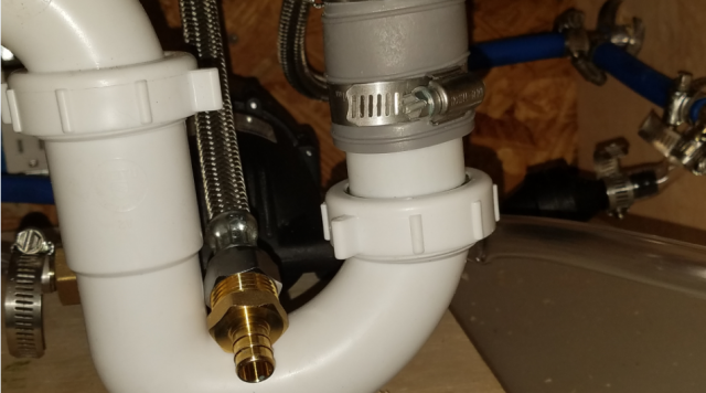

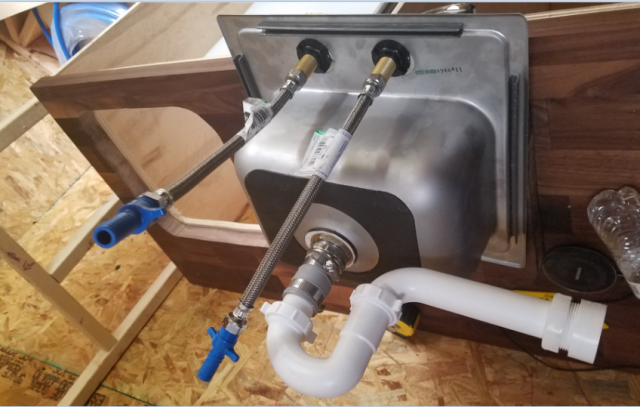

jr9744 wrote:So managed to get some more of the plumbing redone under the sink (Only 2 more trips to HD). Kitchen sink is fully done with the exception of the gray water plumbing and the hot water from the heater.

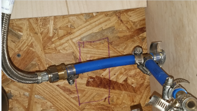

Notice the gold 1/2 to 1/2 pex adapter I had to buy.

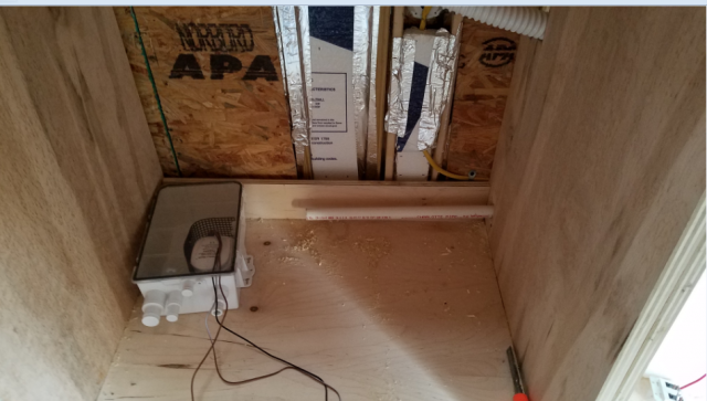

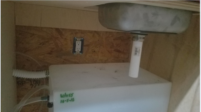

Iconfabul8 wrote:If your sink is high enough to plumb directly into the gray water tank I would do it. No sense in plugging up the sump strainer with food stuff if you don't have to.
