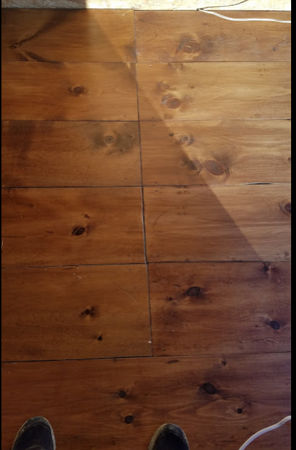

I've basically have done all the sanding and painting by hand. Preparing floors is very labor intensive, but I'm happy with my result of the first panel. It can only get better. A before/after pick
Inside the trailer
Considering I've never done this before, I'm very pleased with the results. 9 more panels to go!!
In case anyone is interested, here is what I did
- Sanded the board with 80/120/220 to get a smooth board
- Brushed Minwax Pre-Conditioner since I'm working with blochy pine. Waited 15 minutes and then wiped this off.
- Brushed Minwax Early American 320 Stain on the board. Waited 15 minutes. Wiped off any extra left on.
- After the board was dried, I added a very thin layer of Minwax Fast Drying Polyurethane. Waited about 6 hours for this to dry.
- Once the Polyurethane was dried, gave the board another 220 sand.
- Gave the board one last coat of the Polyurethane and waited for it to dry.

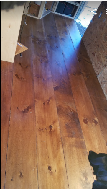

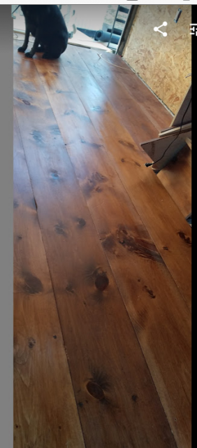

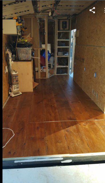

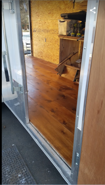

I've finished all the boards I needed for the floors and have screwed the boards in place. I still have to cut about 1 7/8 strip for the far wall to have all the boards technically down. After I get the last board down, I plan to give the floor a sanding with probably 220 grit paper and then apply some minwax flooring I bought. I'll probably go with at least 3 coats.
Although I'm not done with the floors yet, I really like how it looks so far. It also feels really nice underfoot. You can tell they are just solid wood planks.

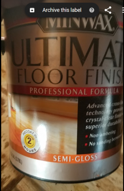

After sanding the floor again, I plan on putting 3 layers of this stuff..
Here is how the floor looks from the door.
Looking in through the front.
Looking in from the back.
From back with ramp open. I wish I bought 16 foot boards, but I had to make due with what I had. I had to cut and sand away to get the butt's as close together in the back there. I may buy some wood putty and see if I can use that to either make the gap better or make it look like one board. I will have to throw some more stain down too.
"The Crease"

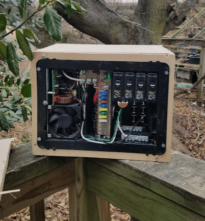

I made a box for the PD4045. I'm getting good at making boxes.
I hope to get at least 1 layer of the flooring finish tomorrow. The can says every 2 hours you can recoat, but I suspect I may wait longer between coats. It also says no sanding, but we'll see.

Postby hankaye » Sat Jan 06, 2018 10:34 pm
jr9744, Howdy;
Yep, you're getting good at building boxes. Did you put some sort of venting in it ?
Most electrical stuff like that have a small fan to help cool it, but the fan needs
to be able to draw some outside air to do that. Just a heads-up...
hank

hankaye wrote:jr9744, Howdy;
hank
I left the back of the box open. Plus I added some vents on the side and on top. I can easily add a fan to circulate some air. You think the PD4045 needs outside air though?

Postby hankaye » Wed Jan 10, 2018 11:32 am
jr9744, Howdy;
hank
It already has one, front bottom Left, the venting is to dissipate the heat so the fan does not have to work as much.
The fan should only need to activate when there is a heavy load or when the battery runs down which make the
unit work harder.
hank
