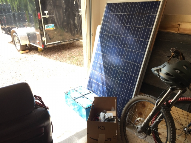

On Wednesday I picked up my solar system from a guy in CO. I'm amped.
Now all I have to do is figure out how to put it all together...

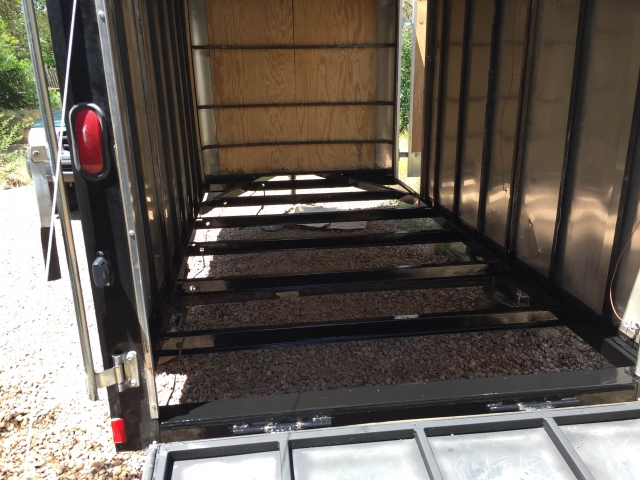

Progress:

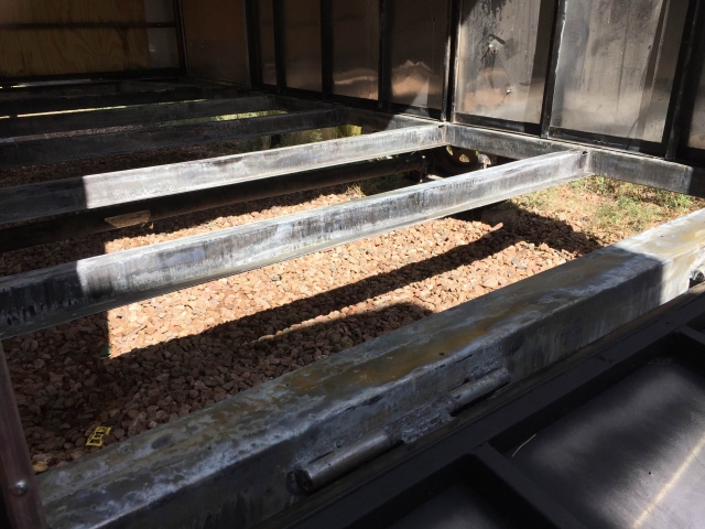

Yesterday I POR-15'd the entire frame, and topcoated the bits exposed to sun with a few coats of rustoleum.
The prep work took me about a week, and I'm hoping was the least fun part of this whole process. The existing frame was a mix of solidly bonded paint, flaking paint, rust, and road tar flung up onto rust and paint. This was my process:
.Strip the paint off with several coats of Citristrip (took me a couple tries to figure out the right method with that stuff, definitely wasted a few days and quarts of stripper learning that lesson). Coat with citristrip, let soak for 15-30 minutes, scrape off with a scraper, repeat until the paint is gone. Use denatured alcohol to get rid of dried on Citristrip gunk. I have a feeling that Citristrip is one of the weakest paint strippers I could have used and is one of the reasons it took me so long, but all the warnings of the methyl chloride strippers scared me off.
.Wire brush the whole thing to get rid of loose rust, tar, any remaining paint bits, etc.
.A coat of POR-15 Cleaner/Degreaser, then rinse.
.A coat of POR-15 Metal Ready, then rinse.
.Two coats of POR-15 rust preventative paint. Second coat went on when the first coat was dry to "finger drag", which happened to be about 2 minutes after I finished the first coat.
I also hit all the wall ribs (including the rear door) with 2 coats of rustoleum spray paint (after wire brushing all loose rust off). Most of the ribs weren't painted except for at the tops and bottoms where the customer could see them. :thumbdown:

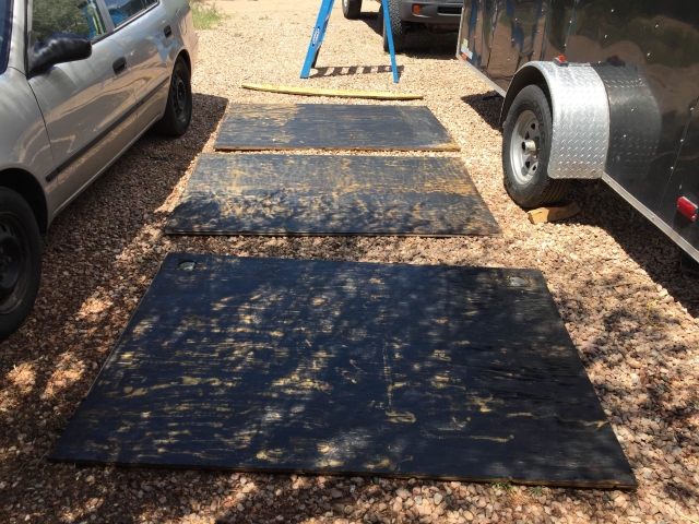

Yesterday and today I got the plywood subfloor prepped for re-installation:
.Wire brush the paint and gunk off the bottoms.
.Wire brush the gunk off the topsides. Pretty sure this trailer had been used as a general purpose hauler on a ranch in north dakota... I detected some odors that reminded me of my high school job mucking stables and bucking hay.
.Four coats of boiled linseed oil on the bottom side and edges.
.Two coats of boiled linseed oil on the topside.
.After I re-install them I'm going to proflexRV caulk the holes from the nail/screws I had to rip out to pull the floor (and all around the edges).
I did a lot of reading on what people do to their subfloors, all the way from fiberglass resin, to various epoxies, to paints, to just "leave it alone". Boiled linseed oil is one of the mellower approaches I think, but since I live in the Southwest and don't intend on any more than short visits to places like the Pacific Northwest or the East Coast, serious underbody moisture armor is probably overkill.
The main thing with combating floor rot seems to be ensuring no water is getting to it from above, via leaks, rather than any treatment you do of the floor, anyways.

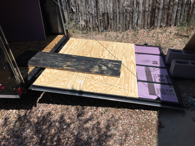

Postby tylerjd » Thu Aug 03, 2017 6:30 pm
Update:

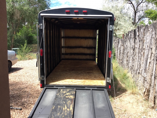

The subfloor is basically in, although I wound up replacing one of the panels with new plywood. Still have to screw it in.

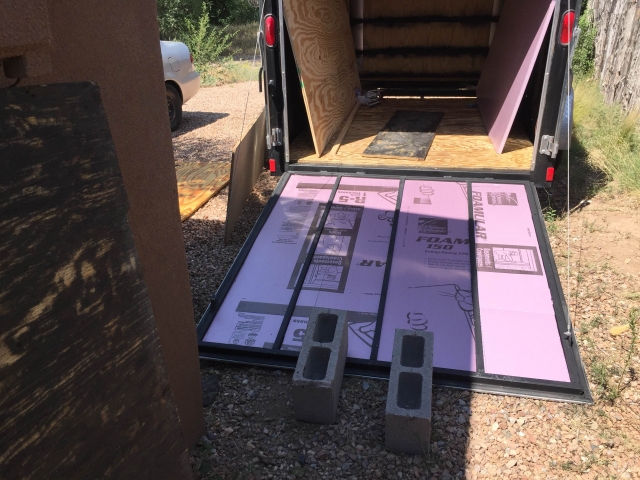

I insulated and plywooded the rear door. Used 3/8" plywood, as I'll be putting 3/4" pine planks over it and am hoping to get near what the old door weight was, so the door raiser tension thing is about right.

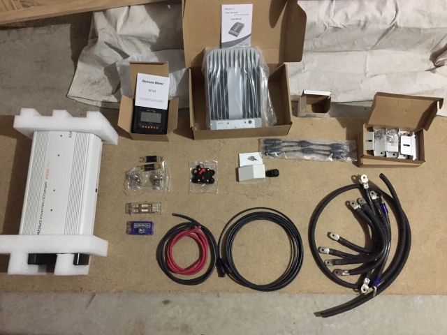

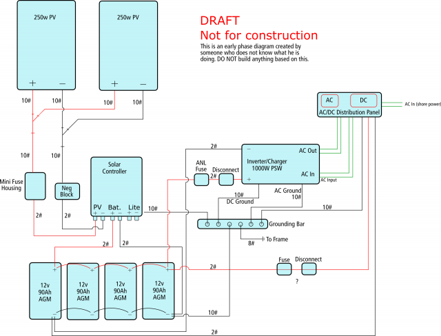

I also started digging in to my solar system components and trying to understand them all.
I generated this diagram as a first pass. The bits that are most unclear to me revolve around the AC/DC distribution panel (the only major component I don't have yet). I'm not sure if shore power goes into the distro panel, or straight into my inverter/charger. Since my inverter/charger *can* take shore power straight in to it, I guess I'm not sure why I would want shore power going through the panel first...
