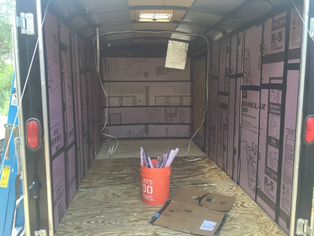

Yesterday I finished the wall cavity insulation:
Next up is putting the original plywood back on, then furring strips offset from the studs, more insulation, and paneling. Aiming to get that all done be the end of the week.

Got the rest of the original plywood on, and started tacking the inner insulation and paneling on. I'm using 2" scews every 6" on 16" center to sandwich the panel and insulation onto the original plywood walls. It feels real sturdy, with minimal "warping" or curving of the panel. Good enough for me, anyway.
Original plywood going back on.
Tacked up the insulation with a couple short screws.
Sandwiched on.

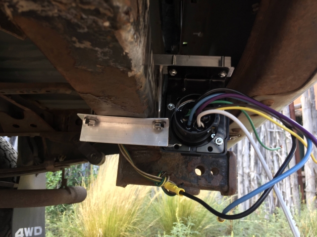

Also got my trailer plug "installed" on my truck:
Overcranked the nut and bent the bottom angle a bit. Told you I'm a rookie with metal. :-/

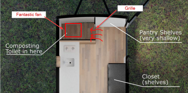

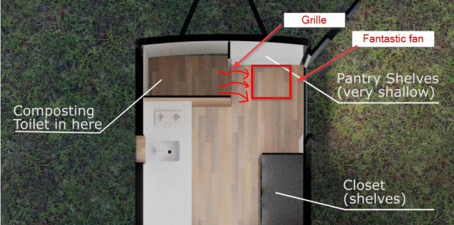

I have a question for anyone with experience on vent placement: I have a fantastic fan sitting in a box waiting to be installed. My thought was to install it directly over the toilet room in the front/left corner of my trailer, and to have some vent/grille in the wall or door between the main space and the toilet cubby so air can flow in. I'm thinking this might be a poor choice, as it might would reduce the airflow felt through the main space. It might be a better idea to put that vent in just outside the toilet room; this would maximize felt airflow through the main space, but also be close enough to the toilet that it'd do a decent enough job of sucking fumes up and out when that room is being stress tested. (you know what I mean).
I will have at minimum an operable window closer to the rear of the trailer, so the fan has something to pull through.
Also, I've read about the strategy of putting one fantastic fan fore, and one aft, and have one suck and one blow. I assume that this is total overkill for a 12' long trailer, but would love to hear corroboration for that theory.
Thoughts?
Original Idea:
Alternative:
