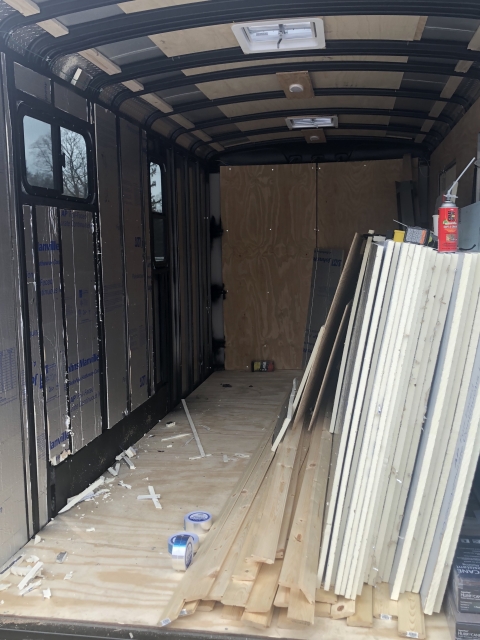

sodatrain wrote:
Main question I'm trying to figure out is for installing the pine tongue and groove the long way front to back. What's the best way to attach it given the metal structure? Thinking attaching a few pieces of lumber across the trailer (maybe 4?) and then use wood screws to screw in the T&G into those cross members? Trying to think about insulation at the same time. RIght now I have material for 2 x 3/4" foil foam. Got the thinner for the curvature of the roof.. and not sure they had 1.5".

My trailer came with 3/8" osb strips screwed to the roof bows and the ceiling material was screwed to them. Might work for you. Also I used a brad nailer to install my 1/4" tongue and groove, worked real well.

As I recall I had to cut the 1" stuff into 2 pieces to get it in. I also had to remove every other strip of osb to get the foam in. I finished off by putting pieces of 1/2" foam between the osb strips to give me a little extra ceiling insulation. However, it looks like you have got it figured out.sodatrain wrote:Iconfabul8 wrote:
Ill give that a whirl. I see you have the same curved ceiling I have. How did you insulate up there? Anything fancy or just cut a strip of foam and jam it up there?

McDave wrote:I had to have the running lights from tow vehicle on to make dome light come on, switch next to side door. Now would be a good time to run a 12/3 romex up to the vent. If you go with rooftop AC that is the hardest part of install. But even if you decide no AC, you may want a fan, light, disco ball or lighted mirror in the future... Hey, I'm not here to judge. Is the vent framed to carry an AC? I had to weld in a metal frame. The vent frame was basically balsa wood stapled up there. It doesn't have to be welded or even metal, but rooftop AC is around 100 lbs so the frame needs to connect to the roof spars ahead and behind the vent to share the load. You may have ordered that frame? Wouldn't hurt to run some wiring from front to rear even if you need it now you may in future. Maybe some 14/2 along both walls at ceiling. That would handle most DC lighting, usb, TV/DVD type loads. If you might want a RV Refrig you would want 10/2. For anything AC less than 20amps 12/3 romex would work. If the wiring is there at top of wall you would just have to drop a wire wherever you wanted a outlet or light etc. as opposed to fishing wires after walls and ceiling are finished. Also if you wanted a outside outlet or connection you could just drop a wire. You can also run wiring underneath if you have to but you will need to protect those wires. Just something to consider, 60 ft or so of 12/2 or 12/3 romex (two runs down each wall) and 60 ft of 14/2 for DC stashed in the wall/ceiling could come in handy if/when your needs/wants change after living in there for a while. The area at the top corners of wall to ceiling lends itself to that purpose pretty well, the round radius corners aren't easy to deal with and make pretty.
