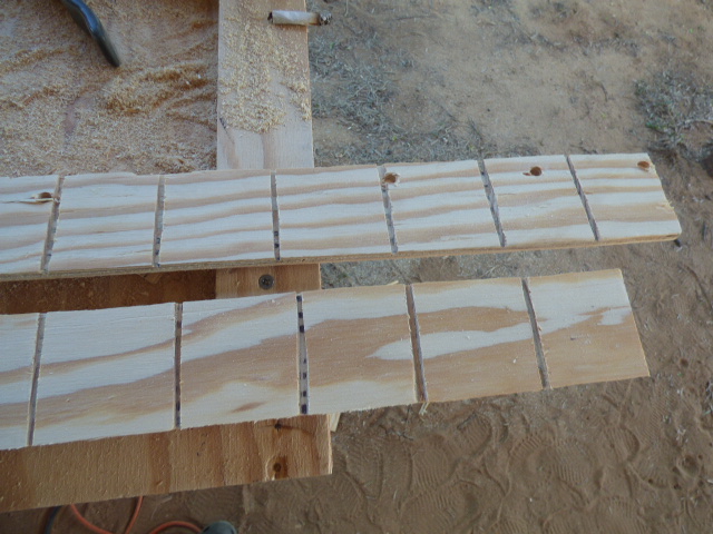

Re: Sidewall Fan???
Postby McDave » Sun Dec 31, 2017 1:26 pm
Kerfs for curves....
