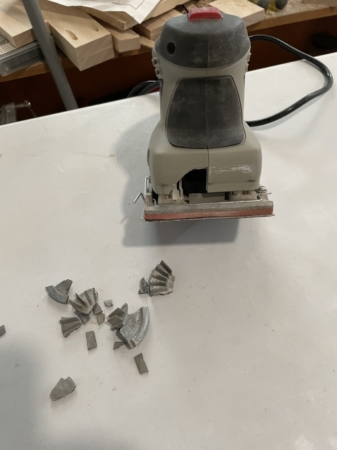

Let's see where I left off. The palm sander that exploded and scared the beejeebers out of me. Literally sounded like a gun shot going off. Took me a second to realize what had happened. After I figured it out, I check my gut to make sure I didn't have any shrapnel in me.

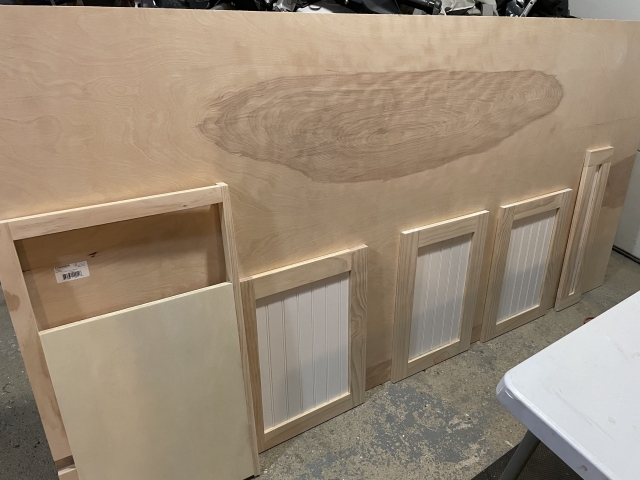

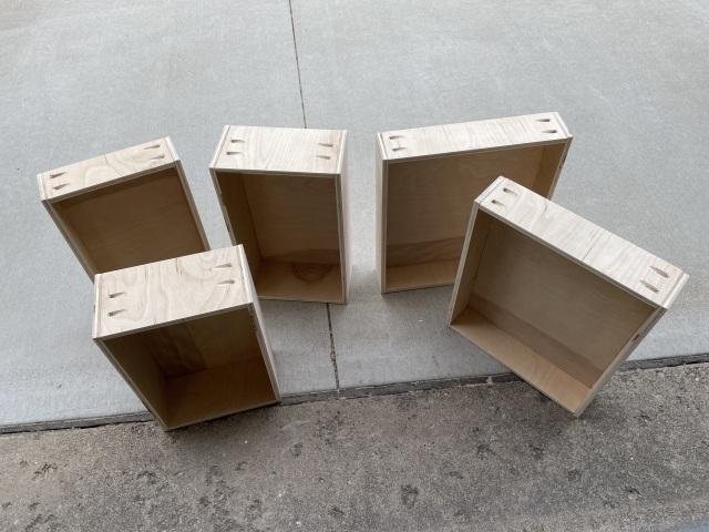

Some progress on the face frame and doors.
Primed and ready
Pocket hole drawers out of 1/2" ply

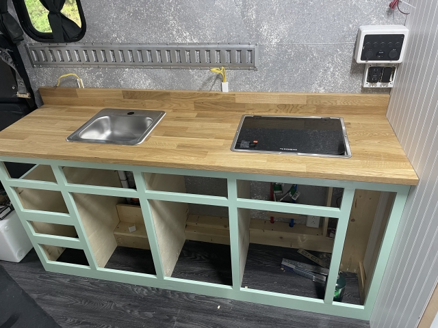

The Ikea $119 Vrena veneer counter top was 100% worth it for time savings. Especially when 3/4" ply is going for $75 per sheet. I bought the 25.5" wide counter top and cut 4" off. That gave me me 1.5" over hang on my 20" cabinets (21.5" counter), and also gave me 4" to use as a backsplash.

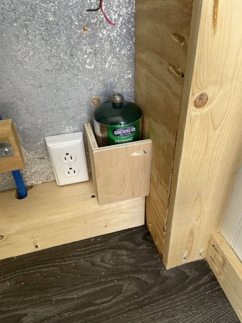

First off, found a place to put the 1-pound Coleman bottle for the stove. It's next to the switchable outlet for the water heater. The nook for storage space has worked out, more on that later.

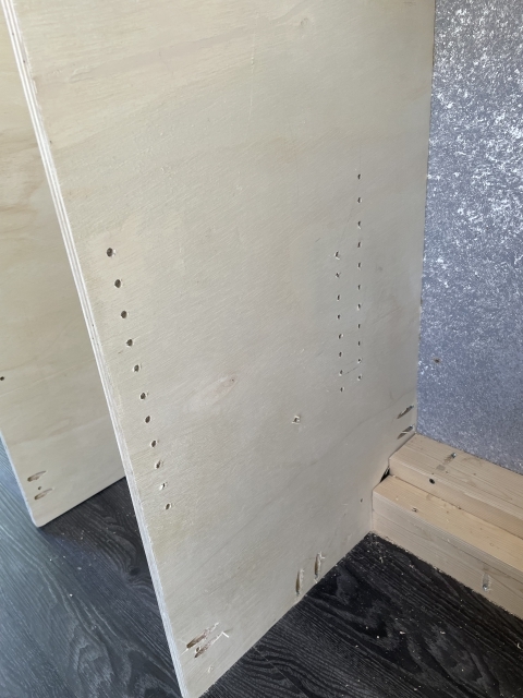

Made a template board and drilled the cabinets for shelves.

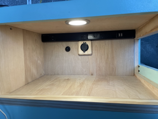

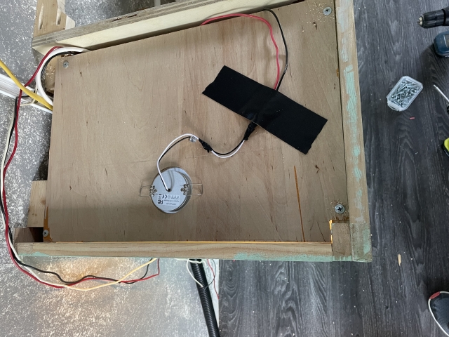

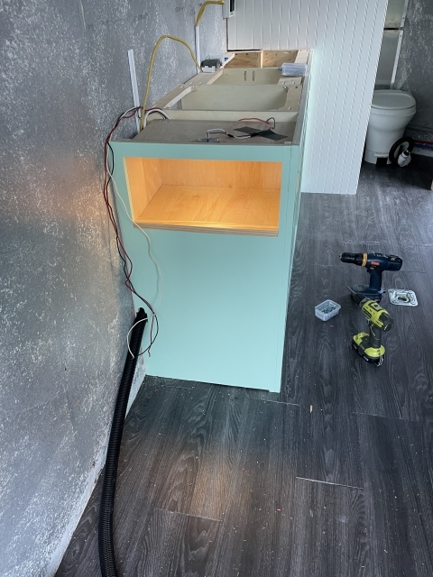

Next up I finished the side shelving that covers the fresh water inlet and makes a nice lighted shelf for the side of the bed/couch. I wish I had taken more pictures of the build as this wasn't easy.
The top with the 12v LED light.
The lighted space.
With the removable shelf installed highlighting the 12v and 120v outlets and USB ports. The top strip was in the trailer when I bought it, so I wanted to repurpose it. .
Water inlet hookup and vent hose for fresh water tanks.

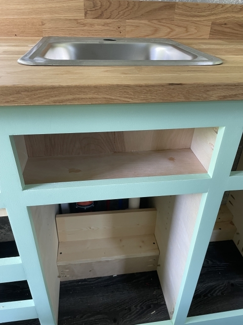

The sink nook. My wife asked me to utilized all of the space and I had extra hidden hinges so this happened.

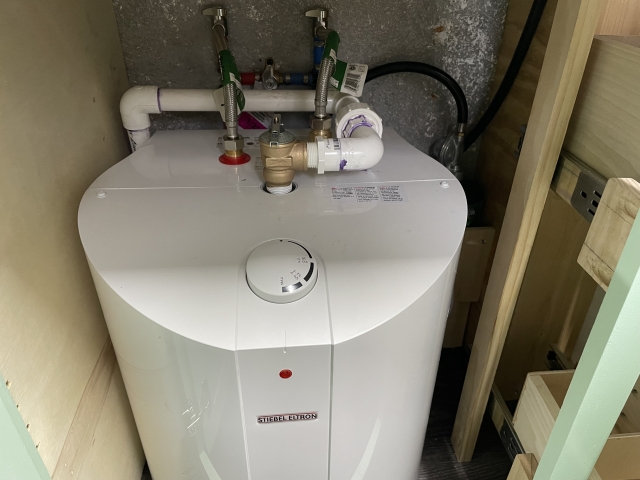

The water heater overflow drain. So this is the episode that destroyed a day. After having it sit in my basement for a year I was able to hooked it up. Finally had a chance to fill it and the overflow pressure relief valve starting leaking right away. Really PO'd me initially. After some pondering I decided the easiest and best course of action was just to run to the big box store for replacement valve since they are a standard item (even with a 4" temp probe). So $17 dollars later I was ready, but then had to head back to big box store for more PVC elbows. Although I was upset about a new item being defective, I've come to terms with this being a blessing. I was originally not going to connect the overflow valve, but seeing how cheap they are I decided to make a drain for it which will save me (or the trailer) in the long run.

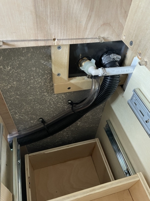

Postby jaws_1972 » Sun Jun 05, 2022 9:48 pm

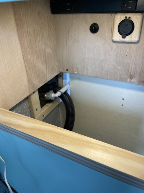

More progress with the drawers installed. First time using sliders.
Doors and some hardware installed.

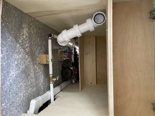

Space for the water pump and drain. Eventually I'll have to fill that hole with some expanding foam.

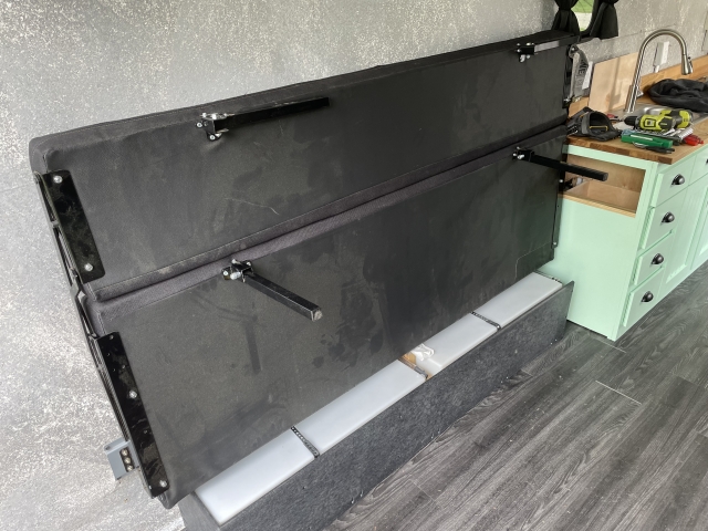

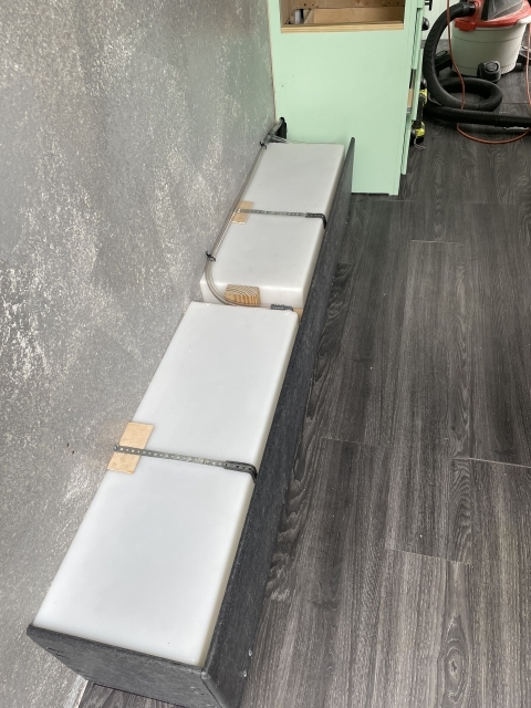

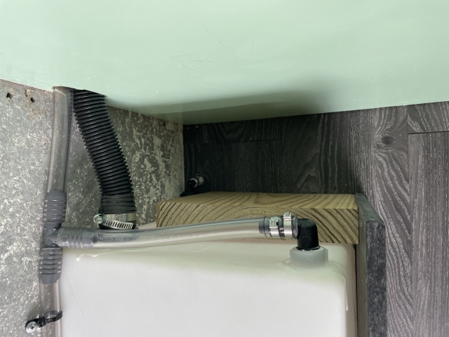

Installed the fresh water tanks. The previous owner used a bunch of the composite board as kick boards, so I used them to the build the water tank boxes. Probably $100 worth of material in today's market. Very glad to be able to repurpose it.
Fits nicely below the bed / folding couch.
Currently the 2nd tank is gravity fed through the inlet from the 1st tank. However, there's plenty of room between the wall and the bed frame so this may change in the future. Not at the top of the priority list right now.

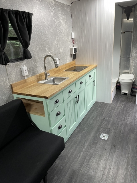

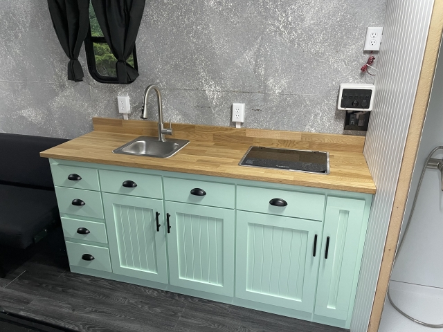

The finished cabinet

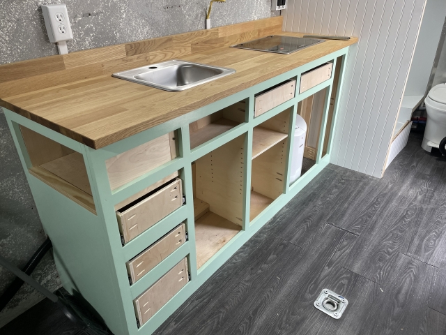

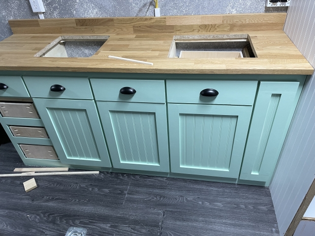

Postby jaws_1972 » Sun Jun 05, 2022 10:02 pm
And the end product. I needed to hit the easy button and just use a nice piece of 3/4" Birch for the cabinets (Edit: the plywood was just used for cabinet body. The face frame was built from 2", 3" and 4" wide 1" thick hardwood pine boards using pocket hole connectors). I'm really glad I did as the end product totally exceeded my expectations. Most of the drawers and shelves could use some more finishing (sanding), but good enough to go camping for now.
My favorite angle.
All of the drawers and shelves.
