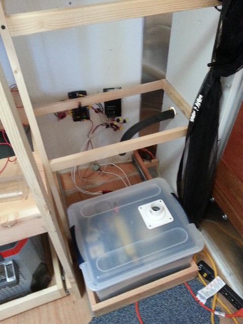

I put two 6v golf cart batteries in a sliding drawer. It works great. I just allowed enough wire to come all of the way out. When I slide it back in I guide the wires so that they don't get kinked or in the way. I also detach the vent hose from the top and reattach when done. I also put Anderson plugs on the wires to detach completely. This image is from the build stage.
I don't know why my images are now all on their side in my build or in this post. When viewed in my gallery they are upright.

I only undo the Anderson plugs if I am checking for a problem or need to undo a wire for some other reason. There is enough slack in the wires that I can pull the battery box out to check the water or do other maintenance without undoing any wires.
I should also say that the picture I posted was of my preliminary installation. I have since cleaned up the wiring routing and direct wired all of the wires that have temporary wire nuts on them.
I only have two golf cart batteries. I looked for quite awhile for a tote that would fit them. I think I found this one at a Staples or other office store. I had a small tape measure that I carried with me when I was looking. It does have a tight fitting lid with a rubber seal.
There are also regular battery boxes that are made to be vented out. They are fine, but spendy, and wouldn't fit my space as well.
