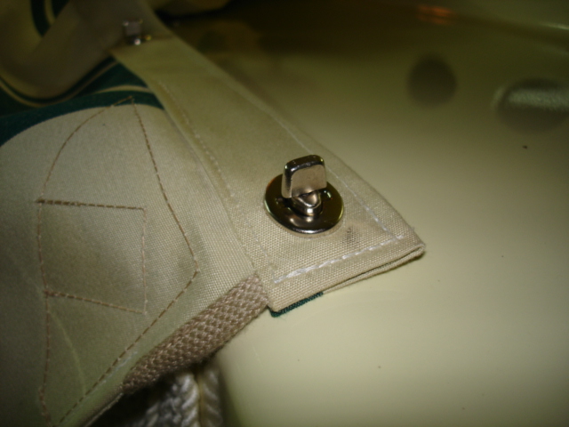

Butch, there are two commonly used methods for awning attachment, one, used on the old trailers, is the rope and rail. There is a permanent rail attached to the trailer, and a rope sewn into the awning that is then "slid" into the rail. The second method, which I used, as did Doug Hodder did on his last two trailers. There are several (I used 8, could have used just 6 probably) twist locks attached to the trailer, then a metal eyelet is set into the awning and it is attached by slipping the eyelet over the lock and it is twisted like this: (these are Doug's pics!)
Follow this thread for Doug's better explanation and more pics on how it works.
http://www.tnttt.com/viewtopic.php?t=32304&highlight=awning+twist
