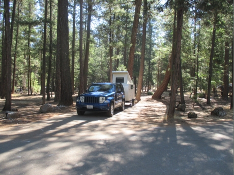

In backing into what I call my “good fortune” campsite, I saw that my next good fortune was to be camped beside a teardrop that I had not seen. Even before I was finished setting up, I excitedly went over to talk to the owner and get a quick look.

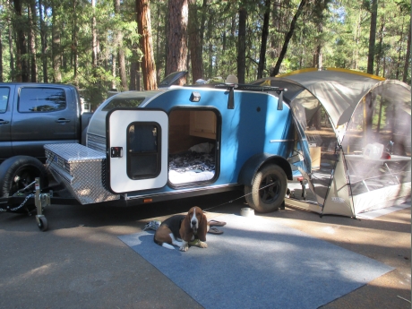

While at first glance, it looked like a manufactured unit, it was beautifully handcrafted and the owner didn’t even know about our tnttt forum! With that, I decided that a more extensive look was indeed warranted.

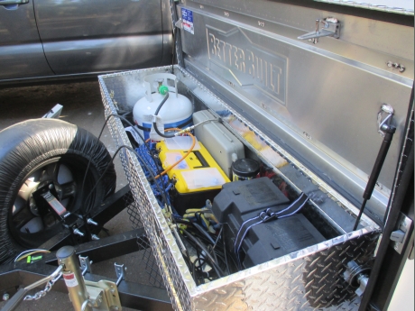

This 1100 lb, 5x10’ trailer was well planned and the build, well executed, from the chassis and tongue box all the way back to the exceptionally built galley. Rather than use a lightweight Harbor Freight trailer, he re-purposed a heavier trailer found on a farm. The sides are 1/2 inch maple plywood, cut with a CNC mill by a friend; and then, he sent those sides out to have their exteriors powder coated blue.

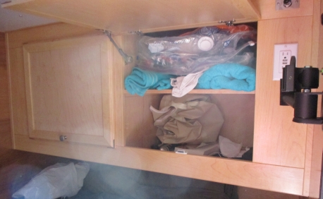

The camping interior was kept clean and well-appointed. (I had him open one side of his cabin cabinets so you could see more detail.) The roof has 1" insulation and the ceiling is covered in 1/8 inch PVC sheeting. (Sorry for the dust spots in this picture.)

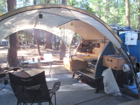

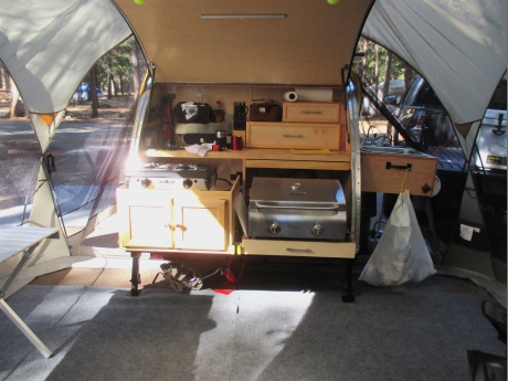

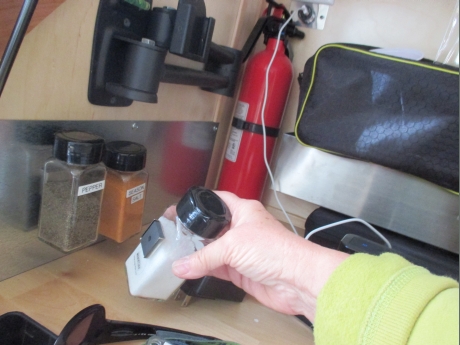

The galley shows so many innovative ideas. It has a removable sink on one side, with two removable water storage units and a wheeled gray water tank. There is also a side table (not shown) that can be slid onto the other side. He had both a propane stove and a propane barbecue and he wondered why more people didn’t mount a barbecue in their galley. Both units are on 50 pound drawer slides like the ambulances use. He pressed the yellow buttons to lock and unlock each.
Most everything in the galley was organized in drawers; but, I liked the magnet idea that he used for his salt and pepper!

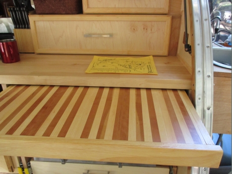

The cutting board, also a roll-out, was hand made by the owner, gluing strips of two different woods together.

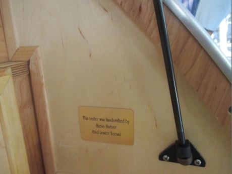

He even had a personalized plate inside the galley!
