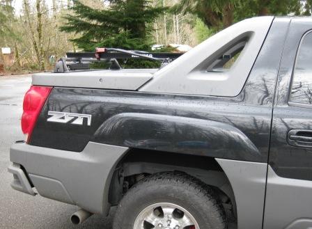

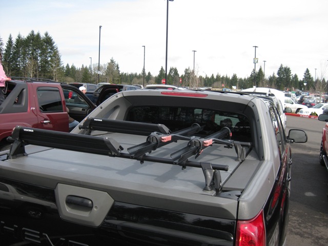

Here is what I use to haul our mountain bikes - I can handle up to 4 bikes on the rack with all the bike mounts installed. I put it together with all off-the-shelf Yakima parts.
My goal is to make the ultimate shuttle vehicle! (we especially enjoy the bumper cupholders)
<i>What do you guys use for moving your gear?</i>

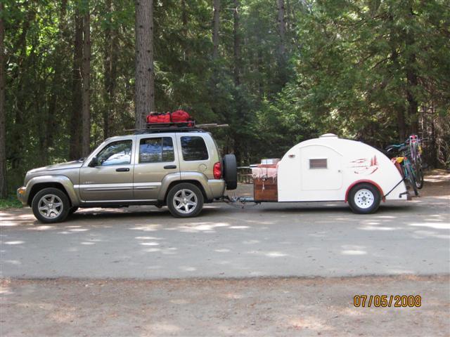

bike rack on back of tear. Need to work out a better hook-up. This bent the vent on the top with the straps.

Can you list all of the part numbers you used. I have an Avalanche and have considered doing the same.

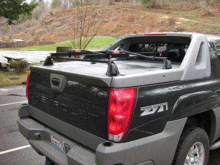

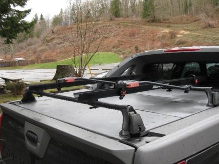

Here you go:
Yakima parts list:
(2) 48" round bars
(4) Q-Towers
(4) Q30 Clips
( 8 ) SRS Locksets w/ keys
(2) Raptor Bike Racks
That is all it takes. The clips are "L" shaped and slip under the bed panels. When latched, they will not move. The racks themselves are easy to use. Just place the bike in the tray and slide the bar up to the bikes main bar and clamp it down.
You should be able to take out all of the fore/aft and vertical load on the tear sidewalls, and actually the side-to-side load will come out on the corners of the tear if the 'arms' stay tight to the trailer. You've inspired me!

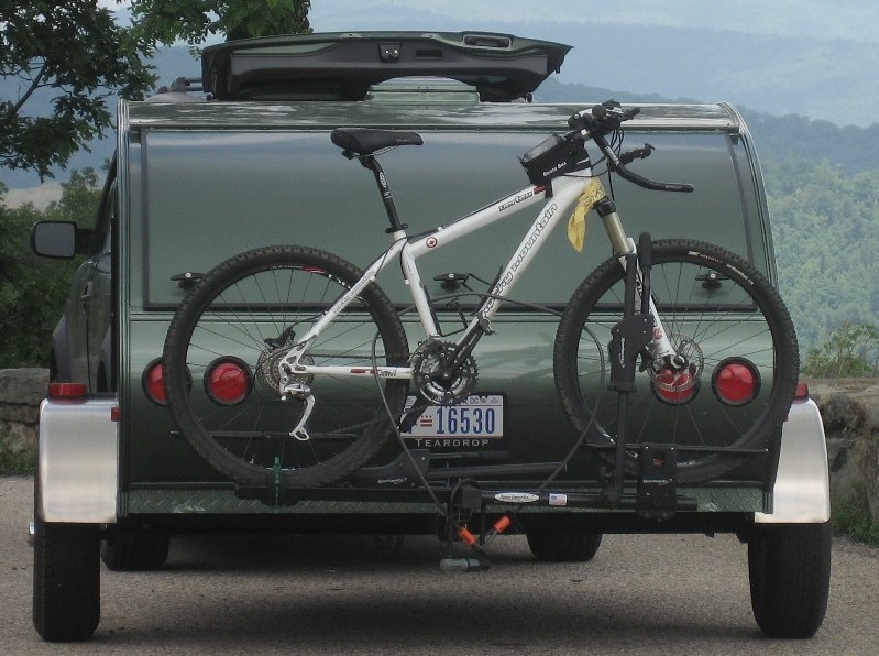

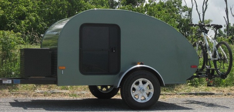

Sportsworks Transport Receiver hitch-rack (Little Guy welded on the hitch receiver when I bought the teardrop). Carries two bikes. And my teardrop hatch opens with both bikes on.

Here is a better pic of the setup Endo:
