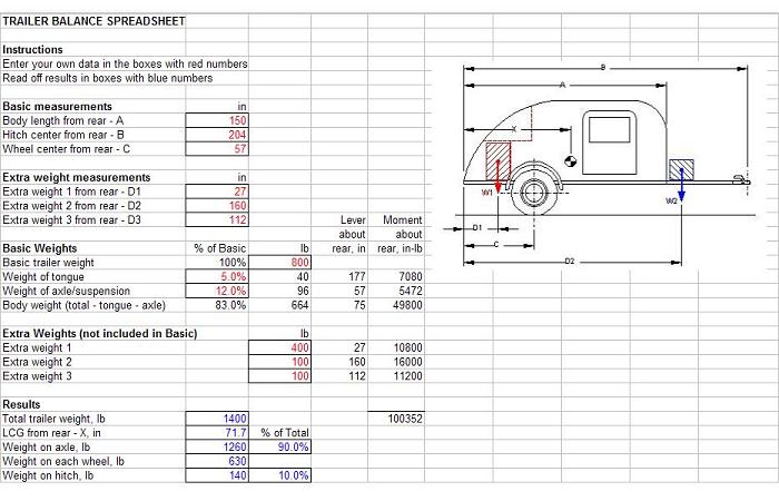

Postby TD Beej » Fri Sep 18, 2009 4:41 pm
I ran a couple of spread sheets one with bikes and front and a spare tire on the back, the other with no bikes and the spare moved to the front. The weights are a bit of guesswork (any comments?) but the tongue weights are spot on which means that this is probably very feasible provided an appropriate bike rack can be found.
With Bikes and spare on tail:
No Bikes and spare on tongue:
