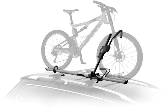

Postby Oldragbaggers » Fri Dec 09, 2011 10:09 pm
We had a 2" receiver welded to the back of our teardrop frame also with the intention of using our hitch rack back there, but after talking to a couple of bike rack people we thought better of it. Without exception, everyone we have talked to has advised us against using a bike rack at the back of the trailer for all of the reasons in the above posts.
So we have decided, if they will fit, that we are going to mount two of these on our A-frame tongue. We haven't really gotten to that point yet, but if it will fit, that's the plan.

Postby GuitarPhotog » Fri Dec 16, 2011 10:32 pm
Oldragbaggers wrote:We had a 2" receiver welded to the back of our teardrop frame also with the intention of using our hitch rack back there, but after talking to a couple of bike rack people we thought better of it. Without exception, everyone we have talked to has advised us against using a bike rack at the back of the trailer for all of the reasons in the above posts.
It's my intention to do use that same bike rack cross-wise on my tongue also. Let me know how it works and what issues you encounter.
