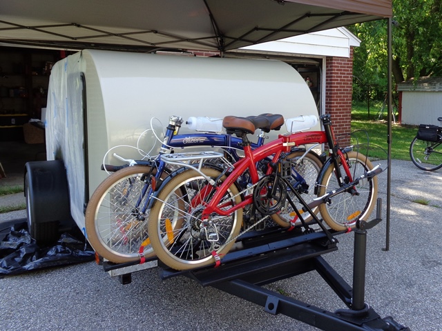

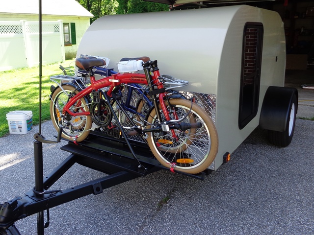

But then it occurred to me that the folding bikes were much smaller so would not stick out so far past the sides of the trailer, and the pedals fold in flat so the bikes can be placed much closer to each other on the racks. I decided to give it another shot and see if I could make them fit on the tongue of the trailer. I got a 2-pack of Swagman roof mount bike racks for $46 on Overstock.com thinking I could just bolt them to the tongue, but there were logistical problems with the mount points not working with the tongue frame. I decided to build a small platform where I could create good solid mounting points then the platform could be bolted to the trailer tongue.

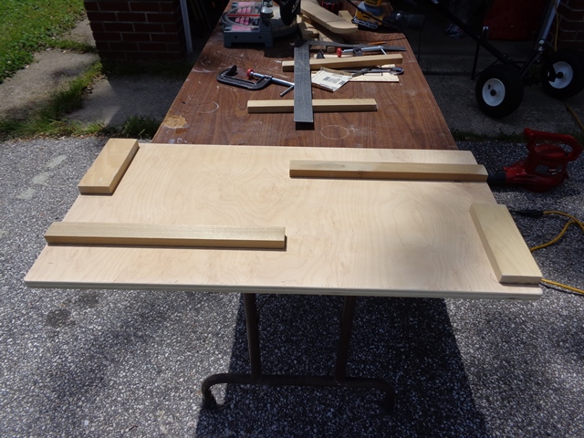

First I constructed a plywood platform and used poplar dimensional lumber for attachment areas for the rack. This was necessary because of the bolts and metal lips on the bottom of the rack.
The plywood was Baltic birch leftover from the teardrop. It is not exterior grade wood and since it would be exposed to the weather I coated it with epoxy resin to waterproof it. Then it was sprayed with black Rustoleum truck bed liner to match my fenders and tongue box. Next the racks were screwed to the platform with stainless steel screws. The platform is bolted to the trailer tongue with 2 large bolts.

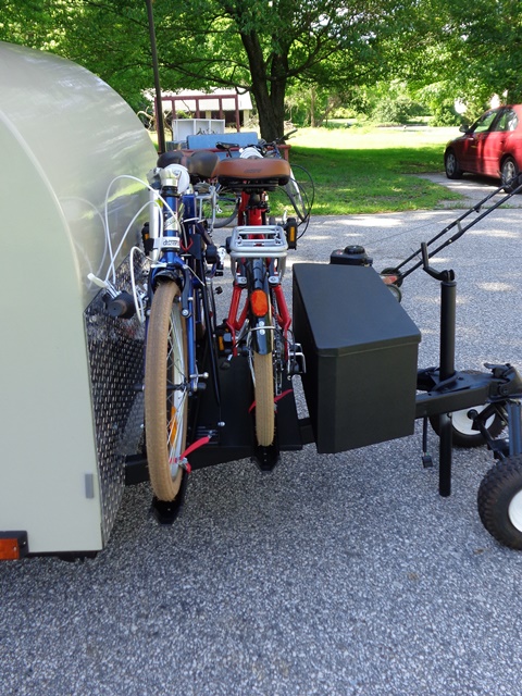

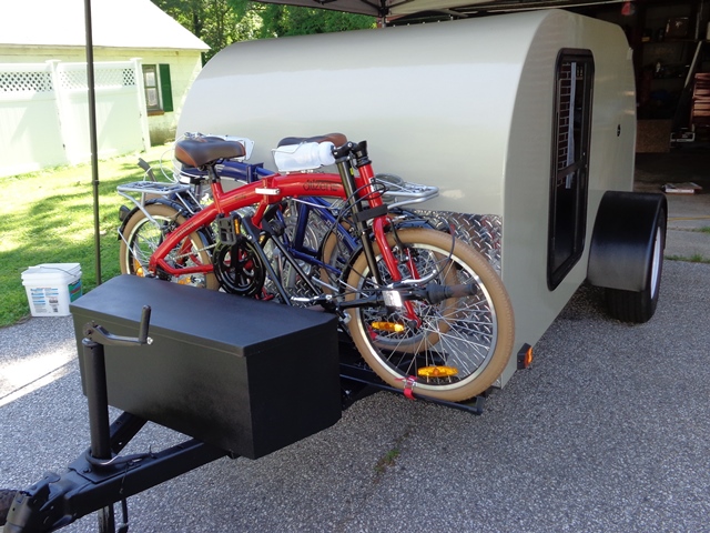

It was extremely important to me that we still be able to use our tongue box. We have found it to be so convenient that we didn't want to be without it. I think I would have abandoned the plan if it wouldn't have fit. It not only fit, it also pretty much hides the plywood deck that the racks are on.
The rack took no more than a total of 15 hours to build, epoxy, paint, assemble, and install but probably involved a few hundred hours of trying to figure out how to do it over the past 2 years. I am very pleased with the result. The rack is relatively small and unobtrusive, especially once the tongue box was installed, the bikes sit rock solid on it and it can be easily removed in the future if our needs change. I am planning at some point to get some Surlast, Sunbrella, or Cordura fabric and sew a cover for the bikes that will fit over them while they are on the rack. We never ride the folders except when we are camping so they can just live there on the teardrop all of the time and will always be ready to go when we are. And since they are so easy to take on and off, the likelihood is increased that we will ride them whenever there is an opportunity to do so.
If we need additional clearance room for the truck to make tight turns I will get a 12" hitch extension, but it looks like we have finally arrived at a good solution for our bicycles.

Postby Oldragbaggers » Tue Jun 10, 2014 8:04 pm
We got the truck back tonight so we were able to hook up and test out the bike rack set up. I am extremely happy to report that it looks like it will work, tongue box and all, without a hitch extension. Lance did a pretty sharp U-turn in the street and there was at least 6 inches of clearance between the back of the truck and the box. The only situation I can imagine where it might be a problem is if it got pretty much jack knifed backing into a campsite. I guess we'll just have to avoid that!
