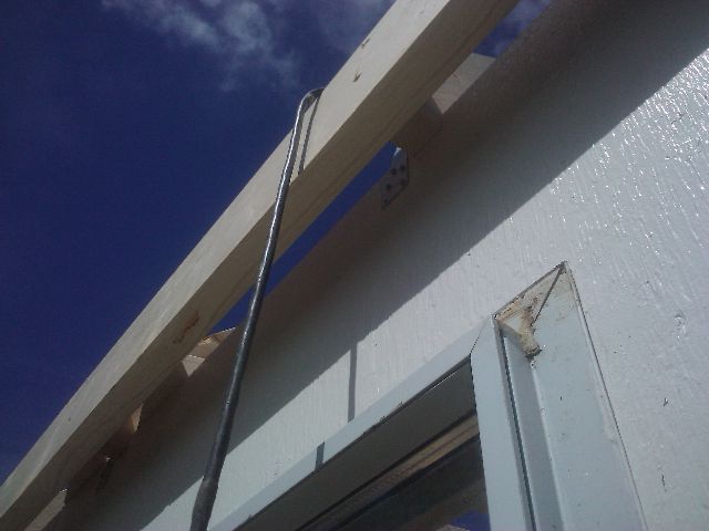

This next set of pictures show the roof being built . The rafters are installed with a selection of 3 and 4inch #8 screws along with hurricane ties . The roof sheeting 7/16 osb glued and stapled . The corrigated roofing is screwed over 35lb felt. Extra screws were installed on the leading edge of the corrigated roofing. Sandy

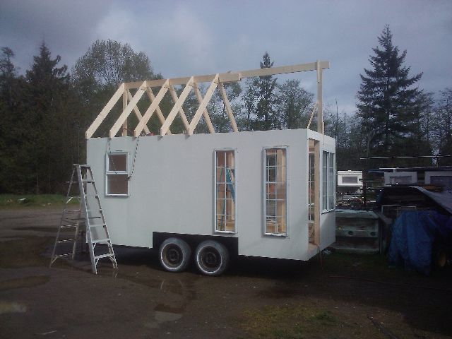

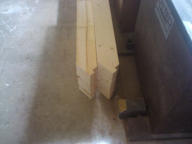

rafters cut and ready

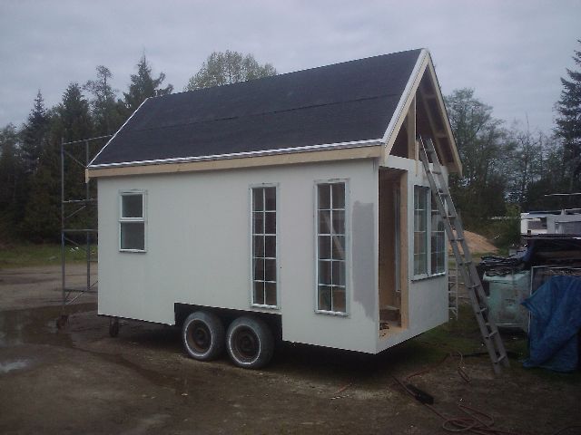

starting to look like a roof
Postby Sandy St. Louis » Sun May 29, 2011 11:17 pm
[img][img]http://www.tnttt.com/gallery/image.php?image_id=79305[/img][/img]

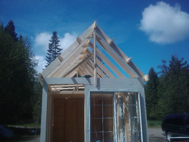

rafters up installing gable ends and facia

a poor picture of the hurricane ties

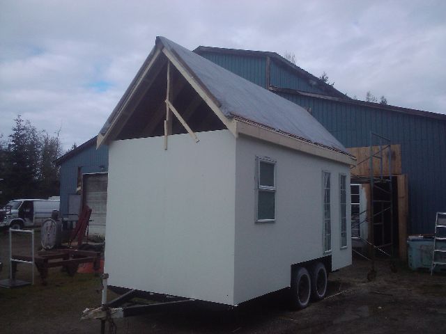

the osb is installed roof is tarped for the night

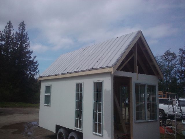

corrigated on less roof cap
