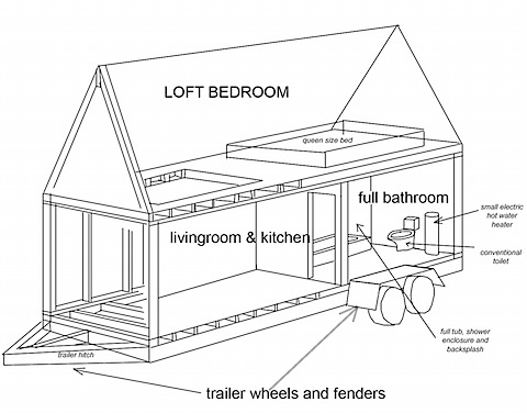

Here is a little drawing I stoled from ???? and it shows a little of the framing. On these the wall sets on the top plate though. Saw somewhere where the loft bed was placed on an elevated platform and a shallow square water tank was incorporated in it. Gravity fed water supply, no pumps no problems. :thumbsup:

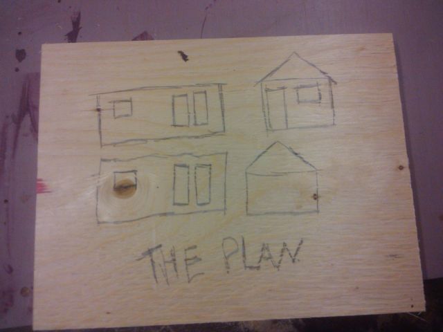

Having posted 3 recent pictures in my album, The foundation ,The plan, and the start and trying to include in this post I can now understand why we aren't permitted handguns we would have to import to many computers. Anyway I will try again later. Having read and reread all the posts here on minihouses I'm going to buid one. The body will meet all dot specs I believe not exceding 13.5 tall,8.5 wide andabout 21ft long. The first stage will to get it to lockup with the exterior finished . Having spent another hour and still no picture please look in my album . Sandy

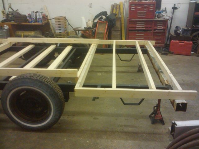

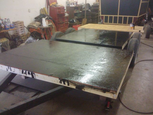

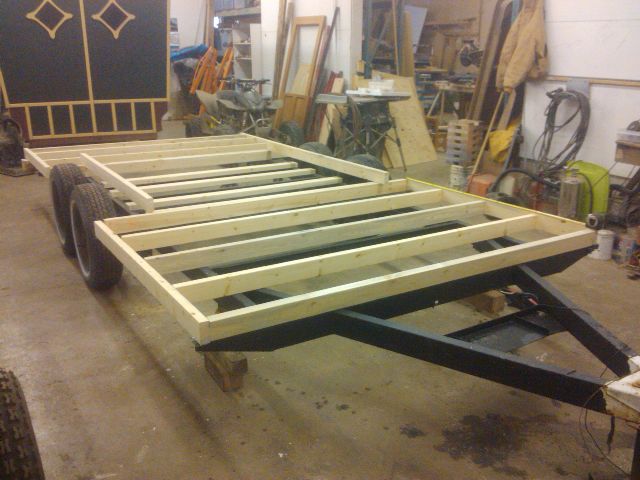

Yesterdays pictures are up ,still lots of learning on this puter. Still trying to get more than one on a post . More progress has been made. Due to the size of the floor and myself I've decided to do the framing in three sections installing the bottom coating turning over fastening together and then securing to the frame. One will notice where most of my learning is from. Sandy
