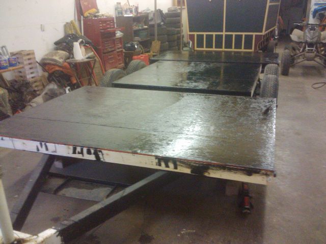

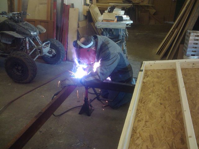

Image Not having a formal plan more tie dows needed to be welded to the frame

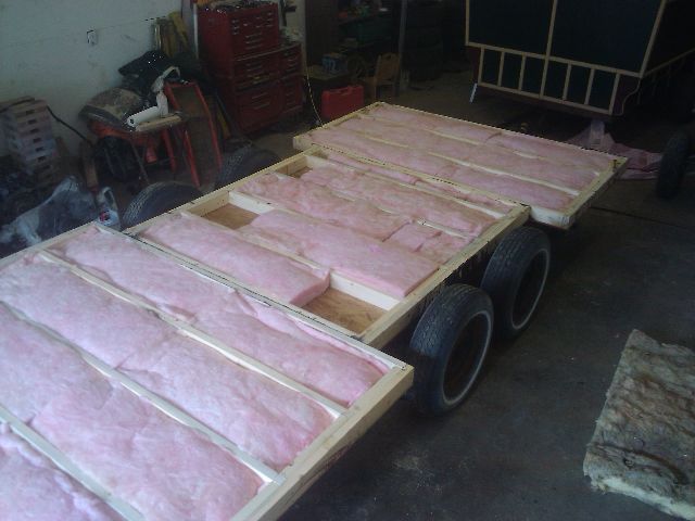

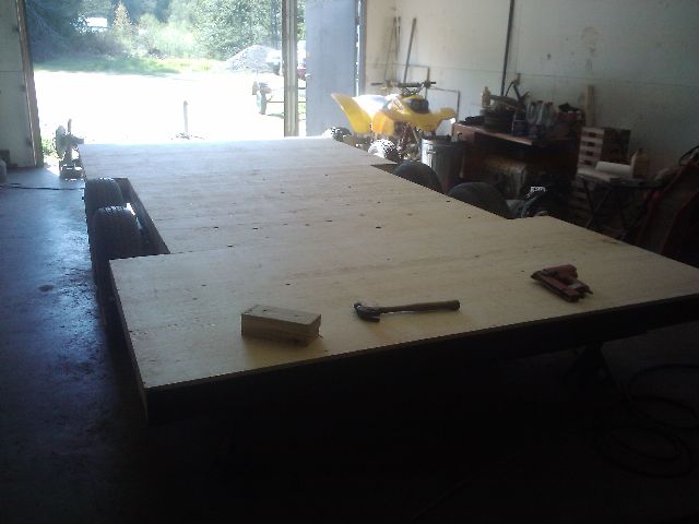

After the holddowns were welded the floor sections were turned over ,joined to each other making one piece and bolted with 3/8 carrige bolts to the frame. insulation was installed and a 5/8 sub floor attached. Where joining is required screws ,glue, staples,and nails are used as required glue always except end grain joints. Sandy

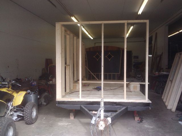

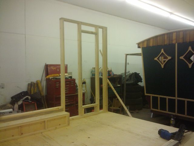

To clear up somethings, being on the downward side of the hill and the very size of this build I am having help with it along with making smaller framing sections. this also increases the number of studs making the building a little over built. Pictures to follow.

halfway on framing
