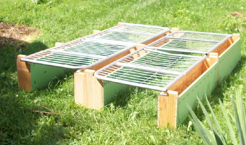

I decided while they were out , to set them up so you could see what I have been trying to explain. In the picture you see a wire and tube futon frame supported on wood stands. The left one in the picture is just over 6 foot long and stays at the wall whether in the sofa or the bed position. The center and right pieces are just over 3 feet long to make them easy to manuver in the trailer. To make the sofa I simply flop the center supports on their sides and scoot them in. The left frame is flipped up and rest on the barn wall the righ supports move in and the right frame rest on the 2 sections shown on the right.

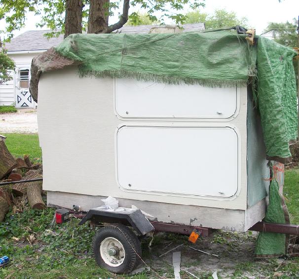

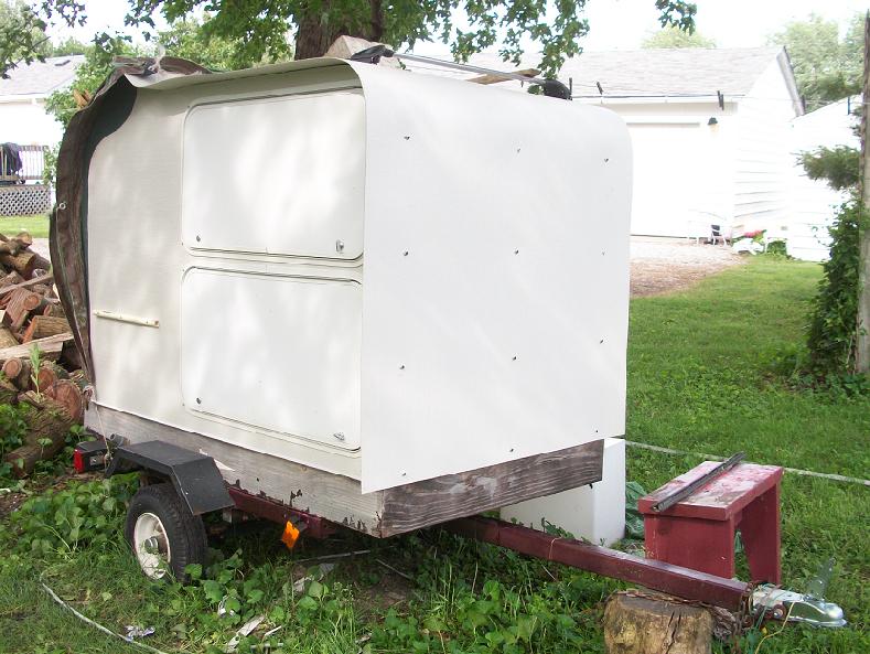

Well it's spring. Spent the weekend giving the Wishbone wagon his final sideing. Got 10 sheets of 4x9 FRP pebble grain finished panels off of craigs list for 125 dollars. So the chuckwagon is getting his new look.
as soom as I figure out the hatch and side trim it will go on the roof as well!
Image before
Image now

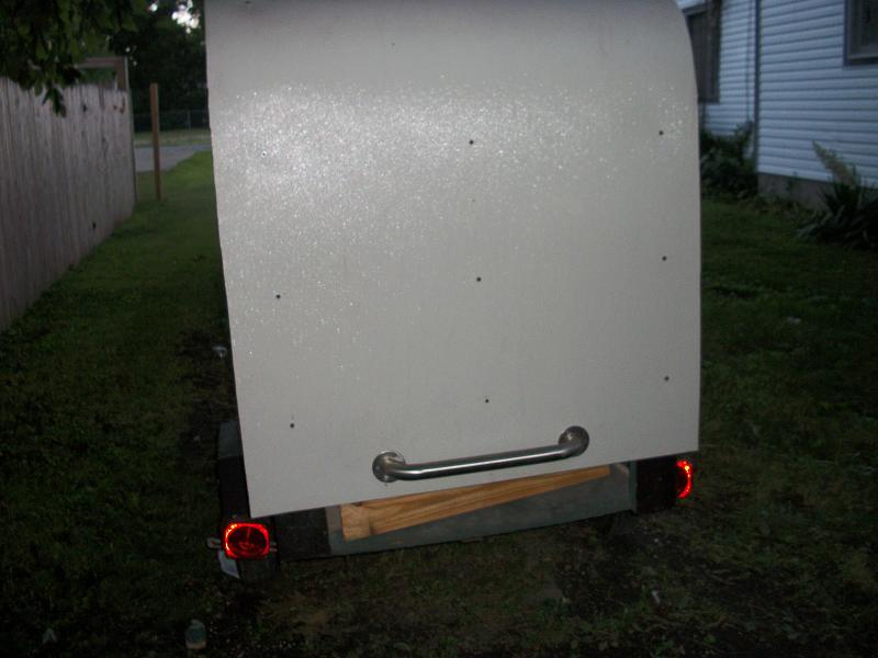

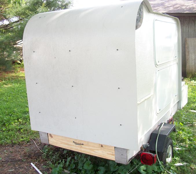

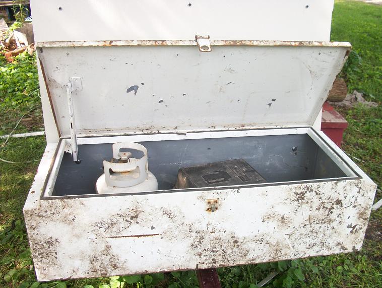

Postby bobhenry » Mon Jun 06, 2011 7:44 am
Well another busy week end.....

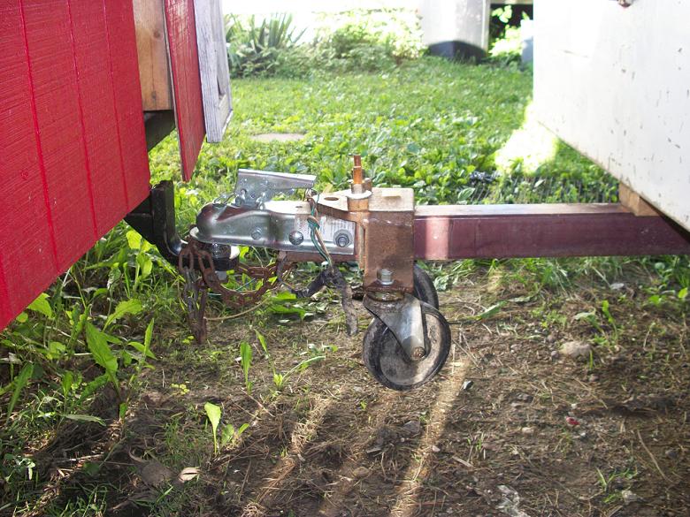

Measure twice cut ( or drill) once. Yep you guessed it about 1/2 a hole too low hit the floor dead in the side.
Well at least my ferris wheel self leveling shelf worked 1st time !
Is my tongue box too wide .....??

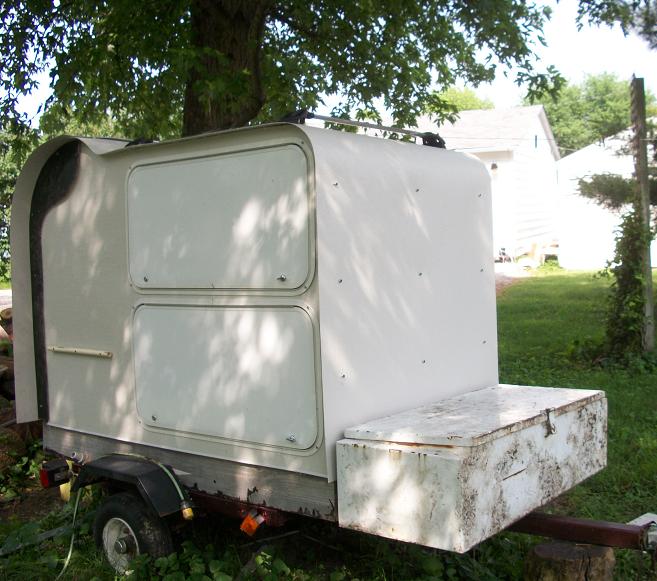

Oh well it out of the yard now !
here is a rear view of the door i cobbled together for my under floor storage locker
Here is a right front and side view....
Recycled a couple pieces of left over lexan from Chubby and the tongue box is supported by 2x2 angle cut from the removed side rails from the barn build. Still just using what junk is laying around ( that's about all I can afford). The tongue box was removed from my ton truck before it went to the cash for clunkers program and is still a muddy mess from laying in the back lot. A little soap and water and a little rattle can paint and it will be fine. A hatch hinge cover a gas line for the stove and trim to width the FRP on the hatch and we are real close to being ready for the Cross roads of America gathering in July. It will be pulled in tandum with the barn this coming weekend rain or shine to see how it all pulls together. Yes, we will have some pictures !

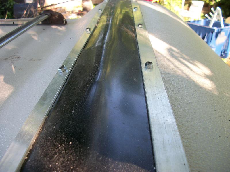

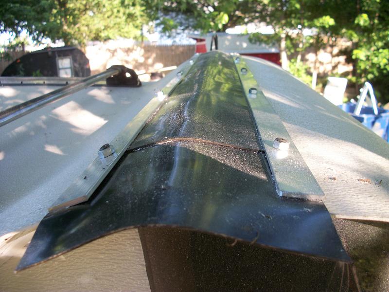

Was ambitious last night so I trimmed the excess material at the hinge point of the hatch. I used some 5" wide ice dam tape over the 2 edge of the 2 sections as my 1st water barrier. I then applied 1/16 " black neopreme rubber cut to six inches wide. I bloused it loosely over the seam and installed 2 sections of 1" by 1/8" aluminum flat stock. This flat
stock had been drilled to simply screw thru and secure the rubber membrane.

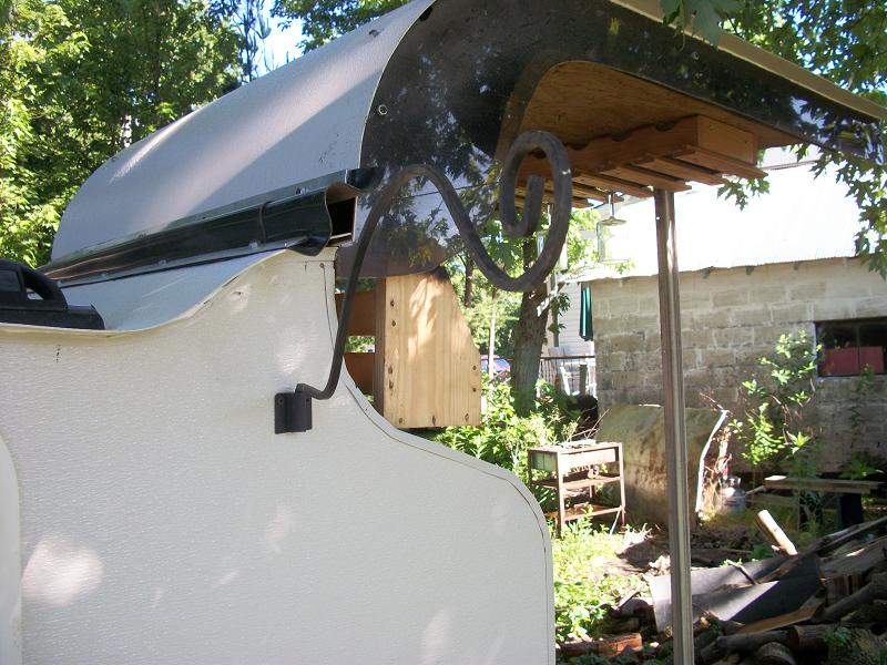

Postby bobhenry » Mon Jun 13, 2011 7:19 am

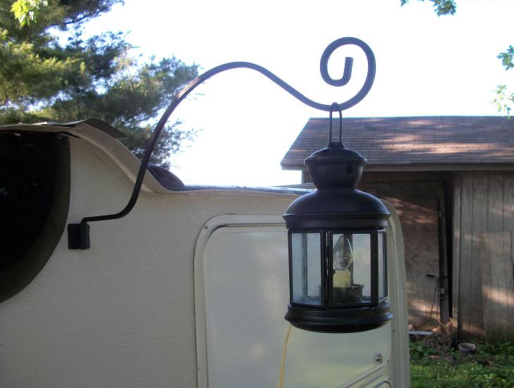

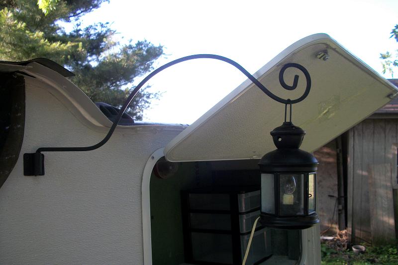

Wife had some porch ledge wire forms that were designed to be slipped over the top rail of a deck or porch and you could hang bird feeders and other types of home decorations. They fell prey to my grinder and I used them for my over the side table lantern holders.
I took a large barrel bolt and ground out the little handle and slid the bolt portion out of the barrell and then cut off the two ends slid the now lantern hooks into the mounted barrel bolt half and wound up with this....
Turned out as a happy accident if you swing the hooks forward they will also support the upper compartment lids.

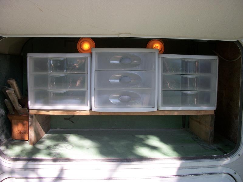

Thanks Mike got a few more things done this weekend.......

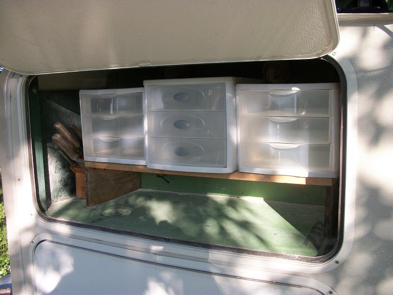

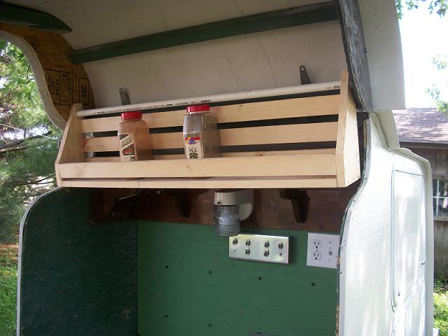

Storage drawers for all those little things that tend to get misplaced.
The use for the storage underneath has not been determined but it scream skillets to me !

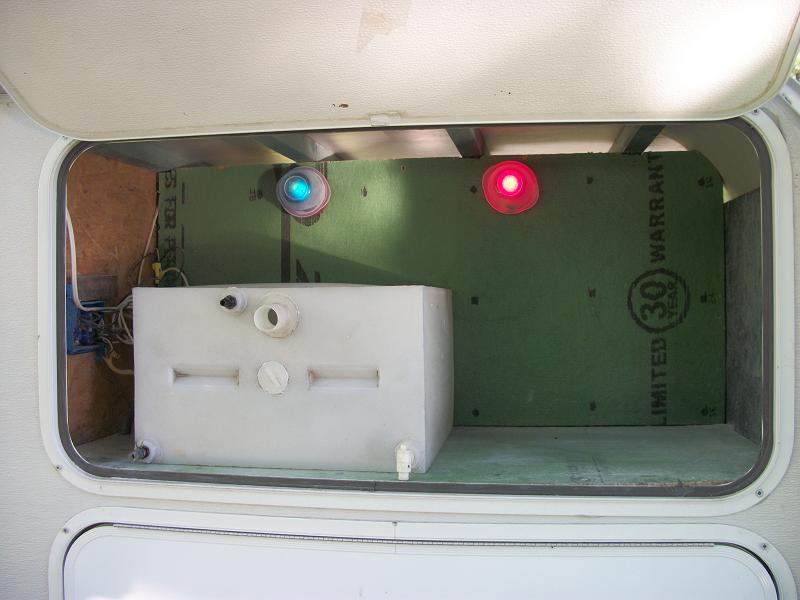

water tank is next weekends project but I did get it cleaned and bleached out

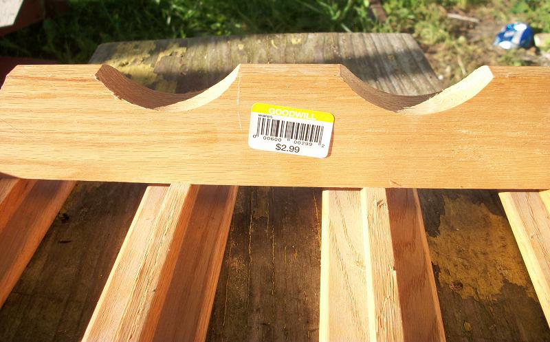

Some Goodwill finds did make it onto the underside of the hatch

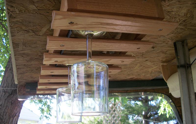

my wine rack for stemware ( No she won't drink wine form paper or plastic)

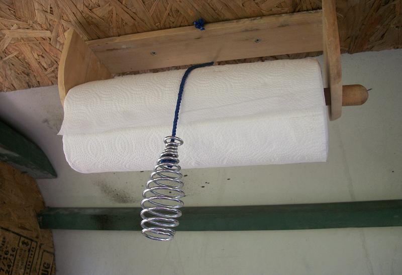

even the paper towel holder found a place on the "ceiling"

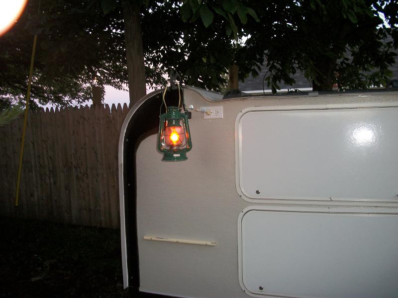

Postby bobhenry » Tue Jun 14, 2011 6:19 am
Thanks Slow......I was busy again last night !
I picked up 2 duplex plugins 2 covers and 2 half depth carlon electrical boxs at lunch yesterday.
When I got home I cut them in right beside the little barrel bolt hook mount and wired them up. The p/s works d/s does not looks like I get to trace back some wires and find what I screwed up ! :x
Still gotta get the gas line ran...... :oops:
