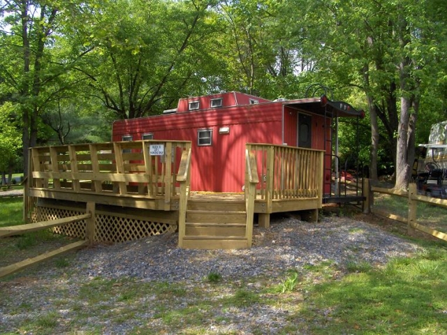

I'd really like to have it titled as a Semaphore Caboose and not as a home-built if at all possible.
By all means keep it as original as possible right down to the title. With only 800 and some built this is a true collectors item and worth every little effort.
Here is a little motivation.......

Yep, I've been motivated by that one. Did you see what that one sold for? :shock: I can afford to sink quite a bit into mine and still come out ok. That's one of the few pics I've found online. The other Semaphores that I'm aware of are the one at Hicksville RV Resort in CA, one that was for sale a couple years ago in west Texas, one in SC, one that I've seen a photo of but no contact info or comment about where it was. Surely there must be a few more somewhere, but I haven't been able to find any info on them if they are.
In my searching for photos, I've also looked at actual RR cabooses. The Pennsylvania RR cabooses made in the late 20"s/early 30's seem to be the closest style to the Semaphore with their low slant-sided cupolas. Some of them had round windows, which I really love the look of but probably won't do on my rebuild.
