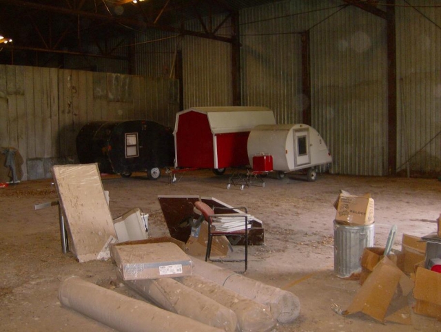

It started in may when I needed a place for my toys and tools and a destination for my furniture and personal items if my home short sold quickly.
I rented a 50 x 60 pole barn with 14 foot ceilings. It was a steal at $200.00 a month.

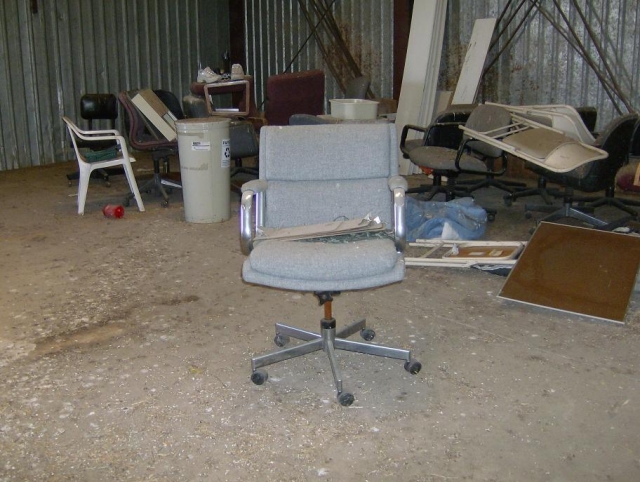

I was offered a one time $100.00 rent reduction if I were to clean out the junk left by the previous renter.
I chose to keep the junk and recycle it and or utilize these items or clean up and sell what was worth selling.
To date I have sold 3 nice steelcase office chairs at $20.. each and have 17 still to go. My dutch oven training seminar was presented using a nice fold up easel and white board I found in the "trash". Steel shelving that was left abandoned has been reassembled and will be utilized in my shop. Hundreds of ( yes hundreds no exaggeration) furniture casters will be used to make the shop space more universal and stowable when not in use.
I finally have inside storage for my toy trailers as well

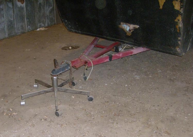

A few of the broken office chairs afforded me a new and unique style of trailer tongue stand
Chubby is 1850 pounds and rolls effortlessly on this stand.

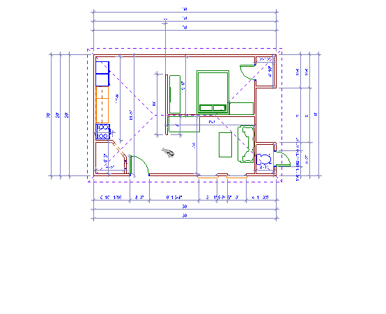

The house plan ........

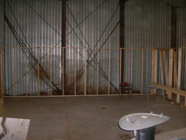

although listed as 20 x 30 you see a 4 x 9 insert between the porta potty "outhouse" my shop workbench will nestle there close to the electricity. Adding the bedroom closet makes the main house with closet 536 sq ft exterior to exterior of walls. Deducting the thickness of the walls you bring the inside square footage to right at 500 sq ft. This plan shows a main door and 2 windows in the front wall. As you enter and look right you see the living room with couch and coffee table. almost straight ahead is a large antique oak desk. As you look left you see a clipped cornered closet this will be the pantry or possibly later a gravity feed shower room. The stove freezer and fridge as well as counter space is on the left wall. As you progress around the tee shaped wall it is obviously the sleeping area. Furnished with dresser and mirror, the bed, and a highboy chest. The small closet is accessable by the bedroom area only.

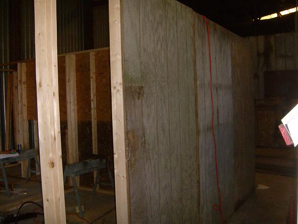

The walls are 8' and framed at 24" o/c since no real roof or snow load will ever be seen by it. It will have a flat roof with some storage utilized up there. It may also see a 55 gallon water tank for the gravity feed water system.

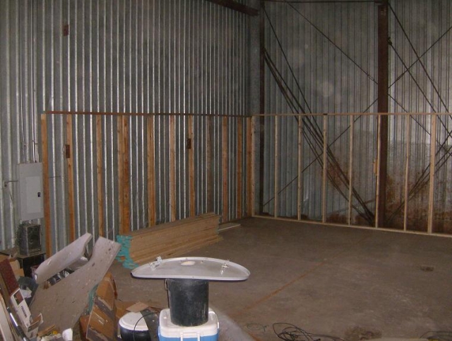

Framing has started... the kitchen wall
the back wall of the kitchen and sleeping area
and the right wall......

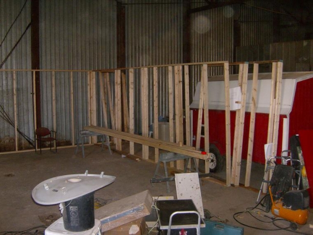

This pic is a little goofy as you look at it because there are unplaced walls leaning against the barn camper
you are seeing thru the stud bays.

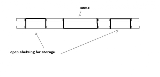

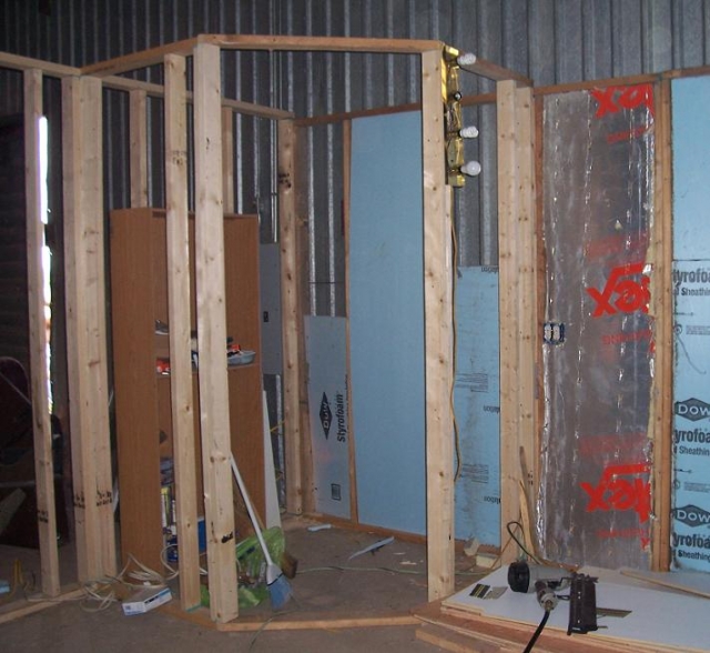

The center wall has been redesigned to have double walls making a 10 1/4 inch deep neich for shelving. Two bays in the living room will be open for a center located floor to ceiling shelving unit for 46+ wide shelves. A similar bay will be in the bedroom right and left of the bed for storage as well. I figured the 75 cubic feet plus of storage was worth the 7 sq feet of floor it cost. In fact I just might do the same on the short tee wall in the kitchen area above counter height for pantry storage if the clipped wall closet DOES become the shower area.
A beam will continue beyond the longer center wall to the kitchen wall and it will help to carry the ceiling joists allowing them to be 2x6's rather than 2x10's or 2x12's since we are spanning 9'+ rather than 19' 4".
The exterior walls that can be seen in the building will be the T- 111 tongue and groove siding I re-clained from my large mini barn in the yard at the house ( The framing lumber is in the walls too). These "Exterior" walls will be stuffed with 3/4 or 1" blue foam ripped to fit in each stud cavity 3 1/2" deep. The plywood and foam are waste trash from work. ( I love free)
The kitchen wall behind the cabinets will be the osb reclaimed roof decking from my yard barn. This will give a good substructure for hanging the cabinets. Many of the interior walls will be clad using waste 1/2 plywood applied to look like drop siding.

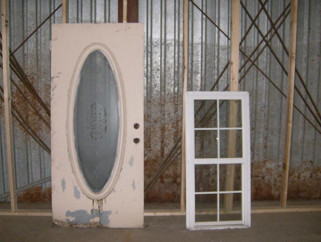

I have a beautiful 36" oval glass insulated exterior door I got by stopping and asking for the donation. The homeowner even loaded it for me. It will grace the front with 2 double hung vinyl windows salvaged from the mini barn. The blessing is that I have managed to gather most of the building needs long ago and will make this build extremely cheap.

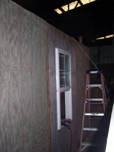

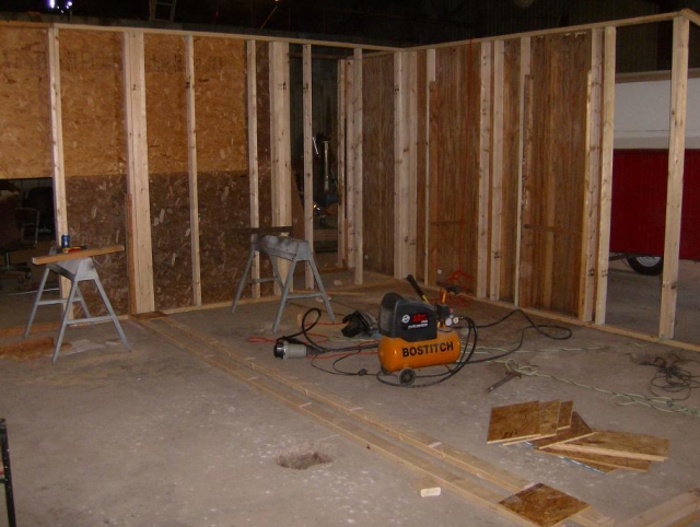

Well I guess this is a tuesday update of Mondays work.

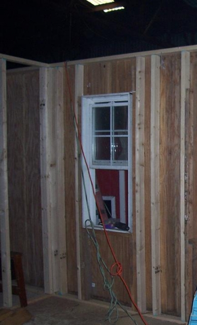

The front wall with some of the reclaimed T-111 installed ( window openings are yet to be cut out)
an interior shot showing the osb wall on the left that will be behind my workbench
outside in the shop. The inside of the T-111 on the front wall (right)
and the plates for the yet to be built double center wall that will house the neich
type recesses for shelving
here is the free door and one of the two reclaimed vinyl windows.
Yep the door needs a little lovin but it will clean up well with a little caulk and paint.

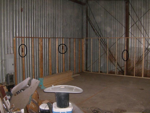

Postby bobhenry » Mon Oct 07, 2013 6:53 am

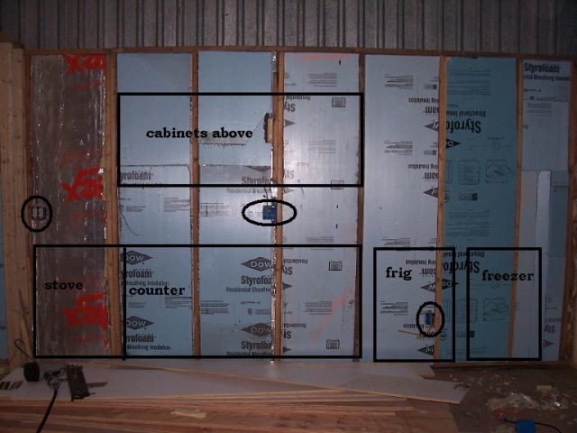

Well here are some pics of the pantry, electrical, insulated kitchen wall that is now wired and hot, My window installed seen from inside and out.
What you don't see is all of yesterdays work
Some dummy forgot to take more pics. :x
The tee wall that runs from front to back is in and the beam that runs from there to the right side (kitchen) wall is installed. I will be able to start installing the roof joist this evening after work.

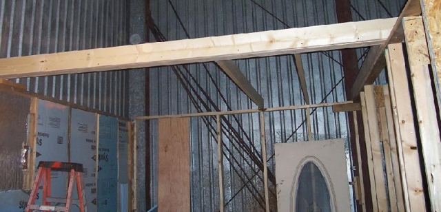

Re: HOUSE IN A HOUSE
Postby bobhenry » Tue Oct 08, 2013 7:03 am
This center tee wall is a pain in the butt !
As the walls were free standing, until I got a center box beam and a couple of ceiling/floor joist in, it was tough to get things set plumb, square, and centered. I worked 2 hours yesterday. I installed the in floor box beam. After getting it in I installed a "U" shaped wall lead directly under it to carry the upper floor load as the "roof" will be used for storage. Getting the beam in and centered and the walls under it plumb was a real effort but as you can see its in. I was also able to get 3 of the joist in. I hope to get some plywood down on the floor above before the weekend.
Hey Mezmo : Notice the joists are aligned with the wall studs just like you were talking about. This eliminates the need for a double top plate and telegraphs the load directly down to the concrete slab.

The 4 tee walls better explained......
I chose to make a double wall as a storage wall for both of the interior tee walls. They will add strength , storage , and a bit of sound proofing as well. The living room wall is shown ( a bit out of scale) The cavity is 10 1/4 inches deep and is centered on the living room wall and at either side of the bed in the bedroom side. The kitchen wall will have 3 such cavities also.
A shallow pantry a spice cabinet and a hidden neich for show and tell items as decoration behind a let down wall mounted table.

I like the "thick wall" idea with alternating open shelving on each side. And
since you haven't mentioned it either way, let me suggest that the areas you
show between the shelves be used as 'shallow' cupboards/cabinets, using
those push catches for knob-less/pull-less doors on them, which would thus
look like wall panelling. The doors could be full wall height or divided on
them, as you like. Why waste that volume between the shelves? I'm just
a big advocate of built-in storage, so I thought I'd throw that idea out there.
It'd be hard to make a better use of the structure and its volume than combining
it with both shelving and 'hidden cupboards'.
