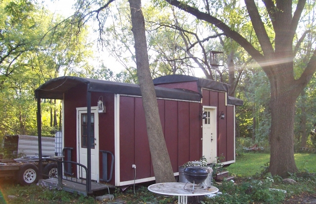

If you were to move up to 7/16 for your outside sheathing I would suggest you look into the zip panel products. The fiberglass face protects the exterior and holds paint very well. It has held up well for me on the caboose. I glued and screwed on the zip panels and sealed the gaps with 100% silicone then capped the joints with the batten boards attached with finish nails. I also faked in one at 24" between the 4' seams for the board and batten look.

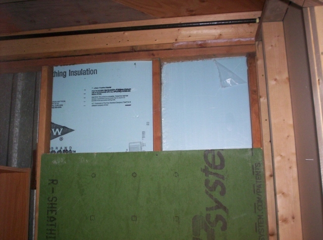

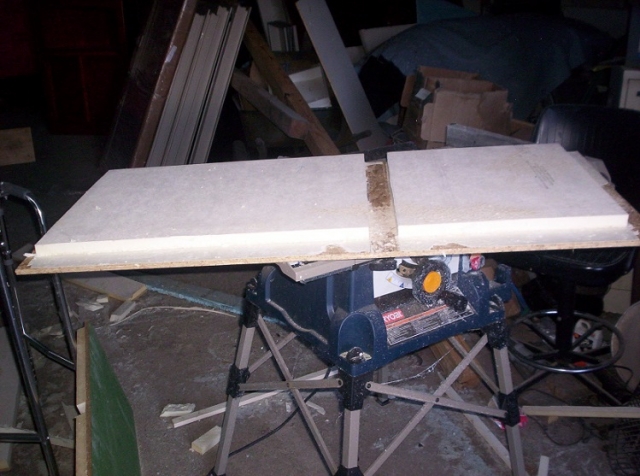

It does also come with the insulating foam already glued to it. Here it is with the insulation. I installed it in the house in a house by simply plowing out the foam where the stud would go. It was a little bit of work but I found the extra insulation worth it. I wish I had known it was available when I built the caboose as the panels for it DID NOT have the insulation and were just uninsulated panels.
Here it is going in the pantry.......
It was going to receive shelving and some rough service so I opted for the fiberglass face for durability in lieu of drywall.
