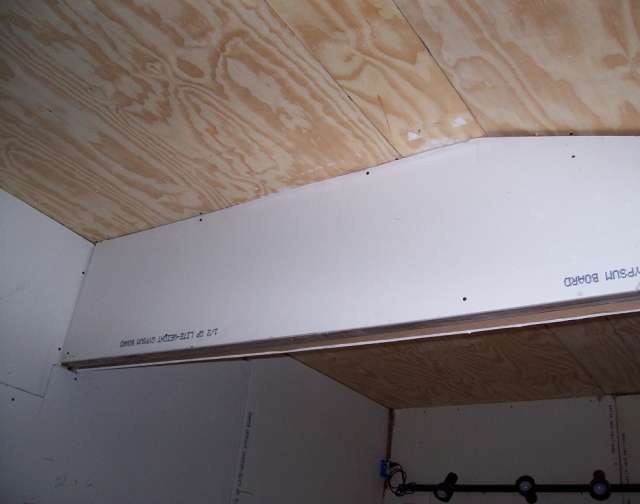

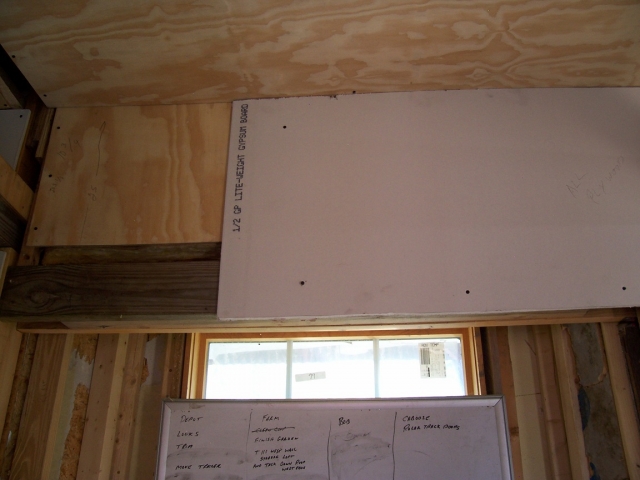

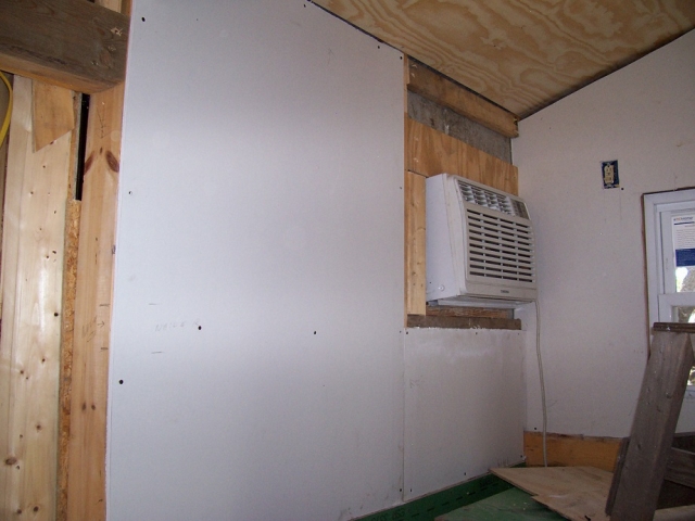

Drywall, Drywall, Drywall. Up and down , up and down. There is a light at the end of the tunnel. It is all most done. However these pooch outs were and remain a pain in the butt.
I decided that if I wanted some meat behind the drywall to inset plywood with nailers set back enough to allow for the extra thickness. The cavities were filled with paper backed roll insulation before they were closed up.
Here is a shot of the reinforced surface...Image

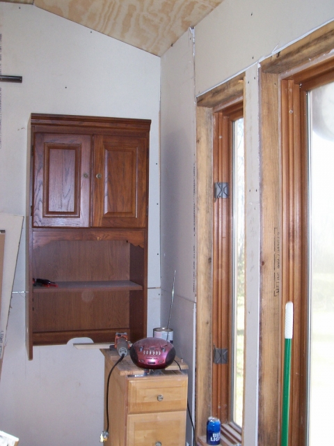

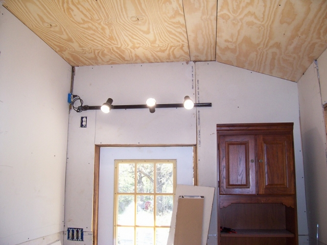

Some other boring shots of drywall .....
My $10 yard sale cabinet hung on the wall to get it out of the way.
This is the wall I hope the prints will all fit on!
A few small patches yet to be finished around the AC unit
The twin windows ready for trim as soon as painting is finished.

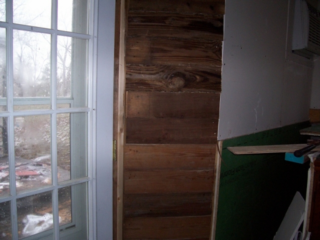

Well it was above 50 and a great day to work so I put in 3 hours and got the 45 degree walls at the side door all sheathed with the car siding. I applied it horizontally and left the flat face of the back side of the vee groove 1909 car siding exposed. This is the unfinished side of the 100 year old wood and looks so sweet. I promise I will get the camera out tomorrow and get a few pictures. I installed some squirrel blocking fillers above the end gables. They are starting to try and move in and I don't need squatters in the attic. Going to get my help Saturday morning and we will get the facia completed and the rest of the critter blocking installed weather permitting. If it rains we will move inside and work on drywall finish and the troughs for the indirect lighting. :pictures:
Update: Here is the car siding installed.....Image
Still needs trimmed out but I loved the look !

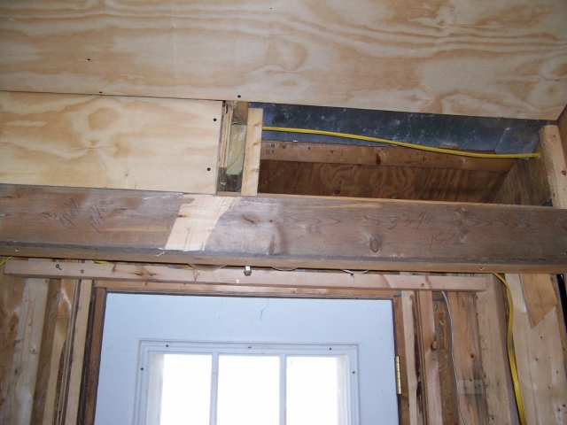

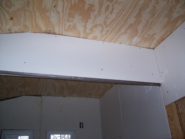

The last of the drywall is installed. I left two trusses fully intact and they needed to be faced both sides. I had to install all kinds of fillers and nailers to get everything to plane out so it was a mess. It is raining snowing and sleeting this morning (Mon.) and the wind is about 40 MPH. My right knee is as big as my head. I stumbled yesterday on a loose step and caught myself mid fall with my right leg. I am starting to wish I had just fell.. I am determined to get some pictures taken today and am still in hopes of getting the light troughs installed.
(Maybe :oops: )
The plywood ceiling is now fully installed but some dumb butt forgot to reroute the can light wiring. I am in hopes I do not have to remove any of the ceiling as it is now trapped under the drywall edges. If I find someone with long skinny arms we might retrieve it thru the holes for the can light install. I so hate when the inner sheathing is all installed it is so damn final. Any electrical or plumbing ideas are in the past unless you are ready to destroy and replace the inner sheathing. Well back to the grind tomorrow for 3 whole days. Then another 4 day weekend to piddle with the depot ! :D
Update: Left and right trusses faced out ready for trim. Image

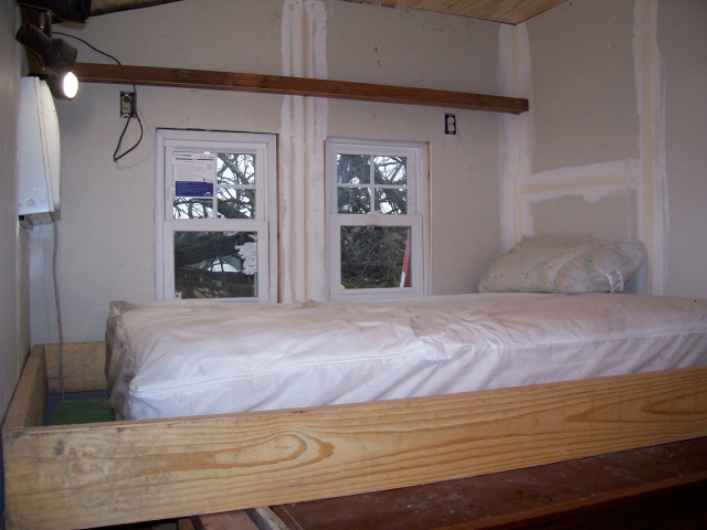

A demolition site roll off netted 15 pieces of EMT tubing with a dozen or so outlet quad boxed with outlets and switches. It also had about five 10-12 foot length of pvc from 1 1/4 to 3 inch in diameter.
Along the road side a patio chair and a nice wood 1/2 lite door
and in a new dumpster was a very nice Sealy Posterpedic full mattress still in the zip on cover.
The mattress fits perfectly on the sleeping shelf in the depot.
