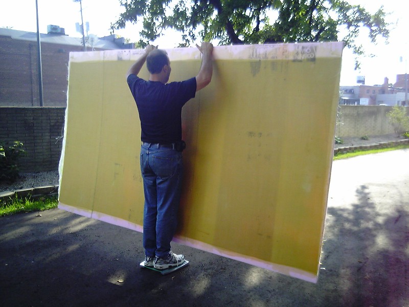

Here is A picture of my new roof panel being weighed. It is 5FT x 9.5FT and weighs in at only 19.4 LBS. I've done some simple destructive tests, and sample peices react similarly to 1/2" plywood (CD).
I figured that if the roof was made perfectly flat, it would eventually sag a little in the middle. Structurally, this was O.K. but aesthetically this wouldn't work. I decided to form the roof with just A little bit of A bow in it.
I started by cutting three pieces of tongue and groove foam panels about 4" oversized. (2 beers) I epoxied the panels together using 5 minute quickset epoxy.(1 beer)
This new 5 1/2 x 9 1/2 Ft foam panel was layed on the floor with A 2x4 underneath it in the center running lengthwise. A 2x4 layed on top of it on each edge assured that it would bow down 1 1/2 inches on each edge. (1 beer)
I layed fiberglass cloth on top of it and wetted it out with epoxy.(4 beers & lots of epoxy fumes)
The panel needed to be cut oversized to insure that There was enough room for the edge 2x4s to rest on it without getting in my way while wetting out the fiberglass. It worked perfectly. The roof panel wasn't stuck to the 2x4s or the carpet.(I accidentally did glue the trailer frame to the carpet once last year & it took a couple of hours to remove)

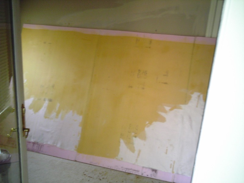

The next day, I leaned the panel up against the wall and epoxied 2 layers of fiberglass cloth to it.(6 beers)
here is A picture of the half wetted out roof panel on the second day

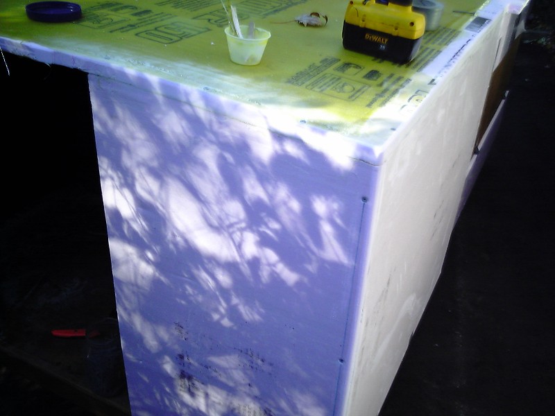

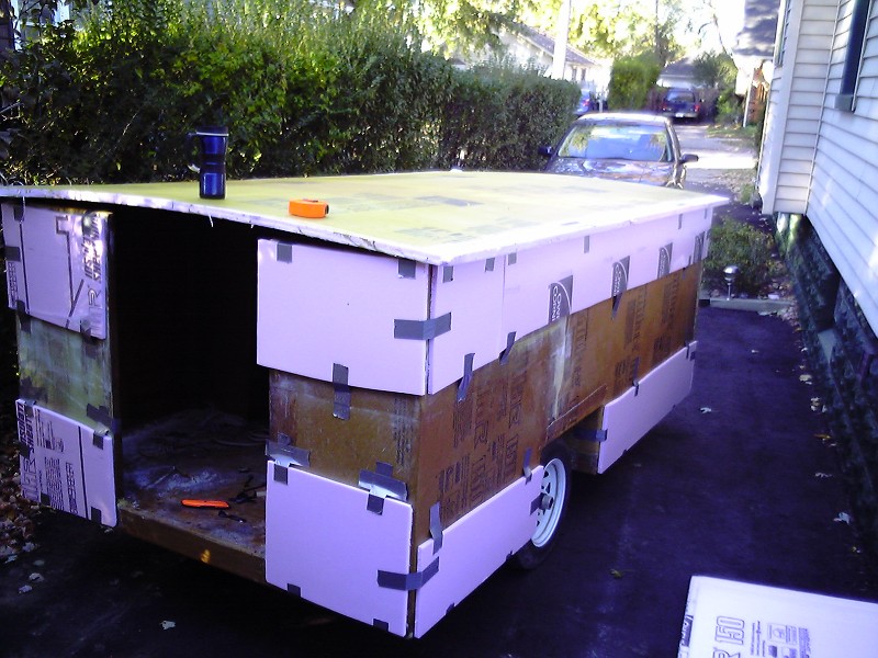

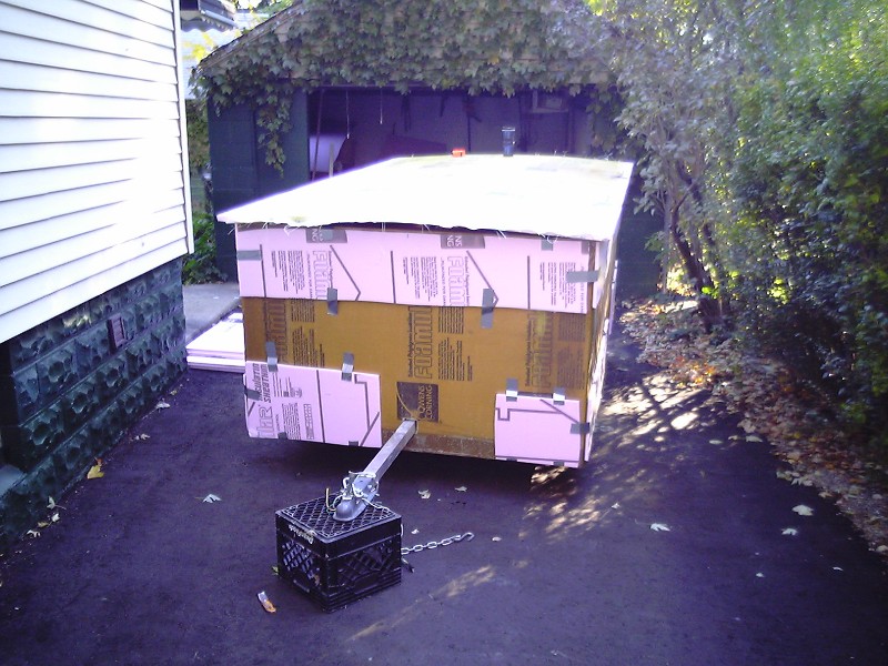

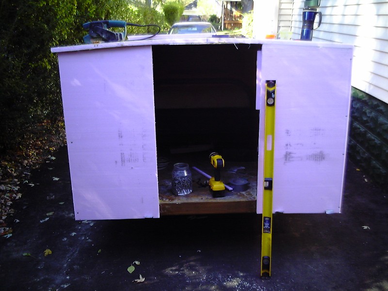

Now that the lower half of the camper is done (except for the tongue), i,ve started assembling the cap.
I duct taped pieces of 1/2" foam around the outside of the camper to act as spacers, and allow me to use the bottom half as a form for the top half.
http://tnttt.com/album_ ... c_id=28884
I centered the roof on top of the camper and hung the foam walls of the cap using 3" deck screws. then I sanded all of the foam overlap down and rounded off the corners with a belt sander.
The screws are used primarily for dry fitting the foam sheets and clamping them together while A slurry of epoxy and glass balloons that is slathered between the sheets hardens and gived everything rigidity.
Most of the screws are removed after the slurry of "wet micro" hardens.
You can see where the roof panel on the left overhangs the wall before the sanding, and the roof and wall panel on the right are smoothed and rounded over, and ready for 'glassing.
The fact that my doorframe looks trapezoidal is just an artifact of the camera angle. the door itself will be a regular rectangular door.
