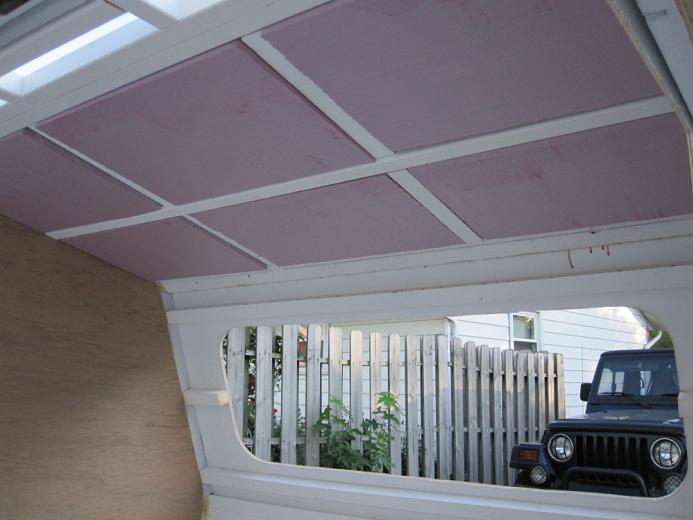

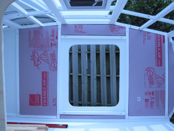

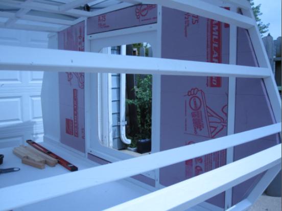

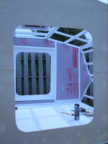

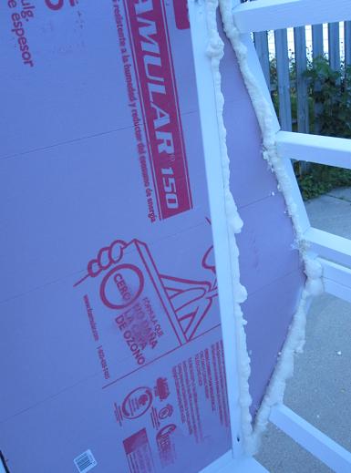

Postby MKE_Tear » Tue Aug 17, 2010 10:07 pm
Well, the weather finally broke here (we've had the a/c on for nearly two months, unusually humid conditions), so I took the day off and installed the insulation. With pink dust everywhere, here are the end results:
Still figuring out what to do around the doors.

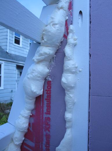

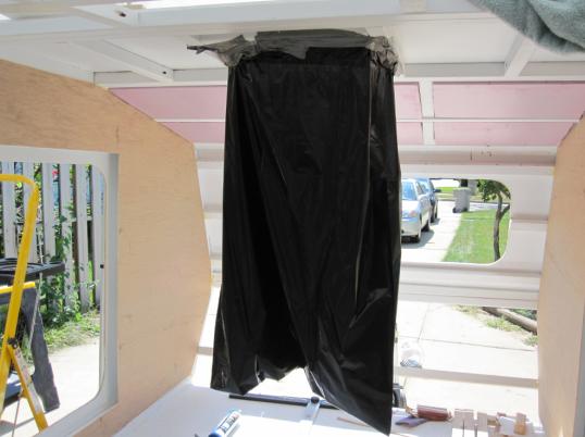

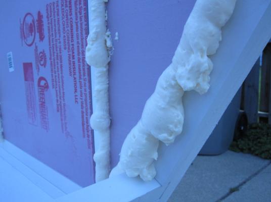

Postby MKE_Tear » Wed Aug 18, 2010 8:54 am

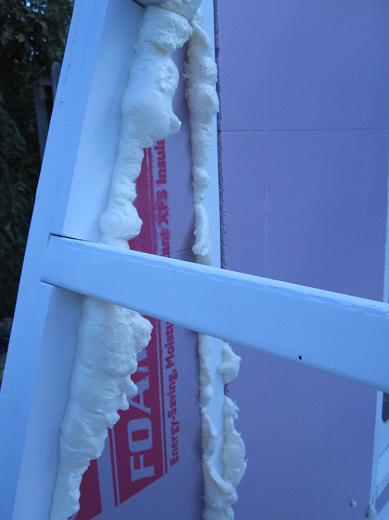

I filled in the gaps (where I cut the insulation too small) with that "foam in a can" stuff. Here are the "blisters" I woke up to this a.m.
Make sure you follow the directions: WEAR GLOVES. It will be a nightmare (GUARANTEED!!!). Fortunately, I was at a natural ending point for the day.

Postby absolutsnwbrdr » Fri Aug 20, 2010 12:02 pm
haha looks like the same result I got when I used that stuff to seal up a gap in the front of my trailer. Works well though! Just had to shave the excess off, and I was good to go!

Postby MKE_Tear » Fri Aug 20, 2010 5:33 pm
absolutsnwbrdr wrote:haha looks like the same result I got when I used that stuff to seal up a gap in the front of my trailer. Works well though! Just had to shave the excess off, and I was good to go!
You got that right -- the stuff works great!!

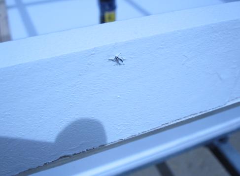

I forgot to mention that when using the power sprayer, my first one gave up the ghost on Sunday at 5:30 p.m. Fortunately, the box store was open and I was able to get another. Here was the first casualty of war. Mosquitoes have been HORRIBLE this summer:

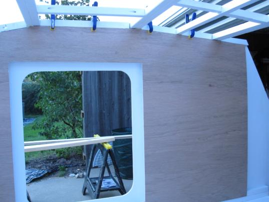

Postby MKE_Tear » Sat Aug 21, 2010 9:22 pm
Today one of the inside walls went up...
The "finish carpentry" will come later.

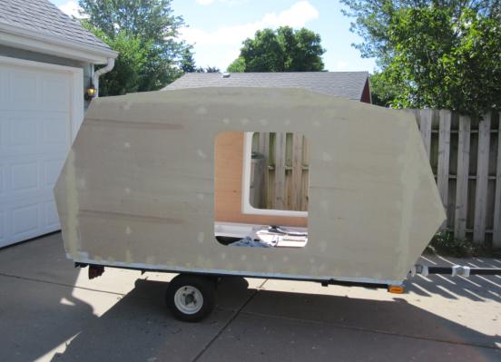

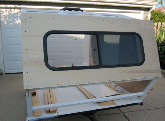

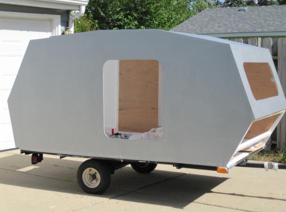

skinning

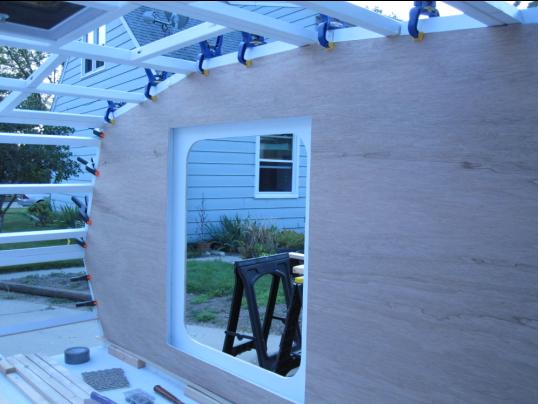

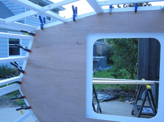

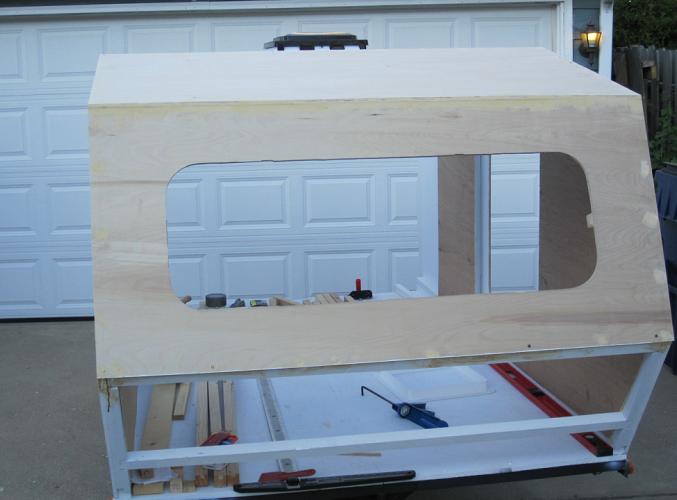

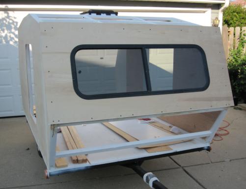

Postby MKE_Tear » Mon Aug 23, 2010 9:00 pm

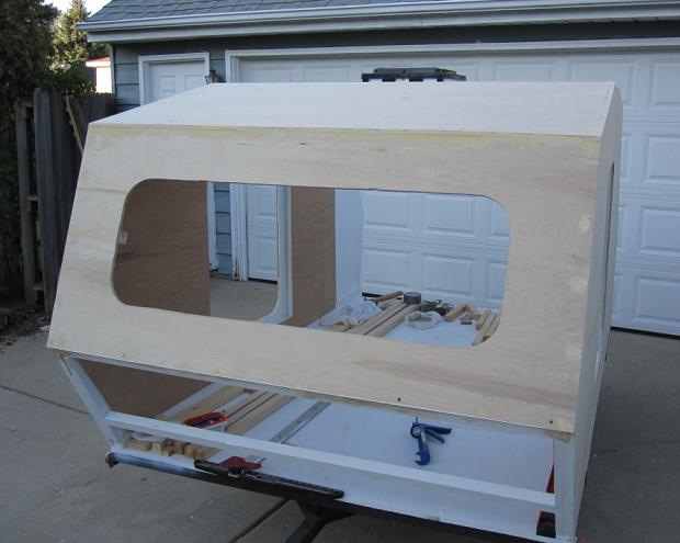

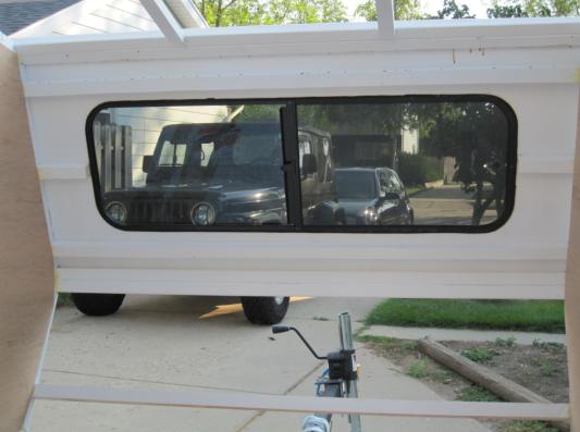

I got the other inside wall up and started the skinning project...
I then cut the front window hole, and, of course, had to test the window. :D This is where I got a little trigger happy with the camera. But in a word: Wow! I'm so happy with the progress.
Next up: the trimming bit to take off that extra inch or so width on either side.

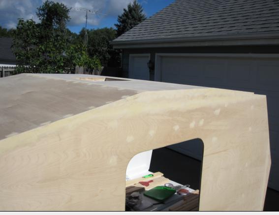

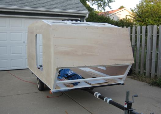

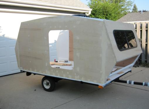

Postby MKE_Tear » Thu Aug 26, 2010 6:47 pm
The flush cutting bit worked very well:
I've done next to nothing with a router (before this project) and yet I have been very pleased with my results (from stretching the plywood to trimming the sheeting).
I identified additional progress in that I had to dump my 8 gallon shop vac. I've already filled it with sawdust. When using the flush cutting bit it seemed like I was not just making it snow but that I was in the middle of a blizzard.
I read somewhere that someone said it is more difficult to make a trailer/camper with angles (like the Grasshopper style) than the more typical teardrop design which requires bending the plywood. Well, I'm starting to think there is some serious truth to that statement.
For skinning MY grasshopper, it appears that each section (or angle) takes one full day: measuring the size of the plywood, cutting it, getting the angle(s) right so it matches up with the previous sheet and then the next sheet, priming the inside (min. 2 coats) and letting it dry, glueing/screwing, using the flush cutting bit on the overhang, wood filler on the the now "flushly cut" areas, and lastly, measure, cut & glue the insulation. And it could be even longer if you have a window or vent hole to cut out.
(Now I realize I could deal with the insulation later, doing the entire inside at once (like an efficient assembly line), instead of setting up the sawhorses and laying out the insulation each time (but that's only a five minute deal) but I like knowing that all I have remaining to do is skin/sandwich board the inside.)
So, now that I've got my second (skinning/sheeting) section done...
...it looks like it will take me two more days to do the two remaining roof sections. I can't wait to get done bec. I want to get to sealing it up with the aluthane. I've decided to seal it (the bulk of the camper) before I work on the hatch. Anyways, even before sealing (and after skinning), I have plenty to do: build & insulate the dividing wall, panel the inside, and finish the front. Gotz a lot to do!
My next section should be fun -- I have to cut out the hole for the vent. :thumbsup:

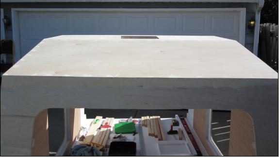

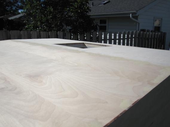

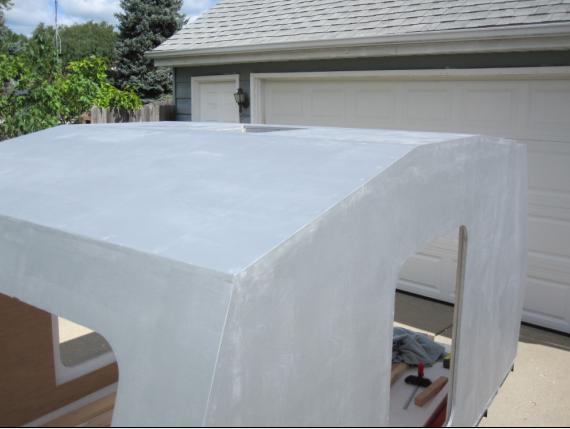

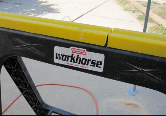

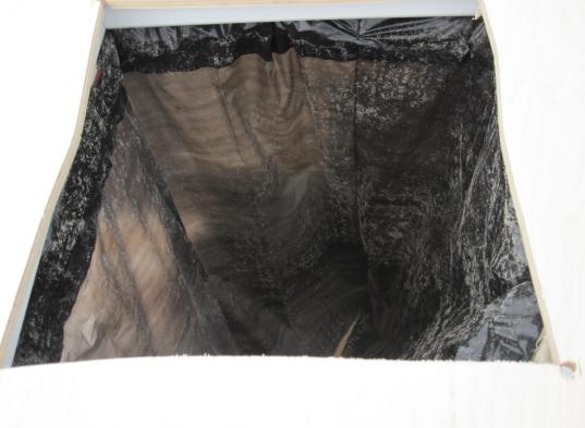

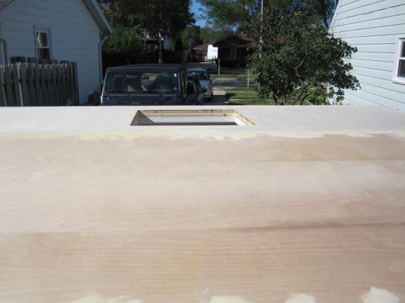

Postby MKE_Tear » Tue Aug 31, 2010 9:51 pm
Well, progress can be seen by the sawhorse I cut through...

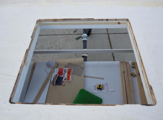

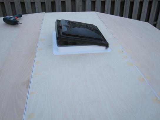

Afterwards, I managed to get the rest of the roof done. Thanks to another teardrop build (The Desert Dawg -- http://www.asolidfoundation.com/ ) I got the idea of how to cut out the vent hole exactly to size with the flush cutting bit. Half-way through I needed to get a new trim bit. I thought they would have gotten more life. Oh well.
Here are the pictures of the construction, at least trying to keep the cleanup to a minimum:
and after the jig saw
and the final product:

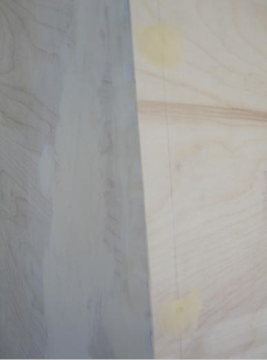

Now, I just need to trim off the overhang (on the last sheet) and fill the gap between the last two sheets (the angles don't always match up perfectly).
I've decided to rearrange the order of what I am going to do next, based on a possibly different interior design with respect to the doors & walls, so next up: fix any other boo boos and get ready to seal it with the aluthane.

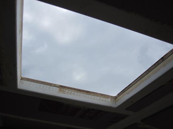

EDIT:

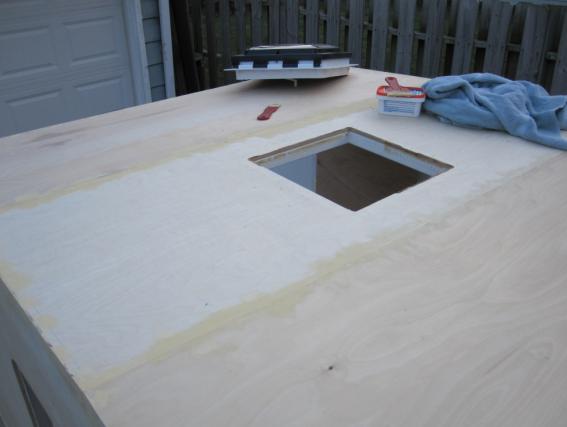

Figure I should show more of the vent photos...
Before I got the second flush cutting bit it got a bit hot and/or I pressed too hard

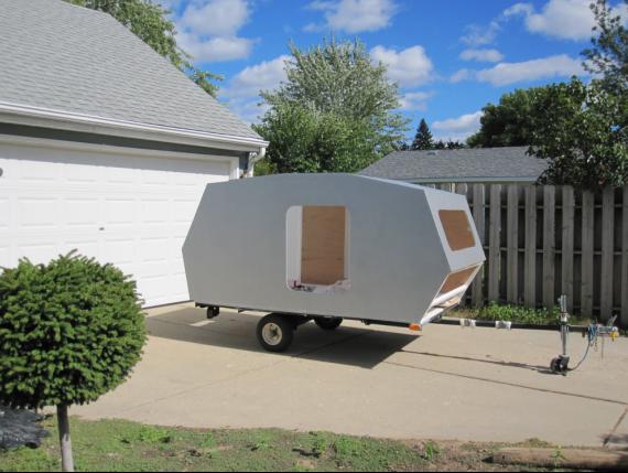

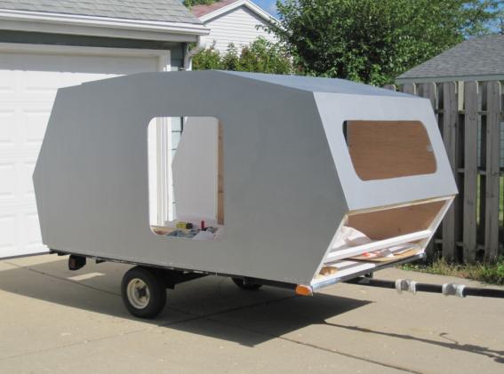

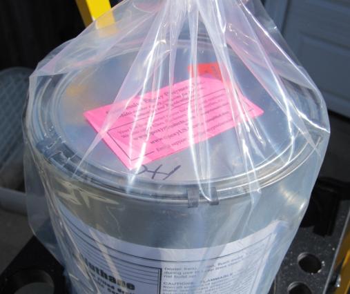

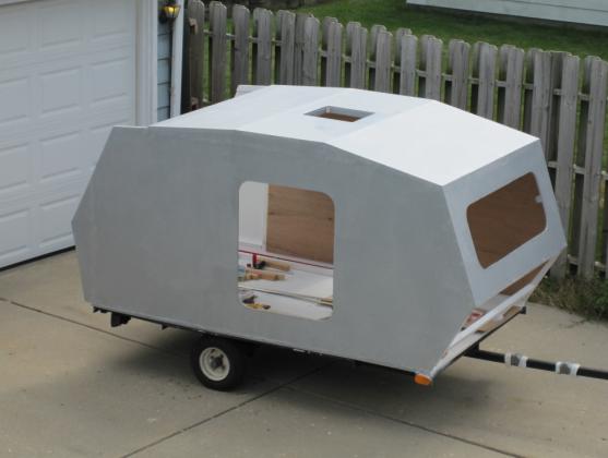

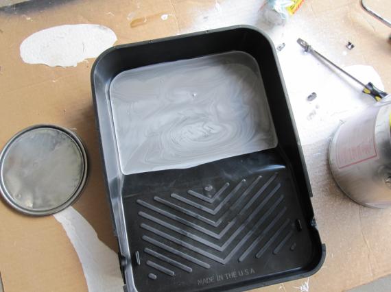

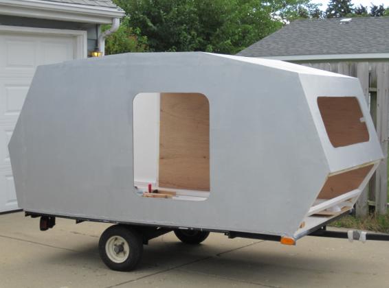

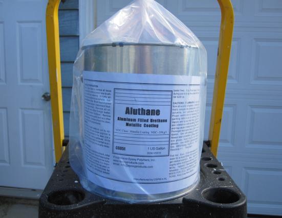

Postby MKE_Tear » Sat Sep 04, 2010 3:56 pm

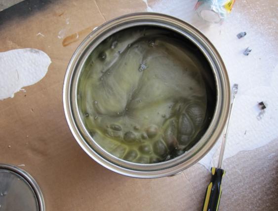

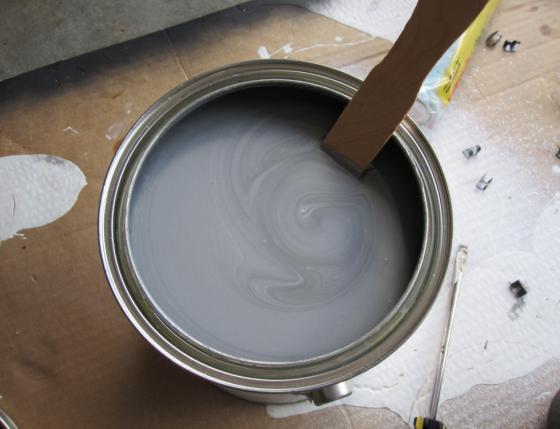

Well, today was Aluthane Day. Here are the last "naked wood" shots:

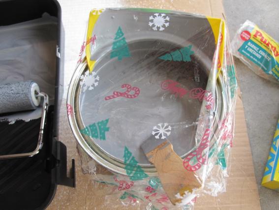

Now, to the aluthane. The stuff came super-packed/wrapped. Inside of a cardboard box, with styrofoam worms, wrapped in a thick plastic bag that was zip-tied shut and clips on the lid.
You'll see it looks pretty nasty unstirred:
And spend the 79 cents to get one of those pouring things for the can. The stuff is extremely runny/oily/liquidy and if it gets into the lip of the top of the can, will permanently seal the lid with the can. Plus it's just easier to pour.
And to keep it from drying out, I used the only thing that works: Holiday Plastic Wrap. :lol:
MKE_Tear

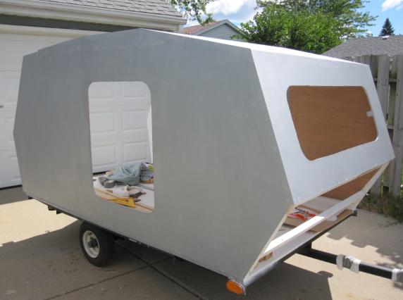

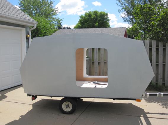

Postby MKE_Tear » Sat Sep 04, 2010 4:08 pm
After the first coat:
MKE_Tear
Posts: 130
Images: 243
Joined: Sat May 08, 2010 6:28 pm
Location: Milwaukee, WI

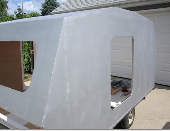

Postby MKE_Tear » Sat Sep 04, 2010 4:15 pm
And three hours later, with the second coat:
MKE_Tear
Posts: 130
Images: 243
