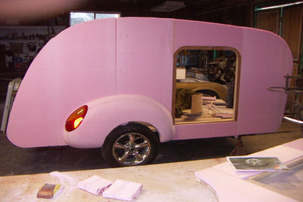

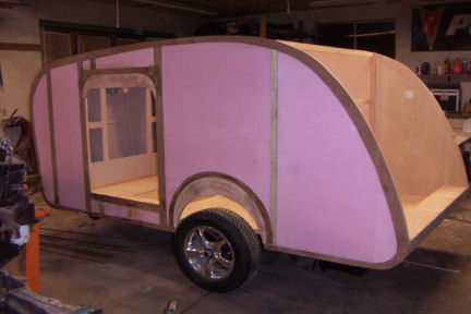

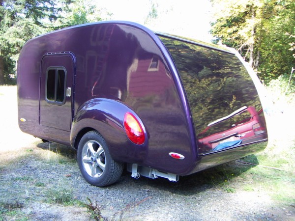

Postby Esteban » Wed Dec 31, 2008 4:33 pm
Gaston built his teardrop with a minimal wood wall frame, pink foam filled in between, and fiberglass over the foam/wood frame. His finished trailer is a beautiful work of art. I enjoyed meeting and chatting with him at IRG this last summer. He said while camping in hot weather in Florida his fiberglass skin separated from the underlying foam. Maybe he can add his two cents to this discussion. Hello Gaston!
All the pictures below are from Gaston's album:
It looks like Gaston has a second layer of foam, that he shaped, on top of the first one.
Fiberglassed.
Gaston's beautiful teardrop trailer.
BTW, I've built wood framed sandwich walls with 1/4" plywood outside that is fiberglassed. So this is a very interesting and informative discussion.

Postby birddog1148 » Wed Dec 31, 2008 4:54 pm
Do you think the delamination would have ocoured if he had used a light colored paint as opposed to the dark color he chose?
