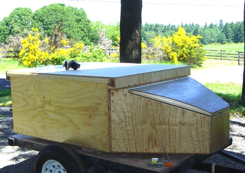

Postby schaney » Thu Apr 30, 2009 8:05 pm
Yes there is more progress ...

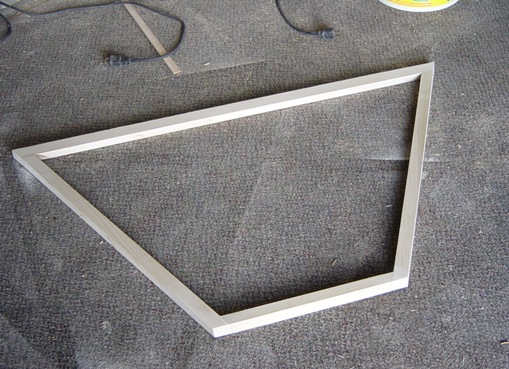

I've been working on the the nose box lid. I started by making a frame that matches the nose box opening. This is fun getting all the angles right, the top of the box slopes down 17 degrees, it angles in 30 degrees on each side and the outside edges get trimmed 8 degrees so they are parallel with the sides. To glue the lid frame up, I used thickened epoxy and taped the frame in place on the nose box.
I wanted some curvature to the lid so I made some curved frames and epoxied them to the top of the lid frame. For a little extra character, the curved frames angle in at 30 degrees.
Then I sized and epoxied the lid panel in place. After the epoxy dried, I rough sanded the edges and test fit the lid.
As the epoxy dried in the above steps, I worked on getting the main box top panel ready to install. Because the top of the trailer box is part of the sleeping platform, I added two cross braces space 16” a part. Being careful not to get any on the gluing surfaces, I sealed the bottom of the top panel and the interior sides of the main box with 4 coats of Target Coatings HybriVar (This has been replaced with their new and improved
EMTECH 2000) a user friendly urethane waterborne borne alkyd varnish.

Postby schaney » Sun May 03, 2009 12:32 pm
Now it’s time to attach the main compartment top panel. As with the other exterior joints, I use thickened epoxy to glue the top in place. Here is the method I use. To ensure good epoxy penetration into the wood, I first coat both sides being joined with straight epoxy.
Then using a combination of Colloidal Silica (West System’s 406) and fine wood dust fillers, I mix a batch of thickened epoxy to the consistence of peanut butter. This allows it to fill gap well and not flow out of the join while curing. Using a cut-off 1” chip brush, I spread it on one side of the joint area.
With the help of an assistant, I set the top on and use trim head screws to clamp it in place.

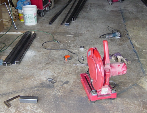

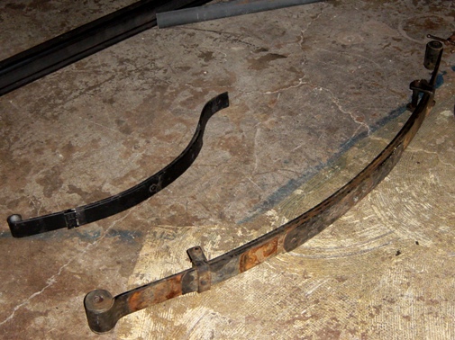

Been really busy so didn’t make a lot of progress over the last week. Started cutting and tacking together the frame. Using 2x2-1/8” square tubing and 3x2-1/8” for the tongue. I plan on using Jeep YJ springs, looks like removing a few leafs on a 5 leaf rear pack will be about right for my planned 1000-1100 GVW. Unfortunately it will be a week before my spring hangers get here.

Postby schaney » Wed May 13, 2009 12:45 pm
Here is a comparsion of the soft riding springs I'll be using and standard "HF" springs. When I stand on the YJ springs they deflect ~1". When I jump up and down on the HF springs they hardly move.

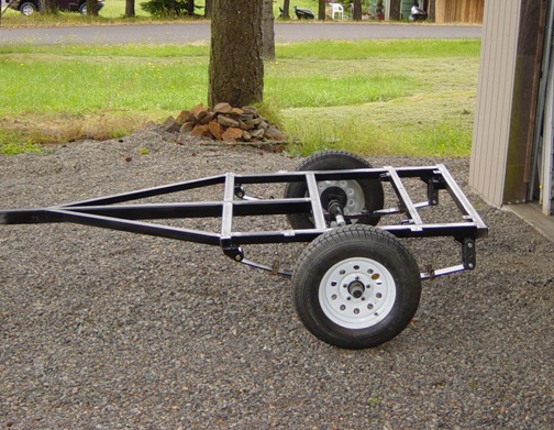

Making more progress, got the frame welded up yesterday. Just need to add a few brackets, trim the tongue and it will be ready to paint.

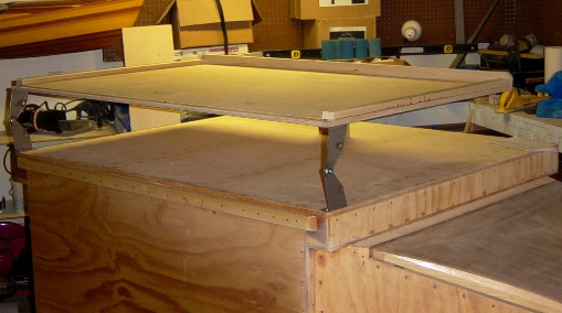

Made the hinged portion of the tent platform and test fitted it yesterday. The bed area is 4’-8” wide x 7’ long. There is a 1x2 strip on the side of the trailer box that forms a support for the platform on that side.

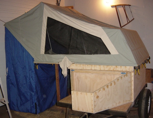

The tent I'll be using is one I designed specifically for Trailer Top usage without compromising it’s usability for Roof Top applications. In Rooftop applications you would need to build a full platfotm for it. Here is the production prototype, we are hoping to have it available this Summer

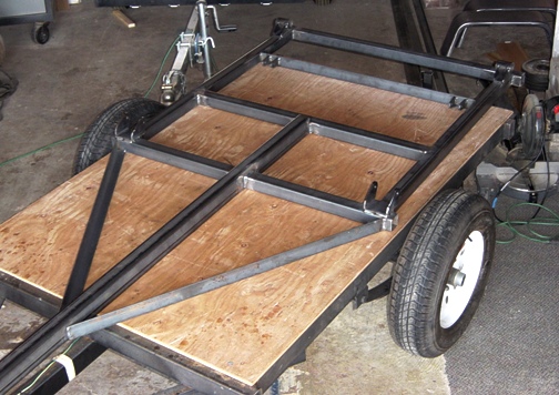

Now I can roll the frame around. Welded the mounting tabs and rear rack/stabilizer jack receiver tubes on, and bolted the axle under the frame.
