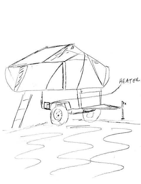

Maybe something like this:
It would probably be better to mount it above the water tank, which is is slated to site between the wheel wells. This would keep the space in back and front open for storage.

I haven't posted in a bit, and got ahead of myself there.
I've gone back and forth on design options. Meanwhile, I search Craigslist on a regular basis for parts. I've assembled a pretty good arsenal, and my wife is getting anxious for me to start doing something with them.
I priced the rooftop tents, and while they are pricey, you are high and dry, and the overall simplicity is hard to beat. My wife has suggested spending $1000 or so on a good canvas wall tent. Use the EXB as a hauler for it and the supplies. I got excited about that and started looking at hybrids, which combine a wall tent and bed on the top.
I like the idea of more space, but I also like the idea of permanent mattress off the ground.
If I went for a separate wall tent, I could easily run duct work from the heater into the wall tent without an issue, and it would avoid combustion or CO issues. Setup becomes a challenge.
My buddy had a nice wall tent we used for hunting years ago, and he had a nice portable wood stove. The downside was that it took up valuable floor space, made a lot of smoke, and we had to carry wood. Also an issue with all the fire restrictions these days.
I'd like to hear your thoughts.

Postby schaney » Sun Aug 21, 2011 8:30 pm
Hmmm, a big wall tent, IMHO too much work unless you plan on being there for a while. I maybe a little bias :D
On the heater front, a Heatsource HS200 by ProPex is a prefect size for a folding tent unit. They are available from a few sources in the US and easy to duct an inlet and outlet to the hinge flaps that many tent units have.
The Suburban units are way to many btu's of a small tent.
Scott
