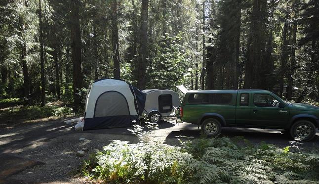

Postby tartosuc » Sun Nov 27, 2011 8:40 pm
i like that "dome" shelter in the last pic, what kind is it?
tartosuc
Posts: 53
Joined: Tue Oct 04, 2011 7:43 am
Postby Big Dan » Sun Nov 27, 2011 9:48 pm
Its a coleman event tent, 15x15. Its 12.ft tall in the center and the side arches are 8,ft tall
