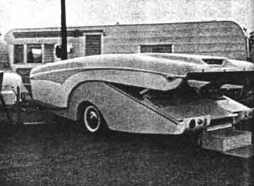

Postby aratman » Wed Jul 06, 2011 8:33 pm
Has anyone seen one of these or is there a build?

Postby doug hodder » Sun Jul 10, 2011 11:34 am
I haven't seen one of those, but do like the lines on it. Got a name for it? Doug

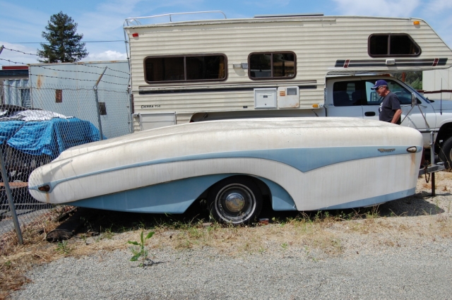

Postby Shadow98258 » Sun Feb 24, 2013 8:18 pm
Ok so that blog does not exist anymore. Any other info on this trailer? It looks awesome and reminds me of a 50's era Corvette. I would like to see it set up. Where were these pics taken?

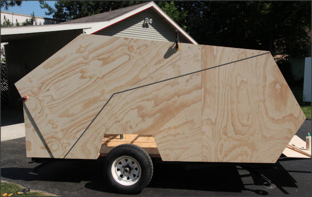

Should be able to emulate the lines with stick and ply construction. I did a search myself about a year ago when the wild goose profile was rambling around in my brain. Didnt come up with anything different than you did. Good Luck searching or building one!

Postby bgordon » Tue Mar 26, 2013 7:19 am

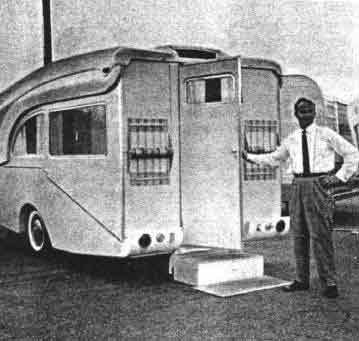

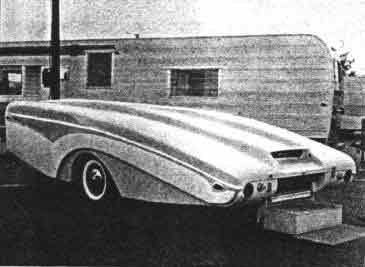

Hi,
It is called the "Odyssey". Was built in the late 1950's.
I have never seen the inside. I mailed the guy who's trailer that is (when the thread was still live), but he never opened the trailer up.
I have a few other photos of the trailer. I'll see if I can find it.....

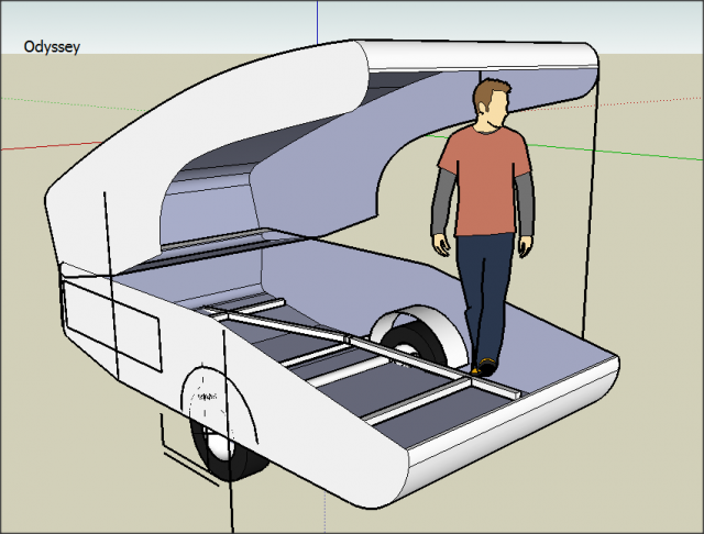

Re: anyone seen this?
Postby bgordon » Wed Mar 27, 2013 5:23 am
Hi,
By the way, I wanted to build something like this, but on a smaller scale. I crunched the numbers, and realized that this design will only work if the trailer is as long as the original Odyssey (about 16 feet, if my memory serves me right). I tried to adapt the trailer for a ten footer, but if the length is shortened to ten feet, the roof will not lift high enough for a person to stand in.
The second problem is packing space. In the original Odyssey this wouldn't have been a problem, since it is huge. If it is scaled down, packing space becomes a problem.
If someone can adapt this to a smaller dimension, it would be cool. However, as far as practical and small designs are concerned, I think Mike's Rockhopper is probably a better design.

Postby bgordon » Wed Mar 27, 2013 6:06 am
Hi,
Okay, here it is, as promised...
I even did a mockup of this on SketchUp... (In 2008).
Lastly, and probably most important: the patent number. 2,920,919. If you search the US Patent Office, you can see exactly how it worked...

Postby rmclarke » Wed Mar 27, 2013 10:18 pm
Barrie,
Thanks for posting those pics....I have been looking for that design for some time. I think a design something like that could work rather well made of foam (at least the top lifting part) and if the front was hinged a lot lower down, ample headroom could probably be created with a shorter overall length if the front profile was changed enough......off to the drawing board. :twisted:

Postby bgordon » Thu Mar 28, 2013 1:28 am
Hi,
I am glad I could help.
When you study the patent documents of the Odyssey, you will notice that the top of the trailer lifts at the back AND the front. . It does not simply hinge at the front, but lifts almost the entire height of the trailer. Doing something like this with a homebuild will certainly complicate the build considerably. That is why I believe that Mike's Rockhopper design is better suited to homebuilders. The front of the Rockhopper is much higher than the Odyssey, which allows for a simple hinge and not the more difficult pulley lifting mechanism (at the front).

Postby bgordon » Thu Mar 28, 2013 2:41 am
By the way, the SketchUp picture of the Odyssey (above) is where I tried to shorten it. In that picture the trailer was shortened to 12 feet, or 3.6m.
The Odyssey design might work as a homebuilt if the front profile is heightened (made higher). Doing that will essentially transform the Odyssey into Mike's Rockhopper. Personally I would have hinged the Rockhopper more to the front, which would have given more headroom.
I would have hinged the Rockhopper something like this (notice the grey line):
