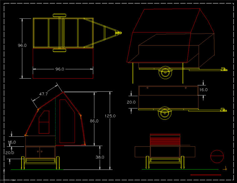

Postby boffingham » Wed Nov 23, 2011 2:45 pm
I have also posted an initial design to my photo album.

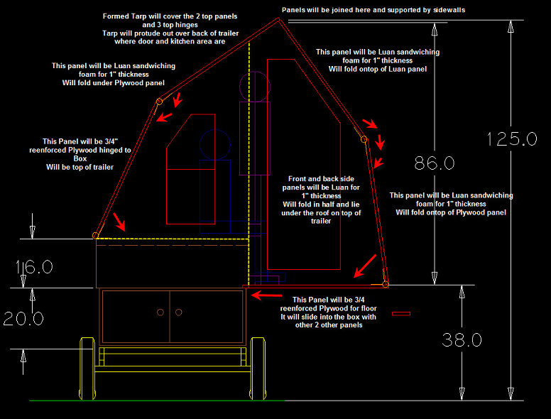

Postby boffingham » Thu Dec 01, 2011 1:06 pm
I have posted another pic with some descriptions.
Comments Welcome!

Postby angib » Thu Dec 01, 2011 2:16 pm
I think the critical thing here is not the overall design, but the detail design of each joint - there are some details that look impossible to me, but maybe you have some really clever ideas to make them work in almost no space.
Postby rmclarke » Thu Dec 01, 2011 4:26 pm
angib wrote:the critical thing here is....the detail design of each joint
+1.......but I like the idea a lot :)
