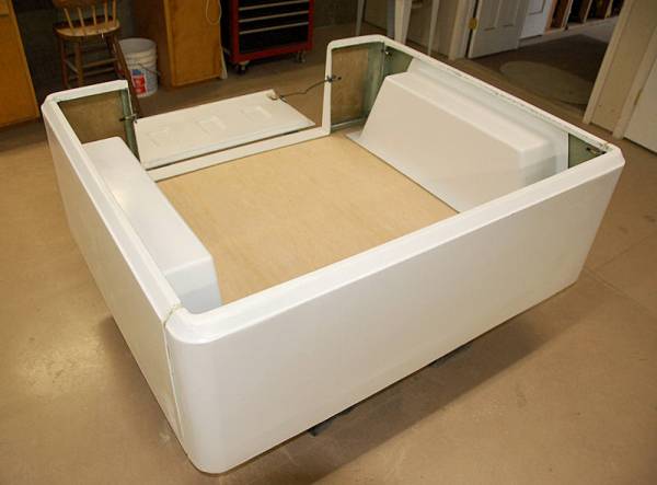

I have something new in the works, fiberglass bolt-together trailer kits. Ones created from a modular collection of components easily configured into a range of trailer tub and body options. For keeping cost down, they are designed to use reconfigured readily available bolt-together frame kits.
Part of the concept is being able to build it in increments and upgrade over time to spread out the cost. Get your frame built up and running first. Then add a tub kit and start just it. Next if you need it, add a tailgate and cover? After using some, maybe; bigger tires, a folding tent unit, slide out kitchen, front rack? If your needs change, just reconfigure it.
They have strong Jeep styling and are designed to use many off the shelf Jeep parts. For those with a Jeep looking for a trailer, they are a natural choose. With their compact size and light weight, they will also work great while looking good behind any vehicle.
The idea is there will be individual front, rear and side panels that you drill and bolt together. Once your tub is together you would attach it to a floor such as plywood or aluminum diamond plate.
My initial thinking is to first introduce an open tub Compact version around 4 1/2' long. Then an Extended version around 6 1/2' long. These would work as gear hauler or tent topped camper. If there is interest it will be easy to make a smaller version tub based on the 40x48 bolt-together frames for motorcycles or ATVs. Then stretching the tub to 7 1/2' or 8' and adding an upper section for building compact hardsided campers.
For the Compact tub version, the target price including your frame kit is around $1200. What do people think? Sound interesting? Any feedback?

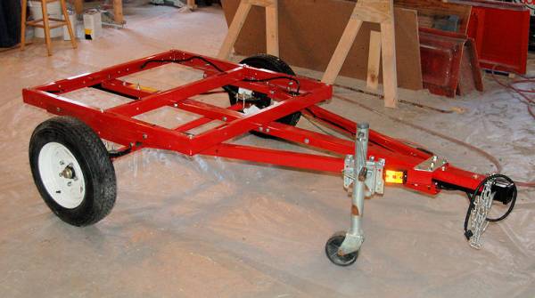

I was forced to use a HF frame for a trailer at work. I told my boss that it wasn't going to hold up to the use I needed. One of the welded trailers from Northern would have been better. He didn't listen...went cheap...then had the mechanics add a longer tongue, weld the 'bolt-together' frame...then they had to add more flat stock front to rear to keep it from falling apart...the tires lasted about a year...this trailer was used for hauling brush loads on a 140 acre campus. Not heavy, long time use.
My preference for tongue jacks is to have them on the driver's side. That way the driver, who is the most likely person to be hitching the trailer, doesn't have to go over the tongue or around the trailer.

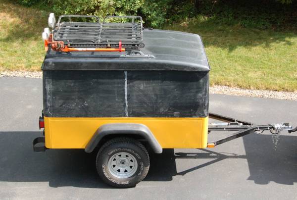

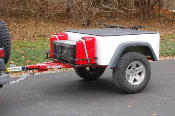

On my Explorer Boxes, I find around 4 1/2' the maximum length for easily reaching in to grab stuff. For a tub like this, would you build it without a tailgate and want to access gear from the top? If so, would you find a hinged hardtop or your tent unit elevated on a rack for a better solution?
Tom, bolt-together frame do have their limitations. Based on my experience and seeing many home-builder use them, the heavy duty HF model will be suitable for lighter duty usage. For heavier duty off-road service, we plan on offering an upgraded fully welded frame with high-end smooth riding springs, shocks and 3500 lb axle. Good point on the tongue jack.

schaney wrote:On my Explorer Boxes, I find around 4 1/2' the maximum length for easily reaching in to grab stuff. For a tub like this, would you build it without a tailgate and want to access gear from the top? If so, would you find a hinged hardtop or your tent unit elevated on a rack for a better solution?
I have one of these on my pickup and I love it:
BUT, they're expensive and too big. I've seen quite a few jeep trailers with DIY hard tops, seems like that would be nice.
That way you could have a pull out galley at the tailgate and flip the tent up for access to the inside of the trailer.

Bruce, Thanks for your additional thoughts. Already have a good soft tonneau option for them. Also looking into doing a hard cover possibly a revised revision of this one.

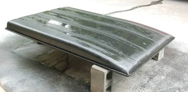

Mark, this top is 7'-5" long x 59" wide, it was initially designed as part of a Jeep Limited hardtop. The hardtop project is underway, should make it to market next year some time.
We are considering using the same design to make hardtops for the trailers tubs. Initial thought is these would be hinged on the front for opening.
Then we also plan on using the top as-is for the hard sided camper design being worked on.
