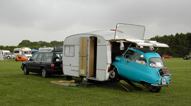

I started with a 24' rear bedroom camper that we just sort of stopped using, I have a Kawasaki Teryx and wanted to be able to haul it and camp (sold it before I ever had the chance).
Here is a before pic, the rear was mostly windows and it had an angle to it.
well after some head scratchin' I came up with a plan so I ripped the entire back off and cut it square.
I didn't realy take any pics as I was building the framework but it's simply 1 x 3 x 1/8" tubing lagged to the existing 2 x 2's of the camper.
The ramp was built out of 1 x 3 tubing also and insulated with 1" high R sheathing.
this pic shows what I did with the queen size bed.
trimmed the opening inside with diamond plate.
I dressed up the front and sides with some diamond plate too.
http://s49.photobucket.com/albums/f290/ ... ics212.jpg
I had to remove the bathroom to make enough room. I used indoor/outdoor carpet on the floor, the ramp and bed I painted with garage floor epoxy. I am going to have to do some searching to find some pics of it all finished. Enjoy,
