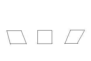

The galley wall adds a great deal of strength to keep the walls from racking. A pass thru is very dooable but you will need at least a partial wall to stiffen the body.
Think of the top. bottom and 2 side walls as a cardboard box without the end flaps folded. This is what the body will want to do ...
without a shear wall to stiffen things up.
Even a small 12 to 15 inch tall cabinet over your feet adds a great deal of strength if it is installed hammer fit tight.
