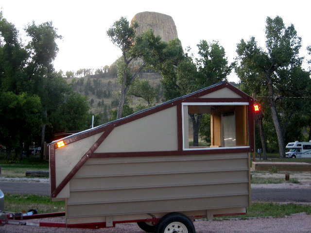

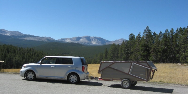

Crazy as it may seem, we decided to take the trailer as-is all the way from Virginia to Yellowstone and back through Montana and North Dakota. It was a wonderful trip which we will never forget. I put a few photos into the gallery.
Here is a short progress report on some of the previous discussion:

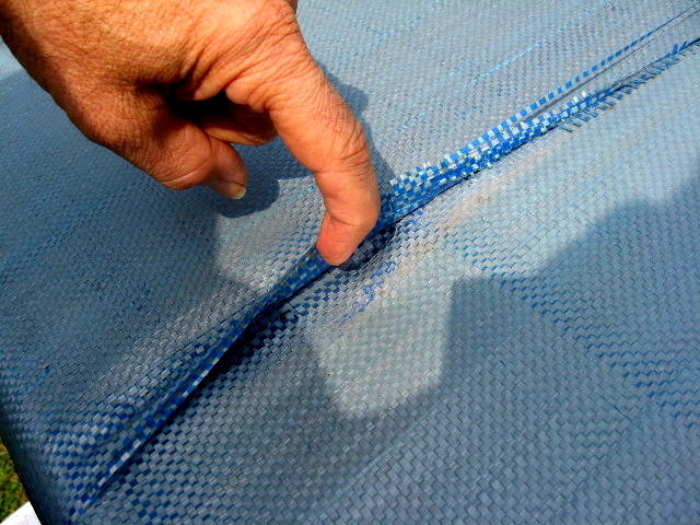

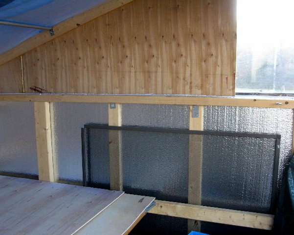

About the seal between tiers: My attempt at an indoor insect seal using a pie section of a pool noodle failed because I could not cut a slice as thin as the gap (which runs from nothing to about a quarter of an inch or so). However, we still did not have any real problem with insects. Even at Yellowstone where the mosquitoes were really dense (Canyon area), we had fewer in the camper than we did in the car. It just might be that mosquitoes don't crawl far and can't fly up a very narrow 4 inch vertical gap.
I also tried using a J-channel as a tire spray guard (driver side only). It worked well in the heavy rain we had through Ohio, but since I did not bother to paint it, it sticks out like a sore thumb, especially in the open configuration. Here it is in the closed ....
115522. I still intend to use an out-of-sight rubber seal between the tiers for any real build.
We had no trouble going up (or down) hills, not even over the Powder River Pass in Wyoming or those of I-68 in Western Maryland. All the work to keep the weight below 600 lbs paid off! Being able to see over the top of the trailer proved very valuable when backing into camp sites. The sight line down the center of the top was most helpful. I think the low closed profile (about 2/3 the height above the frame as a small 48" Tear Drop) was also helpful in managing drag, but a better aerodynamic shape would also help.
I never did quite master an easy way to 'make the bed'. When we camped with a pick up truck, we had access to both sides of the bed from the outside through two 54 inch long window doors (a bit like the bed access of a two door tear drop but at standing height). That made 'stretching the sheets' easy. Not so in small trailers or small tents! On the other hand, with the bed folded back, we had over half the total trailer foot print as 'open space' in front of a full width bench seat - much better than in our pickup.
I was going to try a foam roof, but figured it was safer to stick with the experimental tarp top (which proved as effective as the plywood top and a bit lighter) rather than leave on a 5300 mile trip with anything totally new. Just in case, I packed an extra roof (tarp) since it was light and it only takes a couple of hours to install. Although we had no trouble with wind or leaks, the tarp showed signs of surface deterioration by the end of the trip, especially near the seam. Some how I did not notice the tarp had a seam until it was almost fully installed. The metallic silver finish seems to slowly etch away leaving a white under surface (raw polypropylene?). I believe the erosion is etching or UV damage because the top does not flex or ripple even at highway speed. As of the end of the year (6+ months of constant outdoor exposure) the top still holds it's own against the rain, but I have to believe its only a matter of time.
Finally, one interesting and entertaining couple we met while camping told us we need to give this camper a name and then offered several very clever candidates that I will hold in reserve for when I do a real build. I selected the origin name "Tier Drop 50 Test Bed" because it was descriptive (upper tier drops over lower tier, a test platform to see if I could get satisfactory bed headroom in the open configuration while meeting my constraint to 'see-over-the-top' when closed, etc.). For now I have renamed it the "Tip Top Tier Drop".

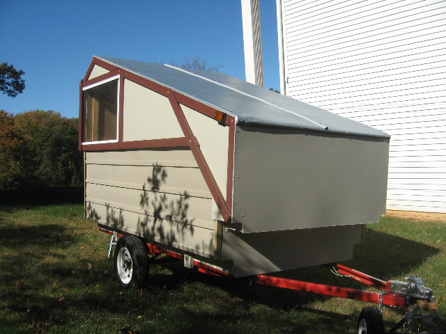

This spring I replace that roof (nine months of sun caused deterioration along the tarp seam).
Lacking the heart to disassemble the whole thing to try removing the warp, I decided just to live with the embarrassment of driving around a lopsided eyesore rather than miss any more camping. So I call this trailer the Tip Top Tier Drop -- Pisa Edition (in honor of the famous leaning tower).

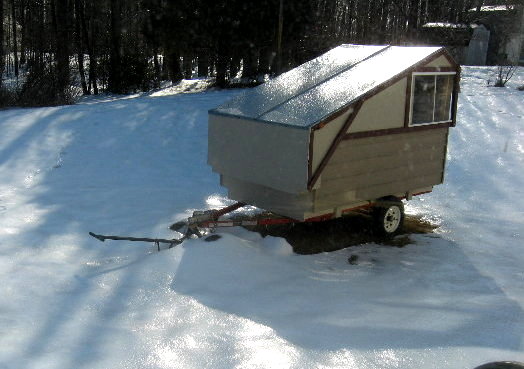

Despite my conviction to “change nothing” in order to save time, I could not resist the temptation to try a few modifications. I lowered the tail lights and reconfigured the framing to (slightly) increase the opened height (which led to more problems, but that’s another story). But the big change was to skin the base with foam and vinyl siding (which required adding braces) rather than plywood. I only cover (‘skin’) one side of the framing. On the original trailer the base used an internal frame while the top’s frame was external, leaving the two smooth skinned sides to slide upon each other. That worked really well, but I wanted to try vinyl and foam even knowing the tiers would not slide or seal as well (because of the margin left for the siding ridges). I only had a few lengths of scape vinyl, just enough for the bottom tier sides, not the front, back or top. Although, I used different types for the port and starboard sides, they are the same color.
Yeah, I know the common street wisdom: ‘vinyl siding will not tolerate highway travel’. This may be true for the staple gun installation used on pre-fab homes, but I used a lot more care and the top partially covers the base in the travel configuration, so I was confident it would not be a problem.
I used half inch thick white foam with foil on both sides, and to my surprise, the unprotected interior side has held up quite well so far. I really like the vinyl, but it does have its down side: Like the original, I can quickly open and close the trailer without help, but the uneven siding does make it more prone to snags while lifting and complicates sealing the tiers.
After a couple of short trips we took it out on a very long one. With a total of 22 nights and 5 thousand highway miles and the vinyl siding has been totally stable.
The inside bed width is a bit over 57 inches. When folded the top is only about 3 feet above the frame deck but when opened we have great head room right where we need it (68 inches at the peak between the foot of the bed and door). But, comparing this to a typical fixed geometry (4 foot wall teardrop), it’s about a foot lower when folded yet has about 20 inches more headroom, so for us the extra work of a pop top is well justified.
I have become quite fond of using a tarp top (light, cheap and effective but watch out for tarp seams). I did not install the center sighting strip on the middle of the roof and I really missed it while backing into sites. Without it the tarp top did bow slightly at highway speeds, but it did not stretch the top and it was no problem at all.
I still hate “making the bed” from the end even if I can stand up during the process. Also, access to things stored under the very front of the bed is limited to when the bed is folded forward, so you have to be sure to put anything you might need during the night under the foot of the bed.
