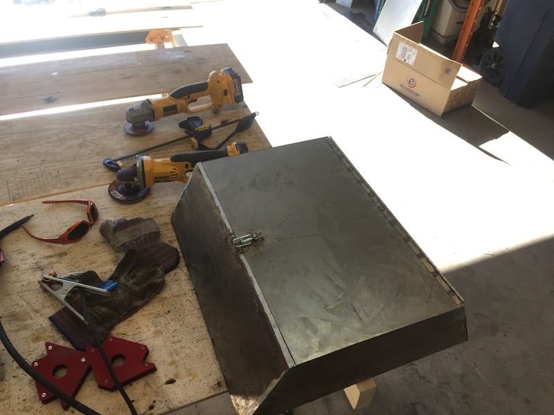

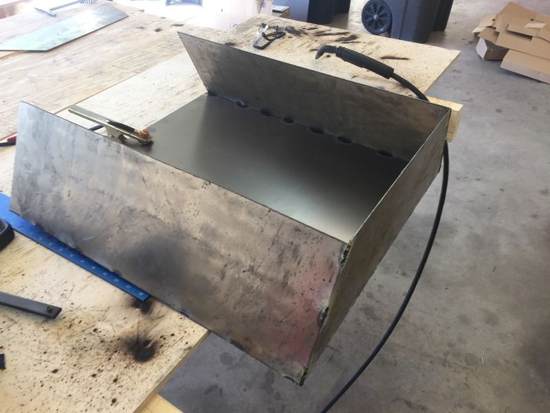

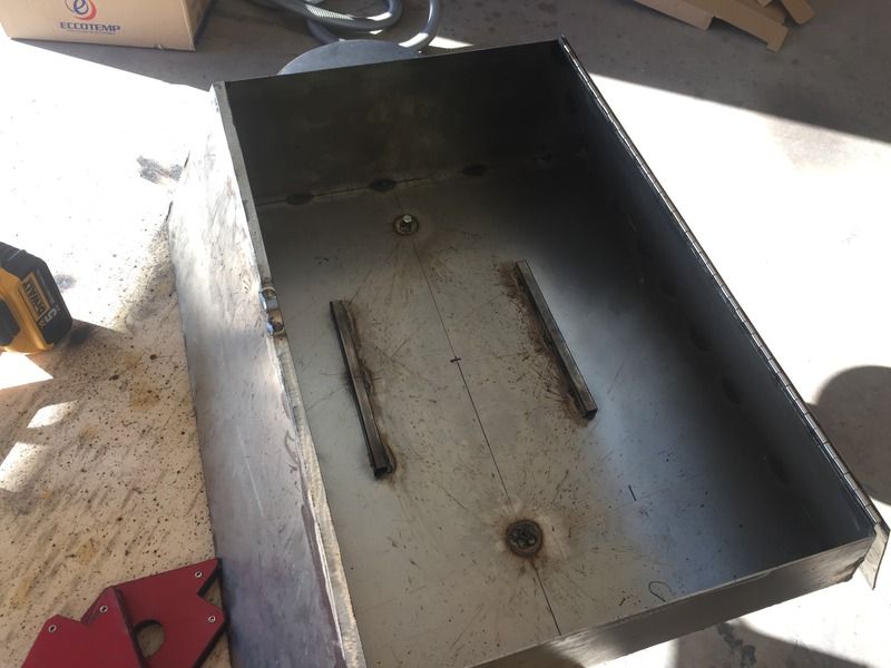

Built an exterior cabinet for a shower out of some 16 gauge steel. I didn't bother to make it waterproof because the shower continues to slowly leak water even after you drain it, so this way that water can escape.
The nuts are used to mount the shower and the steel bars keep it from rocking around in the cabinet:

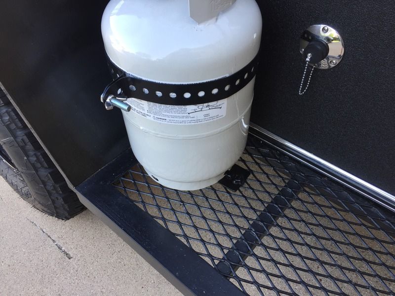

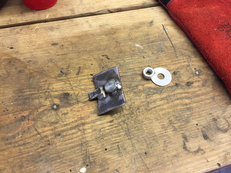

I also needed a propane tank mount but the ones I found for sale seemed ridiculously expensive for what they are. So I bent up some strap steel and made my own:
I also made a tab to hold down the bottom of the tank and keep it from bouncing around:

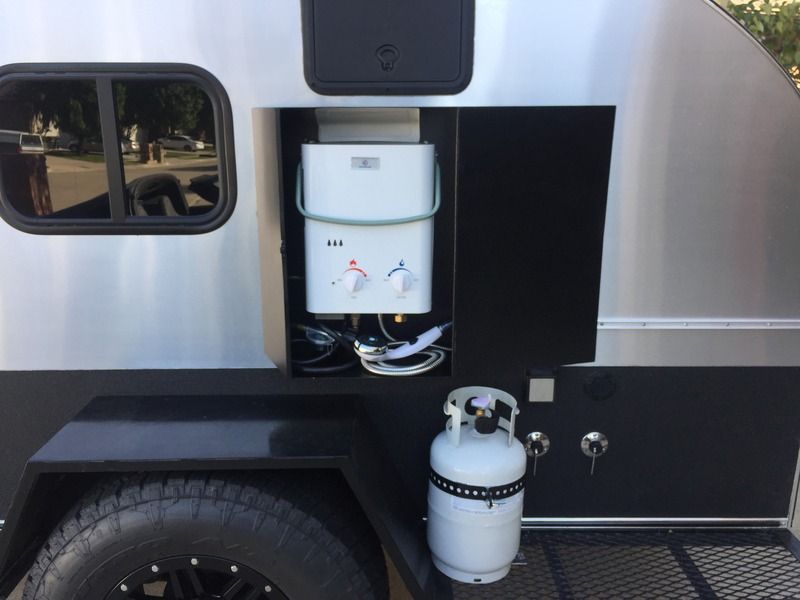

Tank and cabinet mounted. This side of BOB is getting a little busy, but I wanted the hose outlet close to the shower and I have plans for the other side of BOB still:
And a closeup of the tank mounting:
