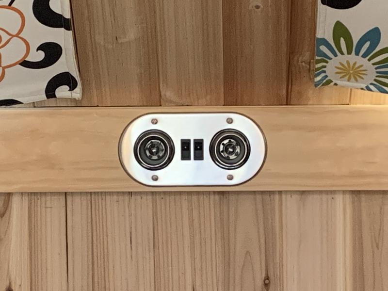

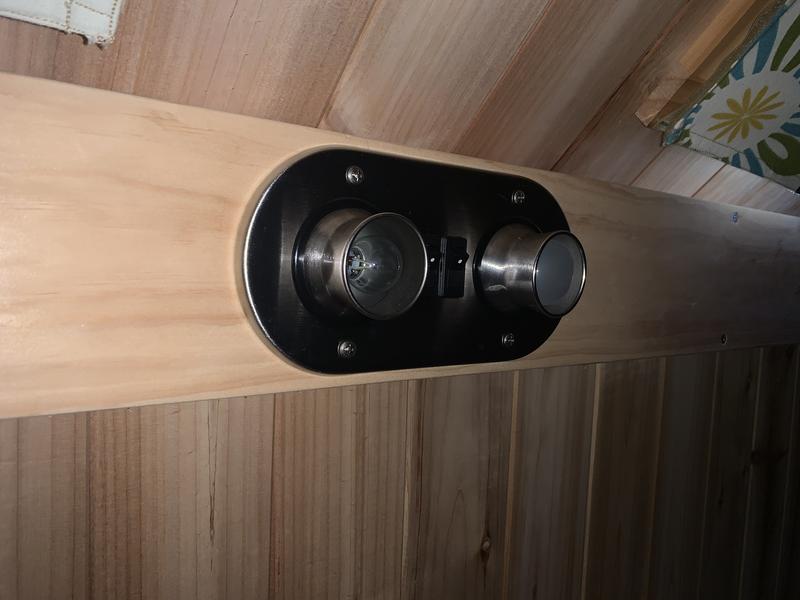

Lighting upgrade: reading lights.
New vs. Old. The LED light on the left came from a company called Oz-USA.
What they look like installed. New on left, old on right.
The color is a bit bluer for the new bulb, redder for the old. The brightness is comparable.
Both new bulbs installed. I lose the frosty look of the old bulbs, but...
The amp draw with both reading lights on doesn’t even register now. Prior to changing them out, the old bulbs drew an amp apiece and became extremely hot when in use.

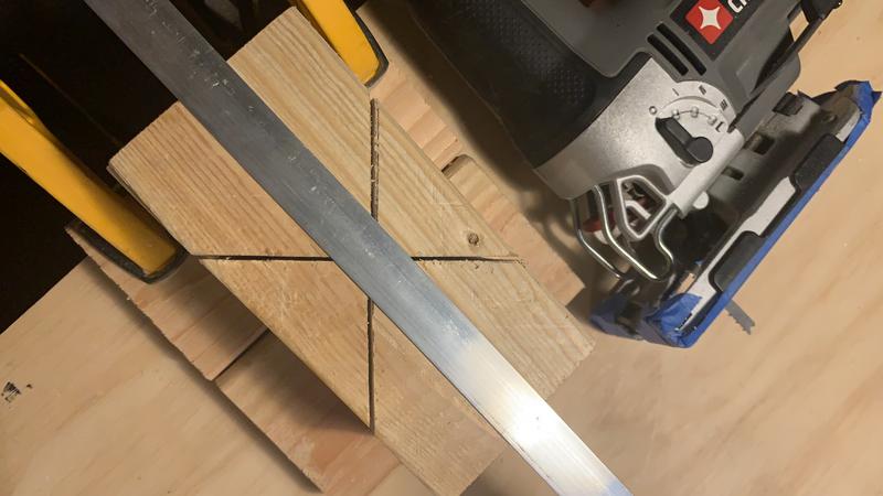

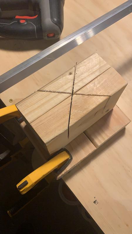

One thing holding me up was difficulty cutting precise 45° angles on my aluminum trim for the corners. Before we moved 2 years ago, I borrowed my neighbor’s mitre box and hack sawed trim pieces by hand. I really wasn’t looking forward to that job again, so I made a jig to hold the trim while I could cut it with a jig saw.
The jig is made out of some spare pieces of 2x4’s and some deck screws. It functions like a vise to hold the trim by squeezing it, and the tightness can be adjusted by the screws. I also use a clamp to hold down the trim as a secondary safety measure, because I don’t want pieces of it flying across the room or into me while sawing. Eye protection while cutting anything is a good idea, but is an absolute must when cutting metal.
I cut my first length of T-molding tonight after supper and it works! The cutting process is pretty loud though and I figured I’d hold off doing the rest until the neighbor’s young kids aren’t sleeping. It’s super easy to do, which makes me more motivated to finish this part of the build. There are outside-facing T moldings and inside-facing L-moldings on these doors. Lots of cutting to go, which is why I didn’t want to hand-cut them.

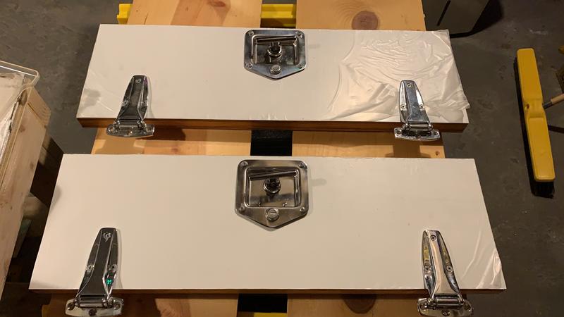

Made a little more progress today. I cut all the T-moldings to shape, then drilled and installed them temporarily. Everything will come apart later and get Sikaflexed before it becomes permanent.
The 45° Jig works great.
These are the L-molding and T-molding strips that go on the doors.
Test fitting the T-moldings. They look identical but they’re not. Each is slightly different because the doors are not quite perfectly rectangular.
Drilled, countersunk, and screwed in place.
I filed down the corners and sharp edges. Don’t want anyone getting lacerated or impaled.
L-molding sitting in place. This will be another day’s work.
