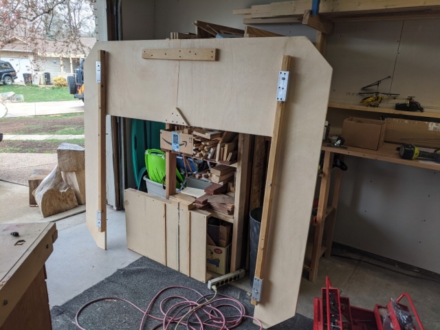

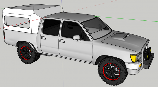

Here's a pic of the basic design. It's been modified slightly since then. I made the leading edge of the top extend a few inches higher/back, and then it will slope down from there. Limit is what will fit in my garage, but my wife asked about more headroom.... perhaps the slope down will also add a bit of aerodynamics. (But I'll probably never know!) All the edges have 45 degree angles. The theory there is that it will add more rigidity (The inspiration for that is the Kimbo camper.) Also, it may help aerodynamics a bit as well.
I'm a newbie to composites. I've been reading furiously for 3 years, and a year ago I did my first layup, coating a wooden keyboard road case with fiberglass. That went well, and now I'm ready to try something more ambitious. Hoping to complete this in the next month or so, by the time the snow melts in the high country. We'll see....
More coming right up, but want to make sure this is all working, as it's my first post!

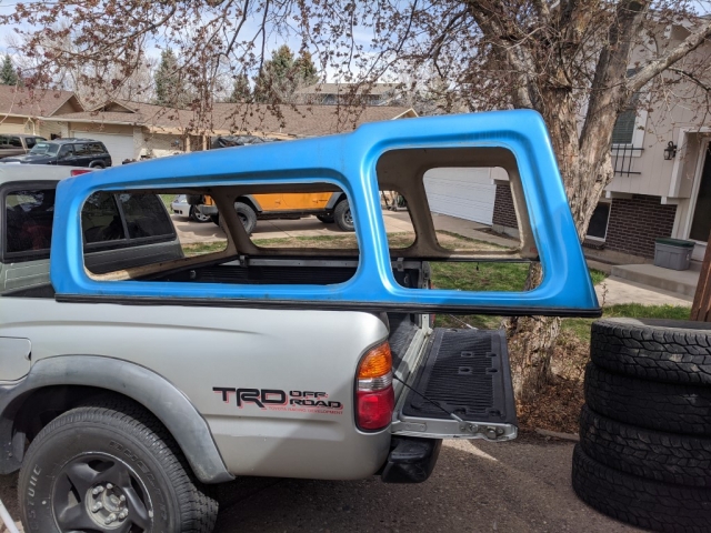

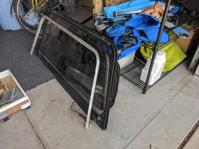

First thing I needed was doors and windows. I found a topper for an old s-10 pickup cheap on craigslist. Missing one window screen, but otherwise excellent condition. I needed smaller windows than usual, because of my short bed length. I also wanted a larger than usual back hatch, this had both:
Ended up with all the windows I need, plus two more I could use for some future project:

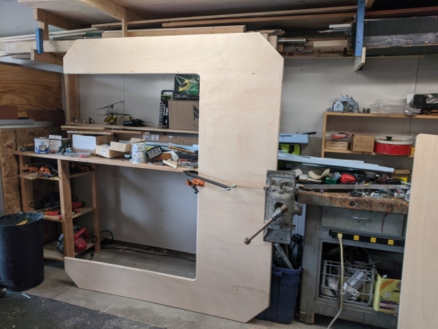

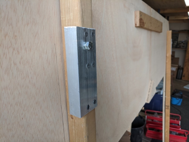

Next thing was to cut the plywood floor. I used sanded 3/4" from home despot. The boards attaching the two sides will go away when it gets glassed. This has become my work table in the meantime:
I used threaded wood inserts and 5/16 bolts to attach 2x2s to the floor. Then I attached aluminum angle to those. This will attach the shell to the bed, and also provide a ledge for a (re)movable sleeping surface, made from what was left of this sheet:
Next up, foam....

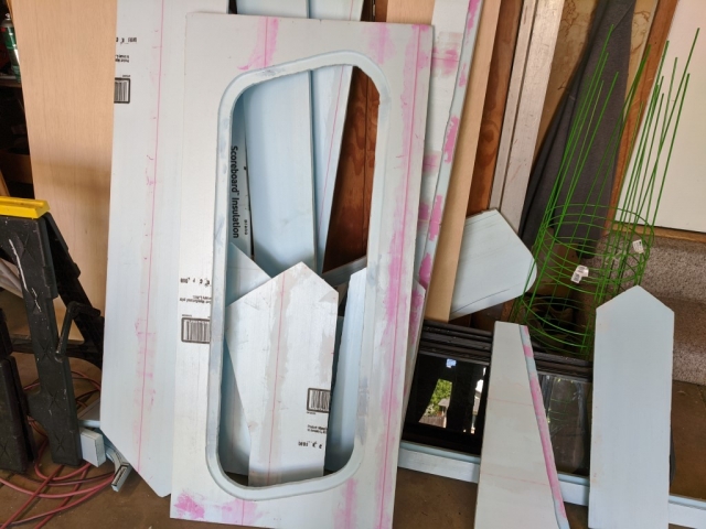

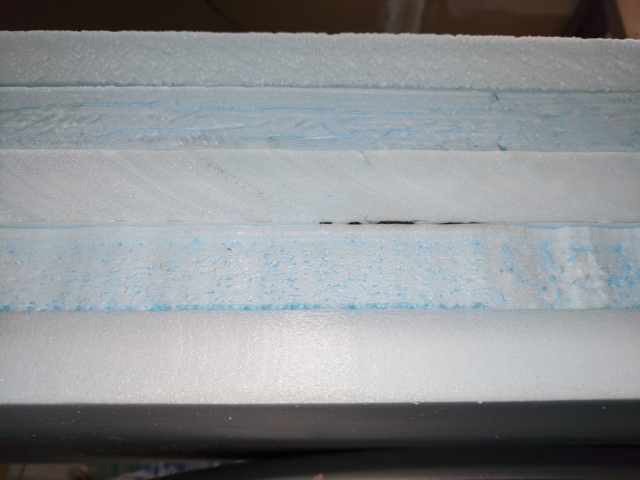

For the foam cutting, I used sketchup to lay out the pieces:

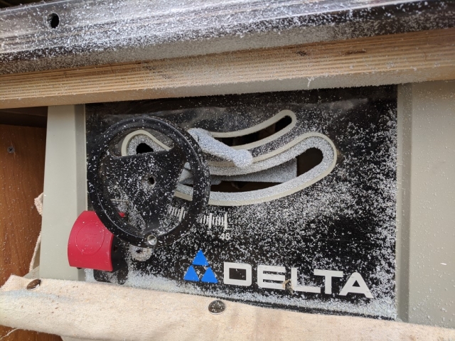

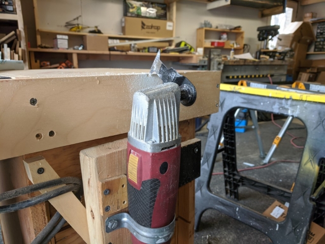

Then I started cutting them out. First, I tried the table saw. But that created huge clouds of dust!
I'd read about diy dust collection methods here on the forum, but I wanted to figure out how to just NOT create dust. I'd rather not contribute so actively to the micro-plastics problem! So next thing I tried was mounting my old corded multi-tool:
That cut down on the dust by half. But the blade was scraping away at the bottom of the foam, because of the angle. So I hit on the idea of sharpening the SIDE of the blade, and pointing it straight up. That created no dust at all, but it basically cut by melting the foam via friction, which didn't give a very smooth cut. I then tried using a router, but that was impossible to control, and created 4x the dust of the table saw. ABORT!

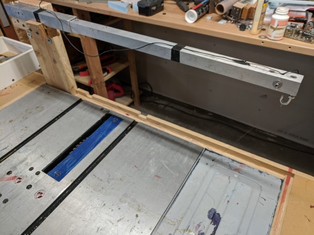

Finally, I remembered about hot wire cutters. Read/youtubed up on it a bit, and built a prototype. That was the best cut by far, so I built a proper adjustable unit that fits on my tablesaw. The wire's a little thin, so it gets really hot, but it makes cutting very fast. No room for hesitation though!
:frightened:
I also have my common angles sharpied on the box-tube, so it sets up really quick between cuts. And I can use the fence on either side for straight cuts.
Here's a pic of all the different cutting methods. From top to bottom, factory edge, multi-tool edge sharpened, table saw, router, hot wire:
As you can see, it's the hotwire that looks like a factory cut. As long as my nerves remain perfectly steeled!

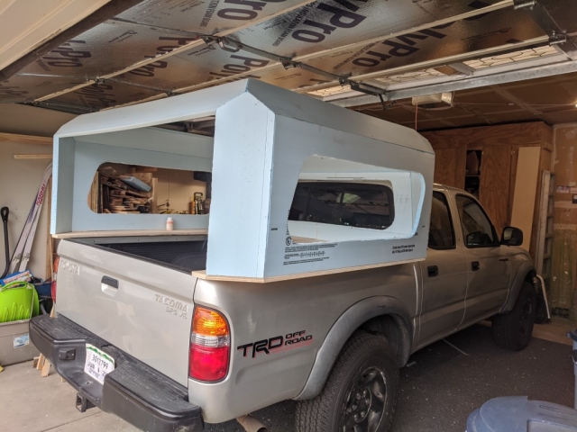

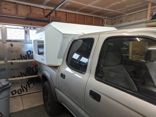

With everything cut out, it was time for a mockup...

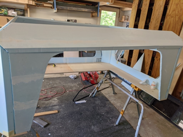

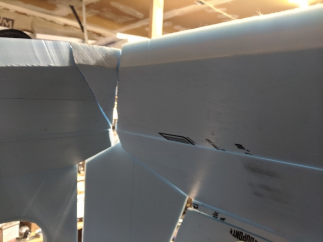

Hit on the idea of using wire nails to test fit the pieces. Hadn't seen that here, but I imagine somebody's done it. Here are front and rear views. There are lots of gaps, but I'm planning to use great stuff to glue these together, and put packing tape supported by masking tape to 'clamp' it, and also keep it from spilling out the best I can. I imagine I won't be able to completely hold it, so my thought is to let it spill IN, and use packing tape to simplify cleanup there, as in the xpsStream build.
Thoughts on the likelyhood of this working???
I'd love to find a glue that would cut with the hot wire, but I imagine I'll have to round everything by sanding. Haven't tried cutting great stuff that way, though...
The bigger gaps are there because I had to change the position of the front window slightly to match the cab window better. I've since recut that front wall to match the new profile. I also changed the roof design at this point. That's what the little v-shaped piece is in there for. I'll revisit the roof after I glue the walls together:
In the pic, the front edge is to the right. The original roof line was at the midpoint of the picture. I decided to raise it, and then have the roof taper down to the rear (left in the picture.) Since then, it occured to me to check whether it would fit in the garage with the higher roof. Glad I checked, as I've ended up splitting the difference. Would have been molto annoying to find out it was two inches too high. Especially if I banged up the topper in the process!!! Whew!
Wait, where's the 'wipes forehead' emoji?????
Well, anyway, it's looking like there will be a good bit of improvising once we get to the roofline....
Now it's time to take it apart and deal with the window openings. By reversing the mounting brackets I can get the window mounting max depth on these topper windows up from 1/4"-ish to 3/4". BUT my foam is all 1". So time to deal with that.

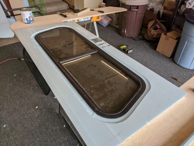

I needed to recess the windows into the foam a bit, since I can't mount them on a 1" wall. The first thing I tried was a $20 hot knife from amazon, the kind that looks like a sodering iron. That worked. Really badly. The blade gets too hot where it joins the handle, and not hot enough out at the tip. You could probably cut 1/4" foam with it, but it's no use for cuts this deep.

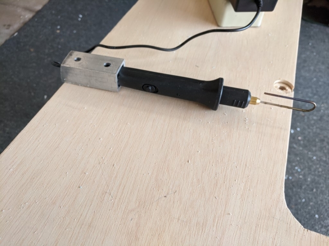

Take 2. I tried one of these, cheap chinese foam cutter, $27:
It has a straight long tip, and also a fork attachment with a wire strung between the forks. But this strange tip worked well for what I needed. Viola! Window recesses:
They were pretty good, but there were some issues that required some kind of filler.

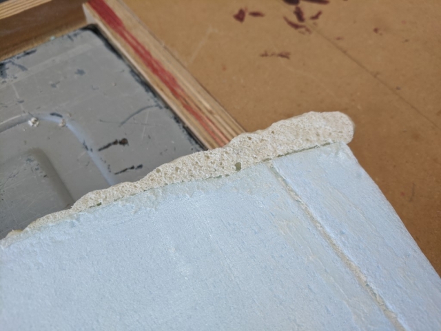

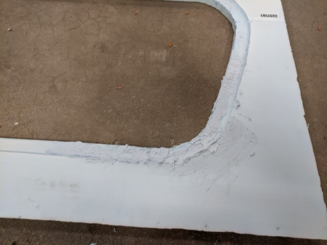

What followed after this was a comedy of errors. First, I had bought some PL300 foam adhesive. I tried filling gaps with that. Although I had read somewhere that this stuff sanded like foam, I found that to not be true at all. It sands horribly. Here's where I tried to fix a nasty area from the first hot knife fiasco. This goopyness was impossible to sand down. It started coming loose, and I pulled it all out:

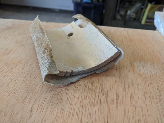

Next I read in a boat-building forum that dap spackle adheres fairly well to foam, and is easy to sand. So I tried using that:
But as I was sanding it back, two things occurred to me. First, I can't imagine that the epoxy/spackle bond is going to have much resistance to delamination. Second, those lovely sharp recessed curves are nothing that fiberglass cloth is going to want to go around. So I needed to sand back the edges big-time.
So first I took the panels out to the backyard and hosed off all the spackle. Then I made a crude rounded sanding block out of a piece of 5" diameter pvc and started sanding back:
Although this was slow, and created a lot of dust (I spent more time vacuuming than sanding, just to be able to see what I was doing) it ended up sanding out most of the problem areas caused by the hot knife cutting. What I'm left with now is mostly pretty good, except for a few bad gouges.

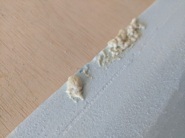

Now for the gouges, I found a suggestion of mixing spackle with Gorilla glue. So I tried a test of a tiny bit of it. It expands like crazy, but it sticks really well, and it sands well too:
It looks pretty porous, so I'm thinking it might absorb a lot of epoxy, but at least that should make it adhere well.
So I mixed up a larger batch to do some filling. OOPS! Very exothermic reaction, and it set up before I could use a fraction of it. So I think I'm going to have to mix up TINY batches of this. Like enough glue to cover the bottom of a paper cup, and a 1/2 teaspoon of spackle. I did get a few things (over)filled:

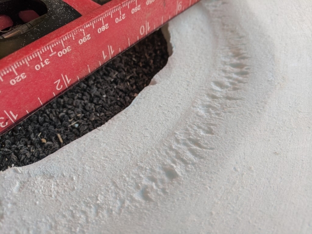

Which brings us up to the present. My current question is this. When I've been sanding around the corners of the window recesses, the foam has been pulling out like this:
Who knew foam had so much grain?? but it really pulls apart around these curves.
Bearing in mind I will be doing surfboard-style hand layup of fiberglass here, should I be worrying about imperfections this size? The gorilla spackle works, but it expands so much there's still a lot of sanding left. And maybe these ripples will just help adhesion? I'm not nearly experienced enough to know.
And, even if these dips would show up in the FG surface, would it be easier to fair them after I apply the glass? (I'm hoping to get a weigh-in from some of the folks who have been around this block a few hundred times.... but otherwise, I'll go find the appropriate question forum and post there...)
A couple of other questions:
I have ordered 7.5 oz fiberglass fabric and Raka epoxy. I'm hoping to make do with a single layer inside and out, but could buy more and do another layer. Thoughts on the sturdyness of the resulting structure? I have also ordered some carbon fiber cloth. I read somewhere that it was actually more resistant to deflection than FG, and I thought of putting it on the roof, and the forward facing surfaces (instead of, not in addition to, the FG.) Anyone care to weigh in on that? It's not too late to change course at all...
My plan is to assemble first and then FG, since it's not just a panel with four sides. So I will have the issue of glassing a vertical surface. Any suggestions you can offer about working that way would be very welcome. I'm not sure whether to put a layer of resin on before putting the cloth on, and I'm also not sure whether it should be allowed to cure inbetween.... I've heard various things there. I am planning on building a tool to poke a bunch of wire nail holes all over it, to get better adhesion. I will also sand all the edges to be more rounded (and bullnose the bottom edge of the plywood with my router.)
Also, I've been trying to find some details about layup around windows. Wondering if I should just cut the FG off at the edge on the inside and outside, leaving open foam on the cutout edge, where it will be behind the window frames. Or should I try to get the FG to adhere to that inner edge by folding it around from the outside to the inside? And if so, should I round that edge too?
And of course, any other thoughts on the process would be most welcome. Thanks for reading this far!

Also got pretty far into another test assembly. The original design had the cab window too high, and in moving it down, things didn't fit right. So I redid the pieces here, and cut them to fit. There's no CAD theory or detail under this. It's all Foamprovisation now!
The rear door also had to be reconsidered, as I shortened the topper one inch. The original design called for a foam door I would make myself. But then I found a taller door, and never adjusted the CAD to match. So more Foamprov here:
If you look, you can see that the front edge is not at all parallel with the back part. You can see some of it sticking up on the left. I saw that too, and got unnerved. Then I checked everything for level, and the near corner was an inch and a half low. Not a very flat garage floor, I guess! Looks much more even now.
Long foam-free weekend coming up. So I'll resume on Tuesday or so and try to get the roof figured out.
