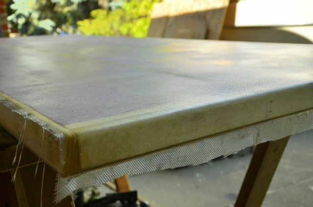

Postby OP827 » Thu Aug 13, 2015 1:41 am
THanks Bluebunny for kind words, that is the plan at least.
Covered first panel outside surface with epoxy and 6oz fibeglass cloth this evening. Quite happy with the quality glassing outcome.
Was a very easy job by having the panel in horizontal position. I plan to cover all panels first and then assemble the walls and then cover panel seams with FG tape.

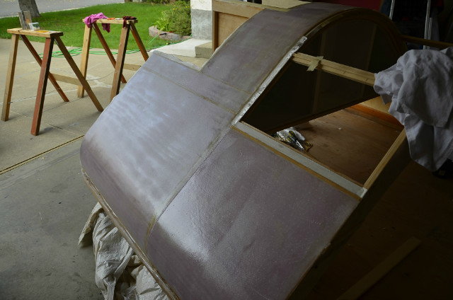

Postby OP827 » Thu Aug 13, 2015 10:48 pm
Thanks Mike and KC for your support, it means a lot to me. Yes it is big because that was what my family members wanted. Yet the walls and front I can lift either with one or two hands, so I hope it will be light when it is done, the pine stock I am using is surprisingly very light too. So I made some more progress today, finished glassing wheel wells and more importantly flipped the front part and fibeglassed the whole thing and it was again an easy job having gravity on my side. I first faired the surface with epoxy and microballs mix to fix all holes and dings and while it was still wet I cut the FG cloth and started glassing. it went very well, just a little tired by the end of the day today. Thanks for reading. :beer:
I think I have to add a second layer of FB in the front area where the road chips may hit, what do you all think?
135189135188135187

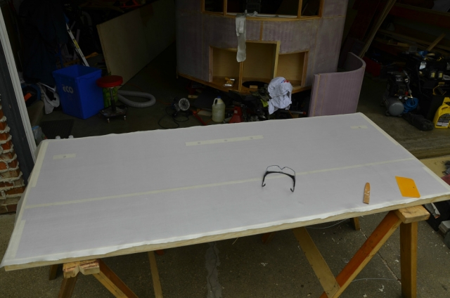

So today I finished the back wall lamination and there are some pictures with more detail how it was done since I did not describe that before.
The panel was sanded, some small penetration holes done to improve on lamination strength (see more on it below) and cleaned, fiberglass cut to size and layed down on the panel:
I mixed epoxy in two big batches of a full cup to speed up the process as there is no need for epoxy to be in a pot, so no risk of it going off, i.e. once it is mixed for 1-1.5 minutes, I just poored the epoxy down on the cloth and used polyurethane spreader to distribute the epoxy. The whole process of pooring epoxy probably took about 10-15 minutes and rest of about an hour maybe was for squeezing it down and working details on the edges and around wiring holes. Wires were just hidden inside the holes in form of spiral to not interfere with the lamination. I now had a good feel for how much epoxy I'll need to finish off the panel since I already laminated all other panels, so this time it took these two big batches. Here is the finished laminated panel waiting for epoxy to set, It will take about 5 hours and then I can take a utility knife and clean the edges, so that will be done later this afternoon.

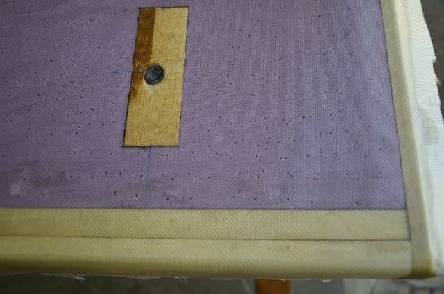

Here is a cloesup of the panel edge. Since it is a back panel the vertical edge was rounded with a router bit, fiberglass is laying well with this radius. Surface overall is pretty good and true. only a finish fill of epoxy either with squeege or roller will be needed before the paint. Almost no sanding is required, just knock off the whatever is pocking out a little bit.

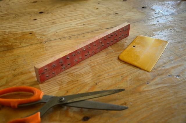

Another closeup to show these small penetration holes I did to mitigate delamination issues some people are reporting on their builds. The holes are about 1/8-1/4" deep and made with a simple tool.
And there are some tools used for the process. Polyurethane squeege/spreader, scissors, and the penetration tool. The penetration tool is made of scrap wood strip, I shot some brad nails through it. I just press this tool against the foam panel and move a bit and then press again to make the holes pattern you see above. It takes a few minutes to make all the holes in the panel, I just did not want to order and wait for the wallpaper removal roller that others are using on this forum and this little tool worked for me so I continued using it.

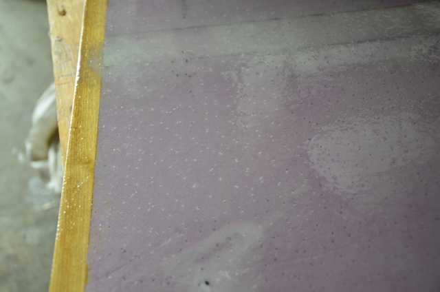

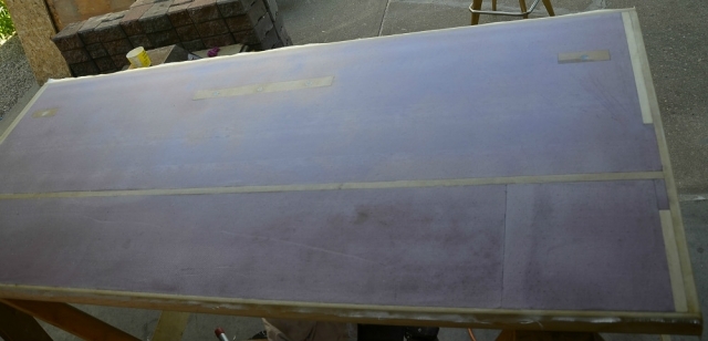

Postby OP827 » Thu Aug 20, 2015 9:32 pm
I ran into some minor issue with lamination of last back wall panel since I tried to do it faster than others. The tiny holes from penetration tool were usually first filled with either epoxy or epoxy and microballs mix before the FG cloth and everything was ok with these tiny holes, no issues - see the first photo below.
Last panel I did not do that, I just made these penetration holes and dropped the cloth and started laminating and then after some time, in a few spots were the epoxy was not poured excesively on the cloth, these little whitish areas appeared under the cloth - see second photo.
It is most likely because the epoxy went down these little holes and left cloth above starved without epoxy.
To fix this, I will sand the panel and impregnate cloth with epoxy once again, not a big isssue, but since I described the last panel method lamination in the previous post, I wanted to mention it here so that you, the reader would know and aware of it. Other than that, everything is good. 8)
