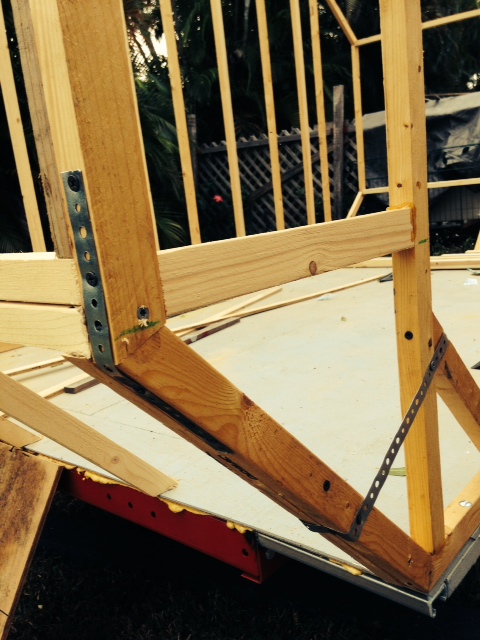

Postby Gold5one » Sun Dec 21, 2014 5:47 pm
I decided to reinforce all the corners with plumber's strap today. I want bolt some electrical superstrut on the bottom of the outside frame rails for a 18" x 48" rear bumper rack, so I can bolt down a lightweight storage box or two.

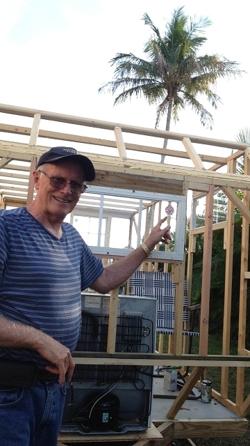

Postby Gold5one » Thu Dec 25, 2014 5:20 pm
Day 41
Thanks chrisz, I hope this all works out- I am changing stuff almost on a daily basis- I set up my chair and figured out the height of my counter across the front end, with the refrigerator in the center. I wanted the ability to set up two Ham radio operating stations for Field Day in June, but I thought about that blank wall and didn't think I would like it after a few hours of operating my Ham radio- having a window would open everything up visually. So I took the extra window and framed it in at the correct height. I then realized that I will be able to see all the way through the camper from the rear view mirror- great! That might prevent me from backing into a bull moose someday--hehe :)
I worked 5 hours today- with two hours out of the day to meet friends from synagogue for our annual Dec-25 lunch at the Chinese buffet.
My windows are all Made in the USA, which was hard to do and stay within my retiree budget. I'm putting a piece of Lexan over this front window to prevent a rock from breaking it.
If anyone wants some free coconuts, you are welcome to climb that 60ft palm tree in the background.
Coconut trees do not grow if there are freezing temperatures and Cape Coral seems to be the beginning of coconut palms in SW Florida. It was 75 today.

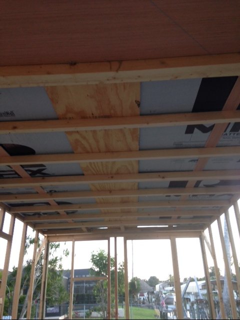

Postby Gold5one » Mon Dec 29, 2014 7:31 pm
Day 45-
I got about 4 hours in today-- three days of family commitments had priority this weekend. I worked out how I am doing my roof and got started- foam board is down and sloped for the luan plywood covering, that goes on after the sides are done. I am keeping the roof light, so the camper won't be top heavy.
I am almost ready to purchase the materials to finish the plywood sides, just as soon as I decide on the color scheme for the stain- decisions, decisions. My wife noticed the refrigerator, and the roof today-Well, she says it looks I'm building a "conestoga wagon"- (spell ck doesn't know what that word is), and she would be right, if I had a good team of mules to pull it.

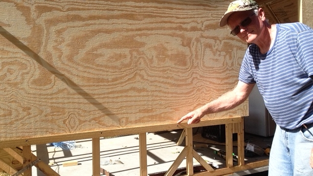

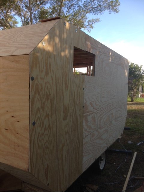

Postby Gold5one » Sun Jan 04, 2015 12:43 pm
Day 51,
Lunch break- 82 degrees in the shade
One of the reasons it's slow going, is I am sealing all edges and rear knots.
I used a temporary ledger board help install the side wall plywood- makes it an easy job for one guy.
Thanks to Mr Sun, I finally have a picture showing the narrower front of my build- almost 3" narrower than the rear. Has anyone else done this? Does it lower drag? Will my MPG be higher? I am hoping for 20mpg.
Back to work- 8)

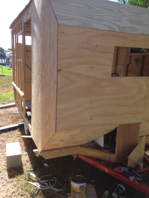

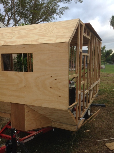

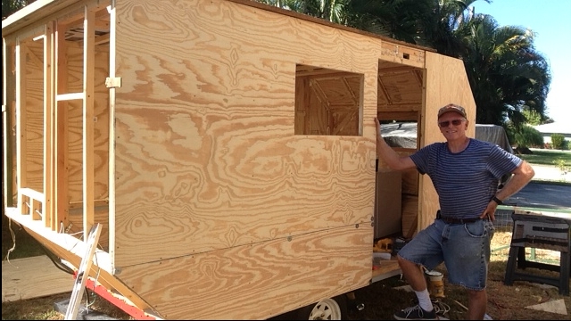

Postby Gold5one » Sun Jan 04, 2015 3:31 pm
Whew! Am I happy the outside plywood is almost done! I'm ripping the pieces for the bottom in the back and above the door, then I' done for today. I used 7 sheets of 3/8" plywood (minus window cutouts and scrap) for the outside and two sheets of 1/2" for the floor, 2 sheets of 5mm luan for the roof plus my studding and rafters.
How much does that weight? :thinking:

Postby KCStudly » Sun Jan 04, 2015 5:32 pm
Gold5one wrote:How much does that weight?
More. It weighs more than less would. :NC :frightened: :FNP
You are building bigger than a typical TD, too, so I guess a little heavier is to be expected, but I think you could have gone much lighter in many places and still been more than good. Since you asked.
What type of construction adhesive are you using?
Posts: 9616
Re: Mark's Weekender2 XL build

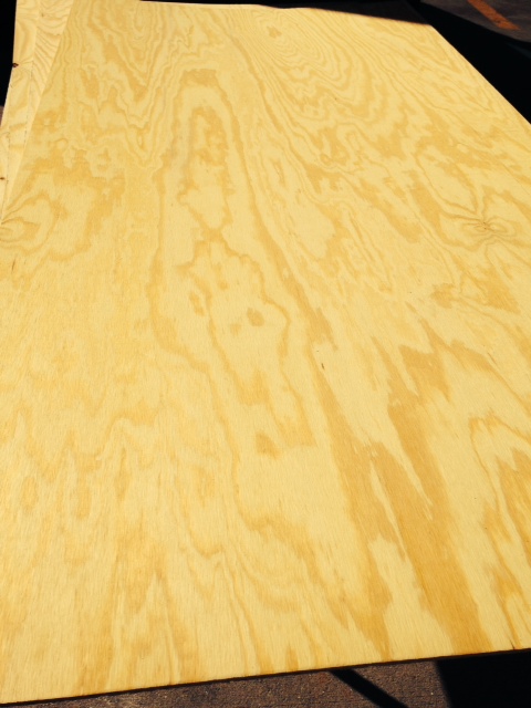

Postby Gold5one » Sun Jan 04, 2015 8:25 pm
I'm using pro advantage- a Lowes liquid nails knockoff
I weighted the plywood before I started= 33lbs a sheet (it's pine). Looks like I gained about 70lbs by using it. However, I saved 33% in weight by making my own studs instead of buying 2x2's ( and money too). Just couldn't find decent 1/4" BCX- it was all crap compared to what I used on my Shantyboat 3 yrs ago. I got A grade veneer for C prices, so I couldn't pass that up. Luan was out for the exterior, it won't last 10 years, which is how long I plan to use my MMC.
